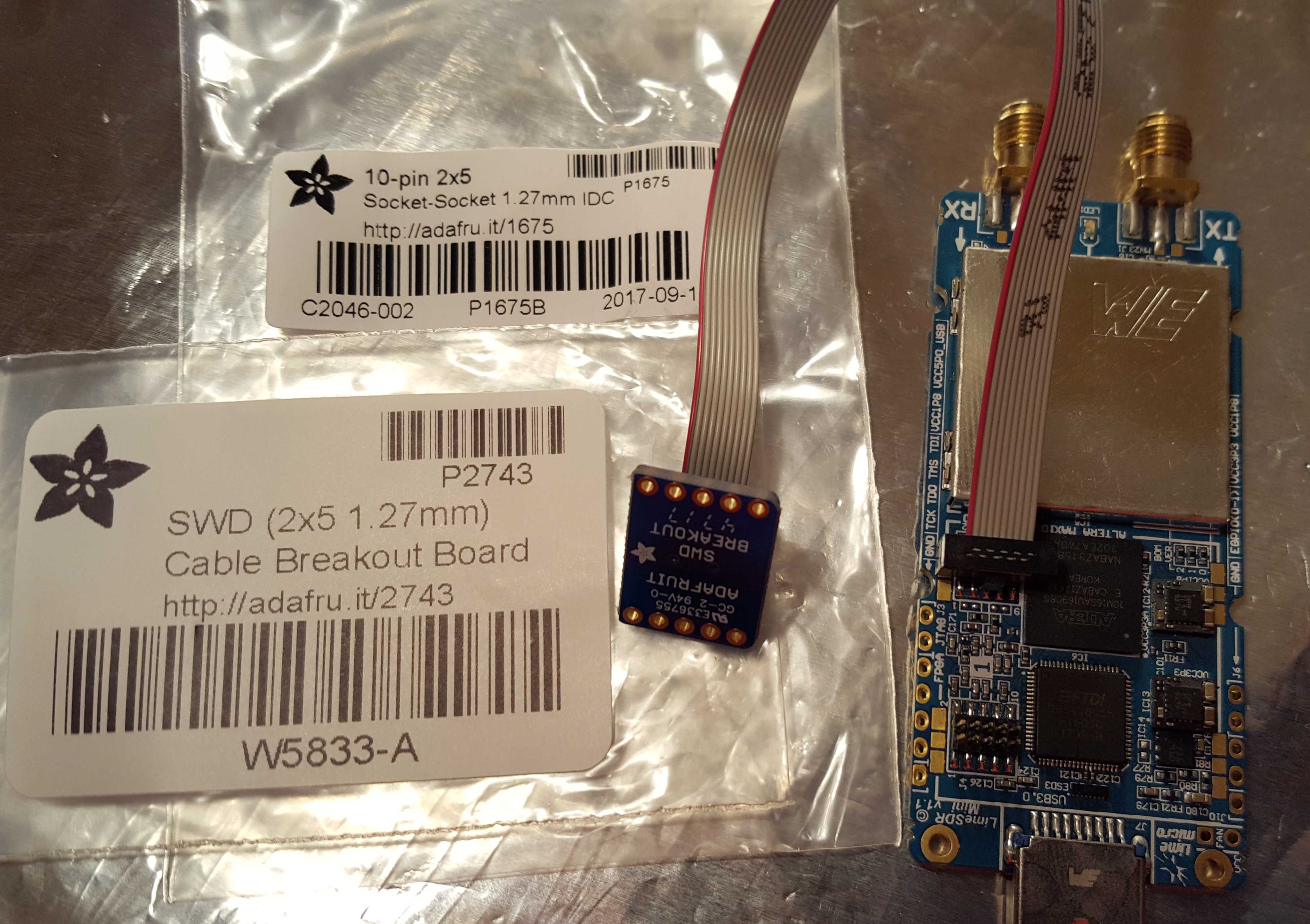

To prevent accidents on the bench and save soldering wires directly to the LimeSDR board.
I fitted some 1.27mm headers and a cable out to 0.1” breakout board.
