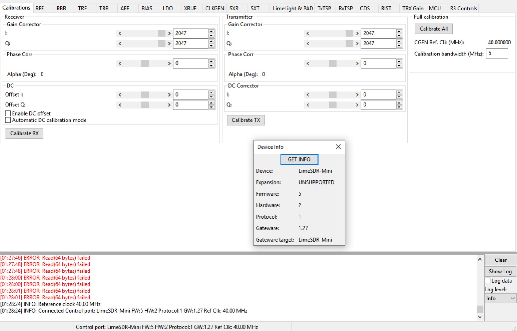

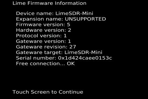

As far as I can see, you have the correct firmware and gateware installed. It is the gateware version that is critical (needs to be 1.27). Your windows screenshot shows the same info as the report on a correctly configured LimeSDR Mini on a Portsdown - see below.
Looking at when it was dispatched, your LimeSDR Mini would have been dispatched from the BATC Shop in this state, as Noel had spent some time getting them all to the correct standard to make it easy for Portsdown users. Note that the latest gateware version available online is 1.28, but this may not be compatible with Portsdown or DATV Express. Charles and I have better things to do than go chasing new versions when the old one works perfectly!
