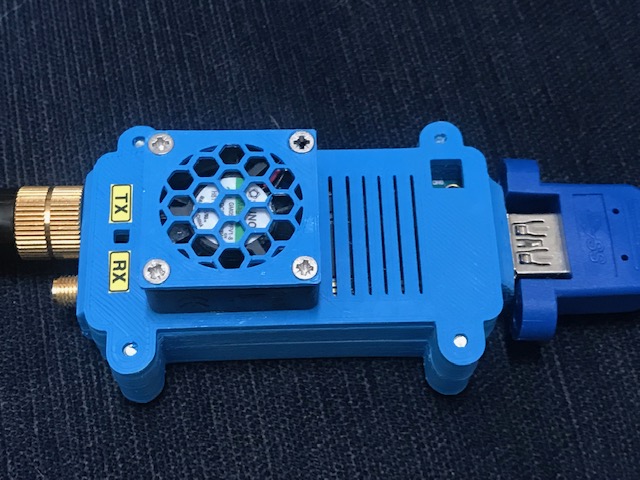

Hi Gareth,
I am extremely well pleased with the design and quality of the case. It fits neatly and gives the necessary support to the USB connector.
Many Thanks

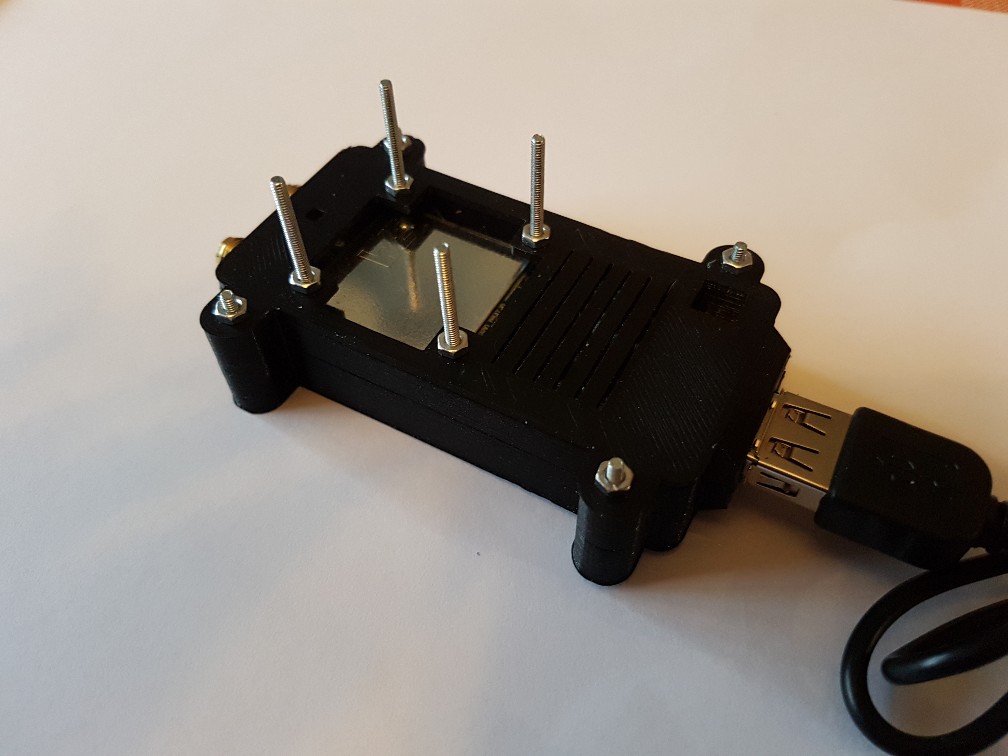

Thanks for the case Gareth. It required a little paring around the aperture and location lugs with a sharp craft knife for my Lime mini to fit.
Radio Gareth Lime Mini case at M0YDH.jpg (91.94 KiB) Viewed 20095 times

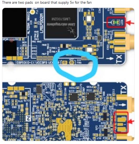

The fan is on order. I remembered this tweet by John G7JTT identifying the pads for the fan connections
David
Fan supply pads - from a tweet by John G7JTT
Lime Mini fan supply.JPG (68.47 KiB) Viewed 20095 times

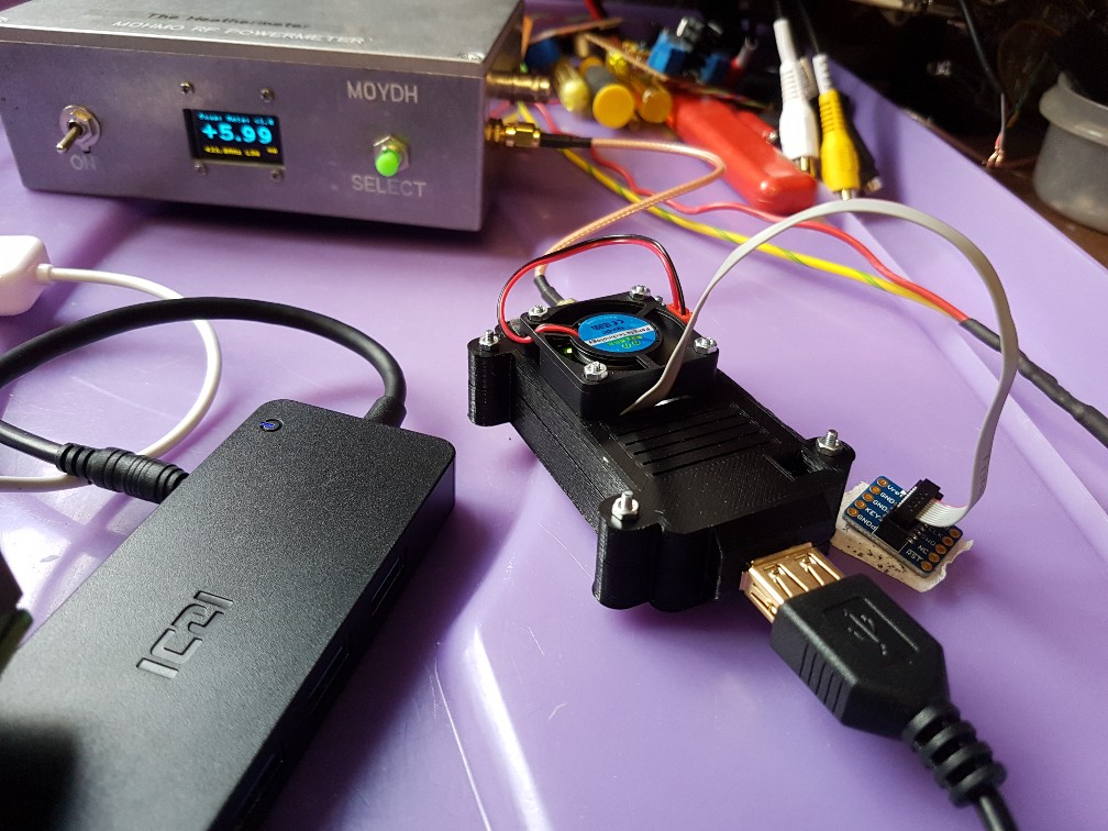

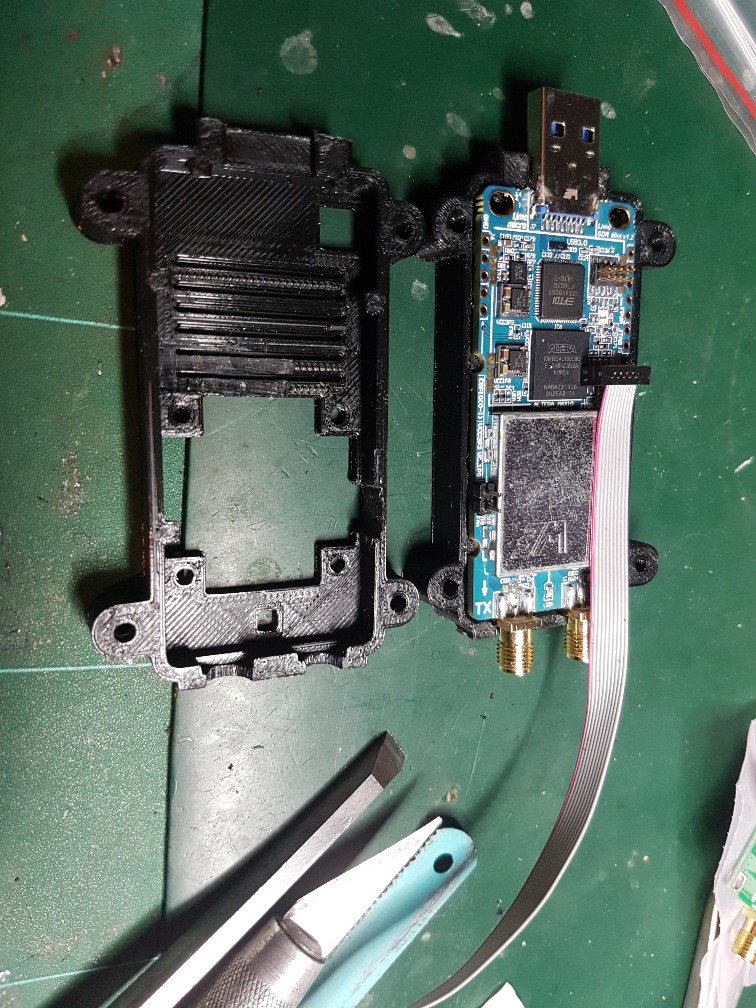

Pictured is my encased Lime mini after altering the case to take the 2 pin connector for the fan and make some headroom for the connector to the breakout board. (See GPIO pins thread). I shaved about 1.5mm off the inside of the two bars nearest the fan that make up the ventilation grille.
If anyone has the .stp file I'll alter the case in CATIA at work.
Thanks to Gareth for the parts.
David M0YDH
Top case showing slot for fan connector & area shaved away to make clearance for breakout connector.
Lime mini making 6mW on 70cm. Fan running.

Nice little milliwatt meter. Homebrew?
M0YDH
Posts: 269
Re: 3D printed case for LimeSDR Mini
Post by M0YDH » Sat Feb 09, 2019 10:57 pm
That's the Heathermeter, Gareth. The GQRP club shock and awe project for their 2017 Buildathon in Telford was not a direct conversion receiver :o , Heather M0HMO designed an original multiband power meter with an Arduino in it. I put my finished example in a diecast box with a decent heatsink. 437MHz is its top frequency.
David M0YDH
