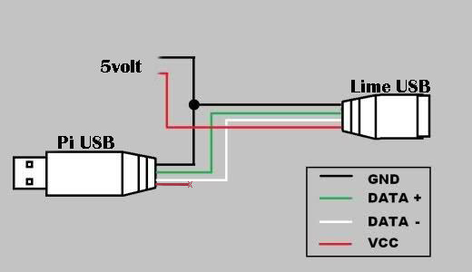

For some reason the Raspberry Pi would not reliably see the Lime SDR via the USB hub I have, and there wasn’t room in the case for it without moving things about. So in the end I changed a USB patch lead by cutting the positive wire (Isolating the Pi) and powering the LimeSDR from the Portsdown 5volt power.
PD_USB Power.jpg (40.91 KiB) Viewed 5831 times
