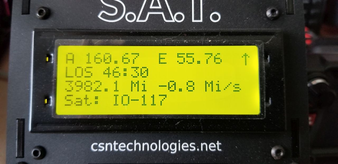

Don't know what you saw but I had to reply.
This is the device I use, it only works with ICOM radio's at the moment, It's the best radio kit I've bought. Will be ideal for tracking the ISS.
Mine came directly from the US (support is brilliant), you can buy them from MLS now.

Hi Roger and all the main unit is a camera pan & tilt unit that works on 24v and has internal multi turn pots for feed back. The oringal project can be found here
https://www.hackster.io/viorelracovitea ... are-48f9cd
I use Orbitron to track sats with the DDE plugin from here
http://tripsintech.com/orbitron-dde-azi ... to-serial/
Apart from the pan & tilt unit (which I had for years) I think I built the whole thing for well under £50. It does work well but has limitations, like it's only 0' to 90' elevation which means it needs to spin 180' azimuth when it passes the 90' but the P&T unit is fast enough.
Hope this is of help it really is a simple project compared to some of the other controllers out there.
