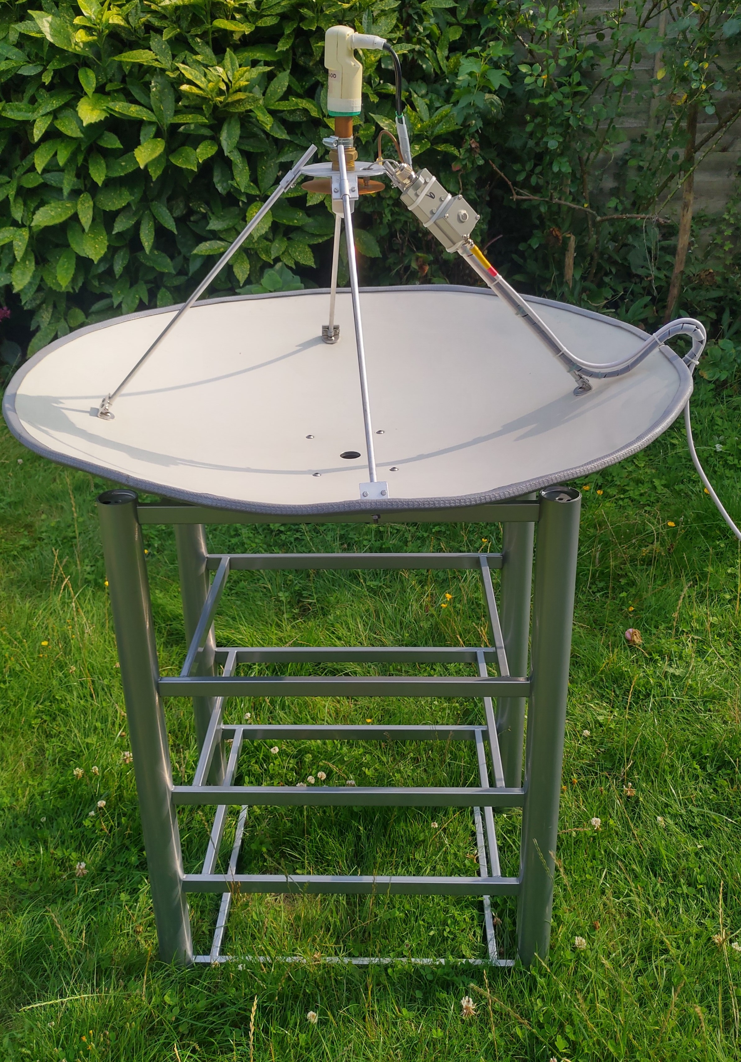

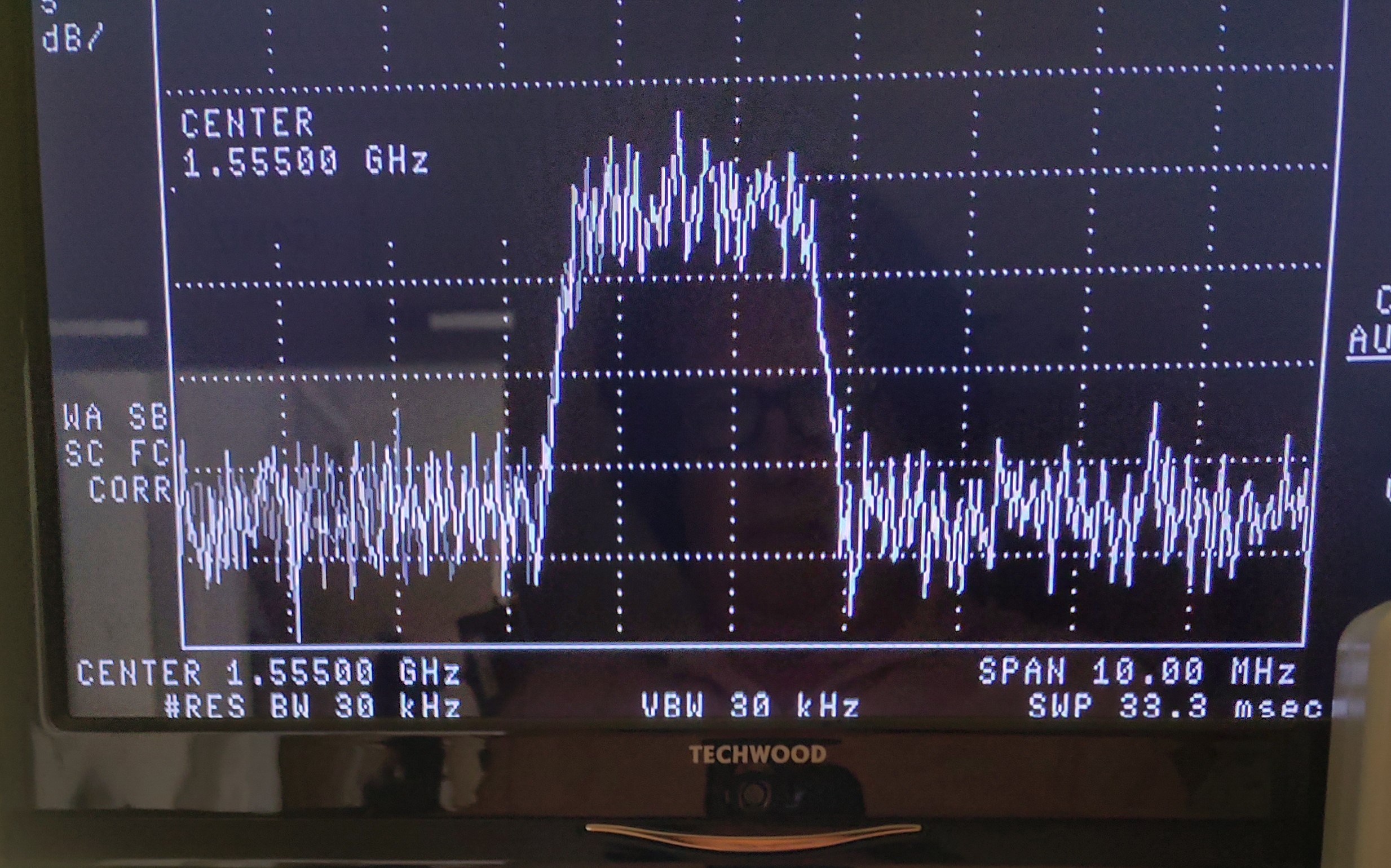

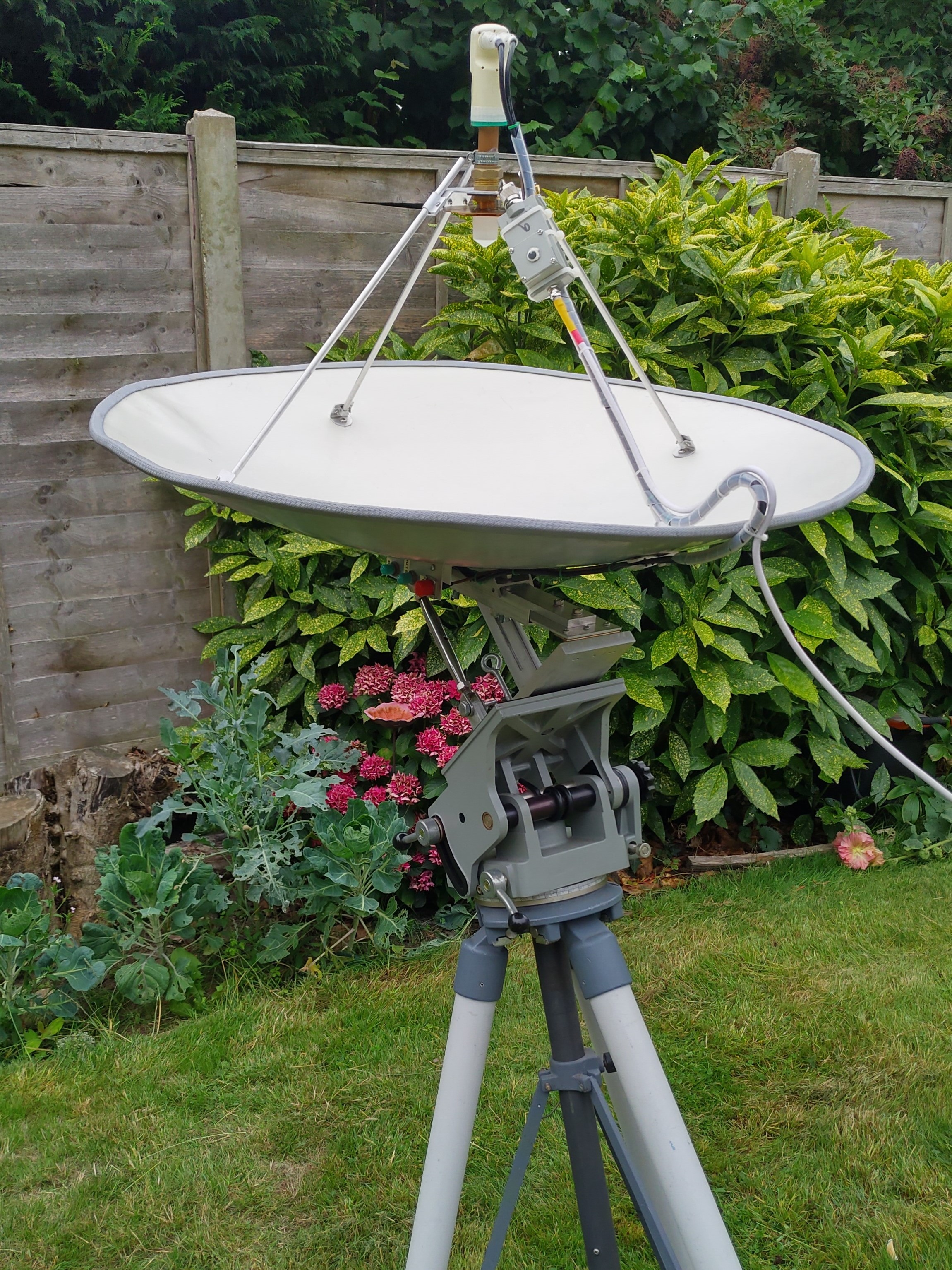

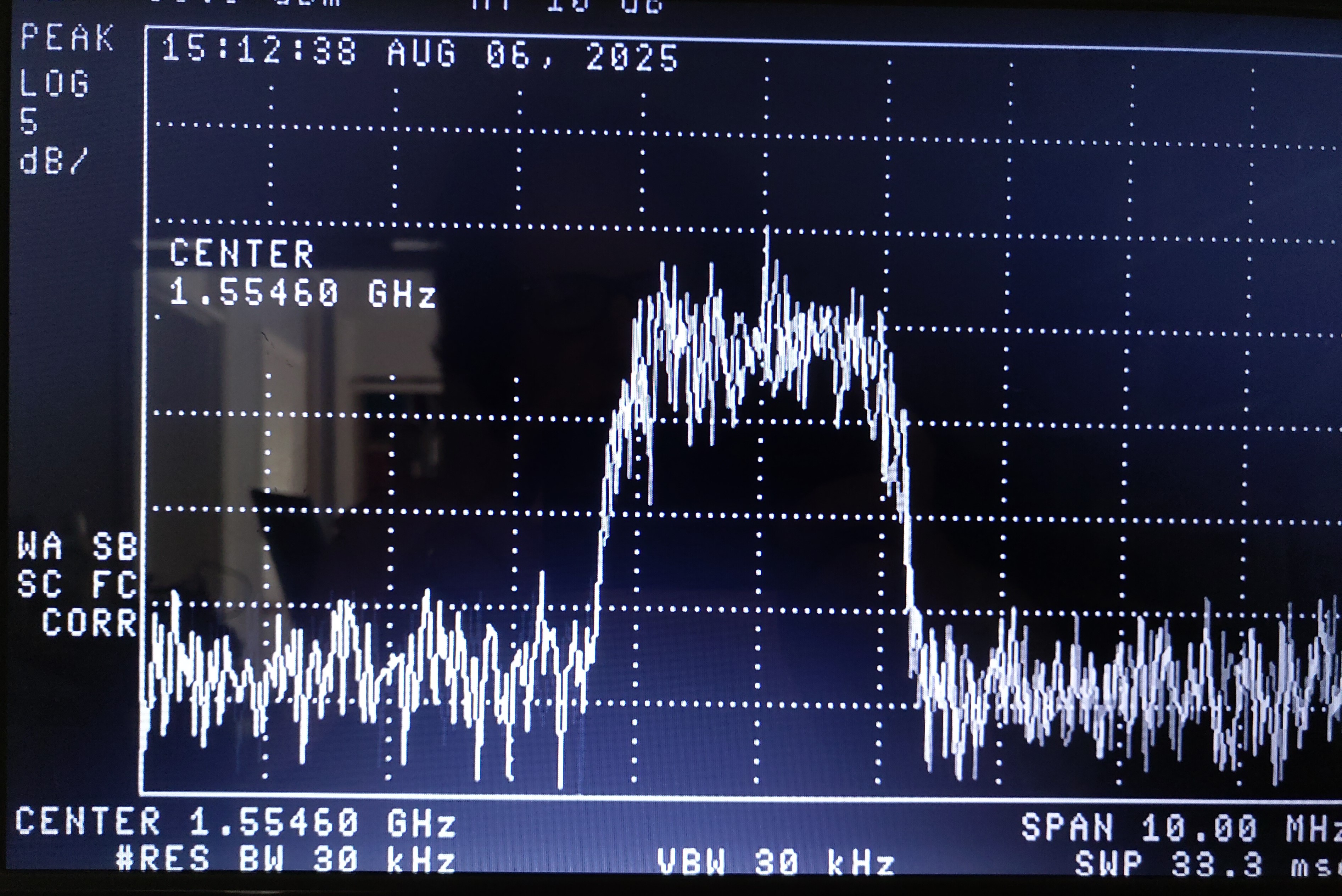

Hi all,
If you want to test your receive system, why not try the 'Transit' method in which no positioner is required ?
Just point your dish straight up and wait for the ISS to pass. Suitable passes (80-90 degrees-ish) can be found using a website such as 'Heavens Above' with your location entered (nearest town good enough). Tick 'All Passes' not just visible ones.
Caveat: your Latitude needs to be </= 51.6 degrees in order to get an elevation up to 90 degrees, due to the orbital inclination of the ISS. However, do check for your location as Latitudes slightly above will still be usable with this method.

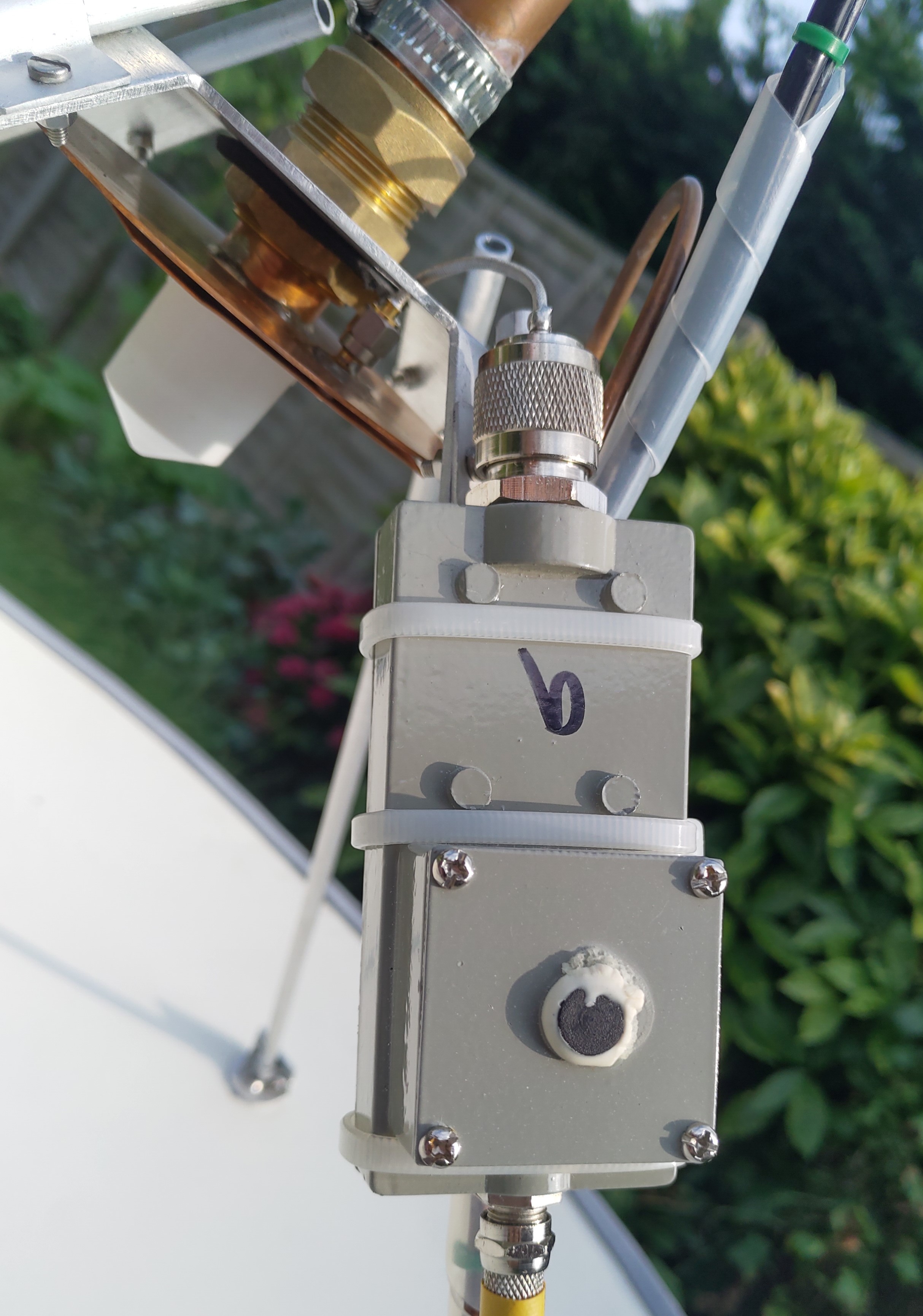

I got good reception on an old 90cm prime focus dish using a POTY and an S-Band LNB, which was marked NF 0.4dB, with a measured gain of about 55dB and an LO of 3950MHz. The LNB box was marked 'Primesat'.
Note that the dish was part of a re-purposed QO-100 system. The Ku-band LNB didn't add anything in this case, but I didn't want to remove it.

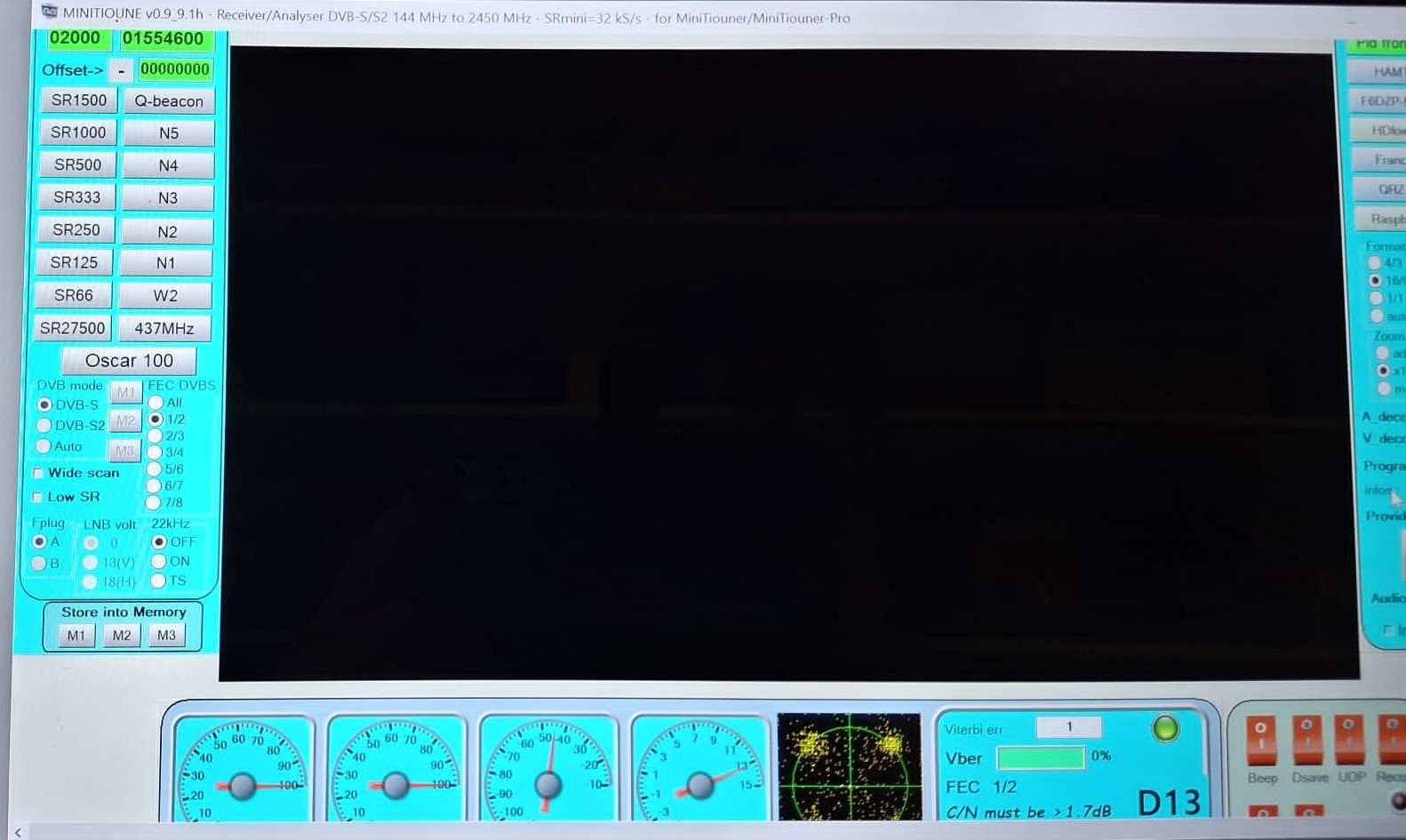

I received two sequential passes (85 and 89 degrees resp.) with good S/N and video decoded on the second pass, possibly due to a small frequency offset having been removed.
Have a go!
Jen G4HIZ

Unfortunately, I bought the LNB a few years ago from a UK supplier.
However, Googling 'PrimeSat S-Band LNB' brought up one supplier of a similar looking unit, eg AliExpress for about £75 plus postage, from 'Bowei Electronics'.
https://www.aliexpress.com/item/1005001 ... ElAeSNEGoX

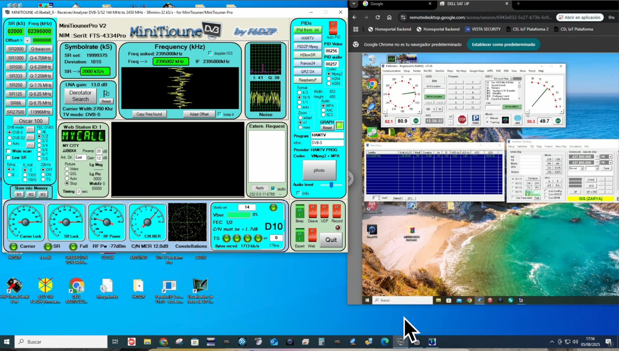

Good reception in EA6 Mallorca Island - 5 Aug 2025 17:50 - 18:01 locat time max elev 59º
120 cm dish, Spid Ras /HD 0.1 º rotator , Helix feed, DG0VE preamp, 35 mts Sat Coax , Minitonuer Rx, peak MER 12 - Black picture
Tom, EA6WQ / KE0KQT

Post by g4hiz » Thu Aug 07, 2025 9:00 pm

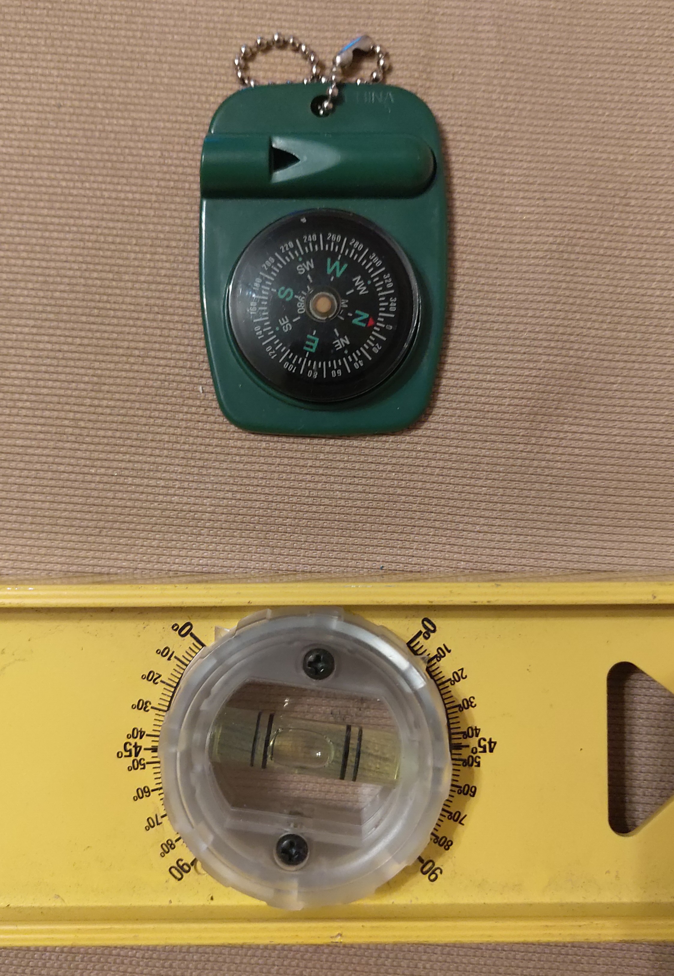

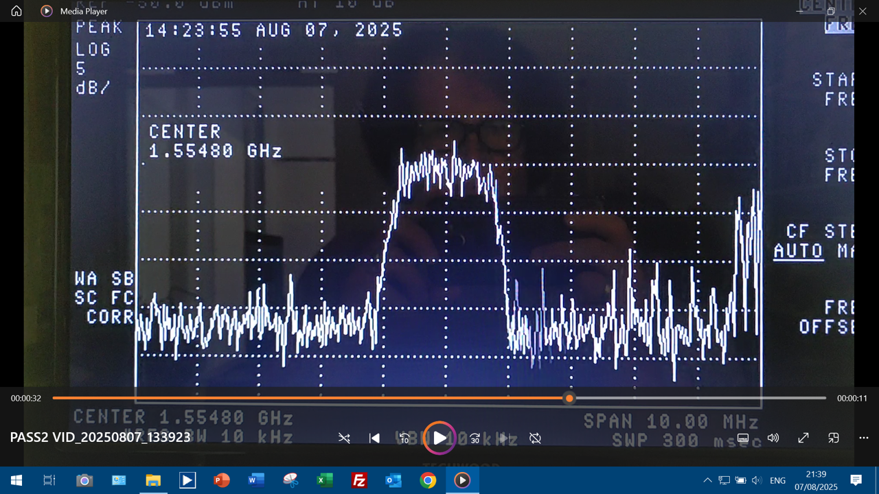

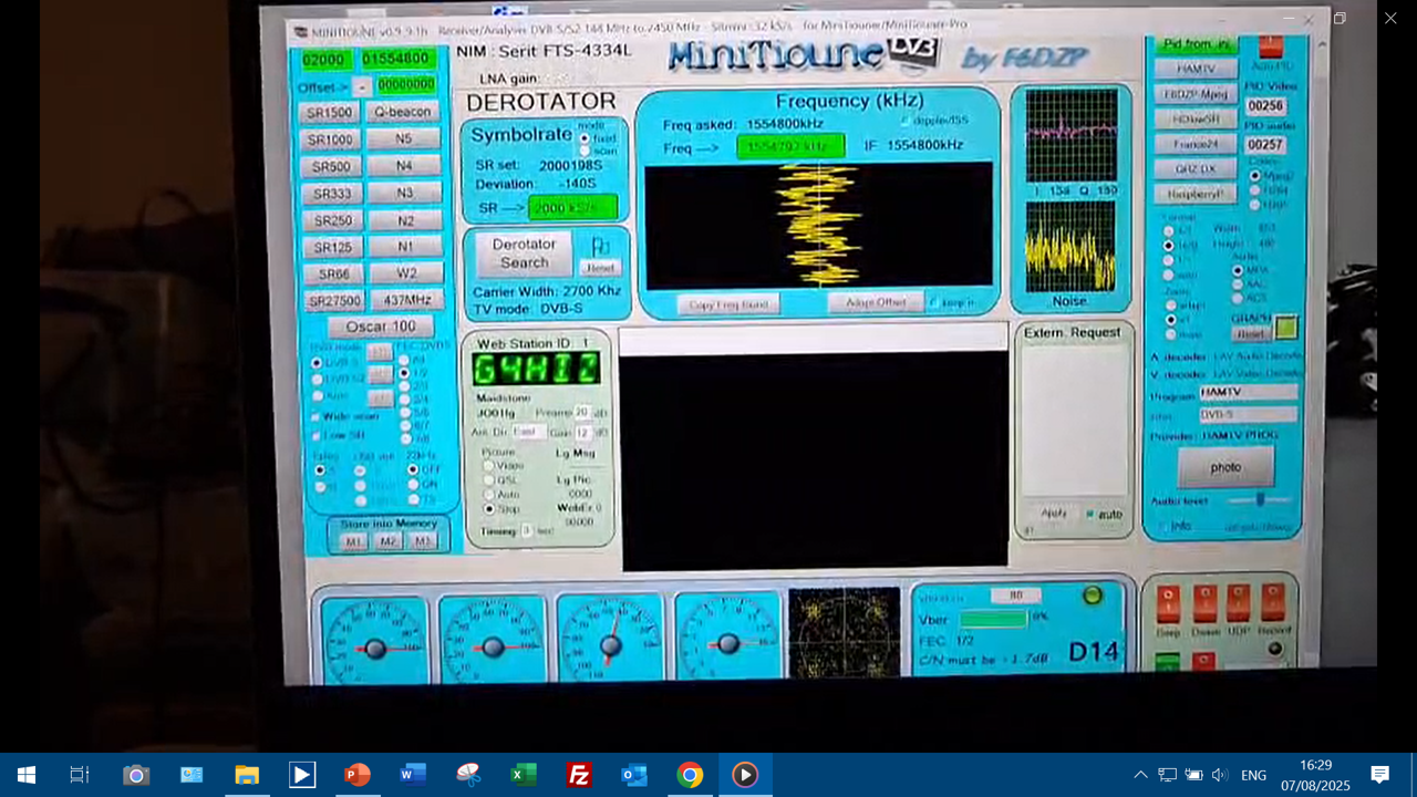

Hi Liborio,
on a test today with the 90cm dish static pointed for an 83 degree elevation pass, the time for the ISS signal to emerge and then disappear back into the spectrum analyser noise floor was about 24 seconds. There was about 20s above the threshold for demodulation, with the receiver taking about 5s to lock, giving up to about 15s of video, with a peak of D14. There was sufficient viewing angle and signal strength to see pickup on the first side-lobe of the antenna.
The antenna was aligned with very simple tools. Although for any particular location, one should take into account the local variation of Magnetic North versus True North.
Jen G4HIZ
Edited to add 2 photos and a bit more explanation
