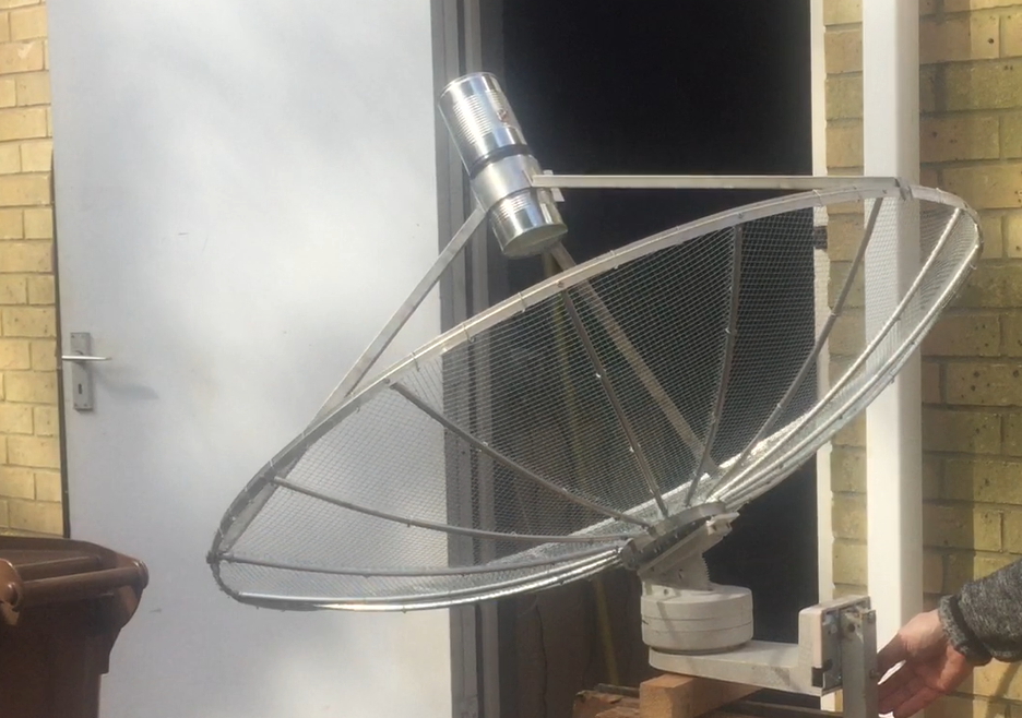

Hi John, I built a 1m dia mesh dish in the hope that eventually I will see pictures from the ISS. It's mounted on the Mk 1 mount. I'm currently building a Mk 2 version, a more heavy duty version with computer control. I decided to use a feed horn ( 2 Tesco tins of potatoes soldered together.) instead of a helix. The reason being a Helix would be more likely to pickup Wifi interference coming in from the side. I used a dielectric plate to give circular polarisation. Measured as 2.5db improvement from linear. Probably 0.5db loss in the dielectric.

G7JTT
Posts: 396
Re: HamTV Status
Post by G7JTT » Tue Aug 27, 2024 5:26 am
Very nice dish Nick, one day I'll get around to building one of I don't find something in the meantime. As to WiFi yes I do see that with the helix but thankfully I'm semi rural here and its not too bad, but interested in more details on your feed if it's posted anywhere ?
