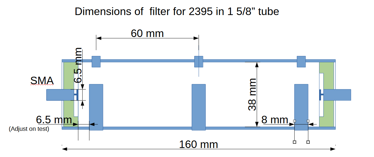

Seeing that my junk box contained a piece of 1 5/8 OD copper tube, I thought that may be a candidate to make a filter. At 38mm I.D. the waveguide cut off frequency is 4.6GHz; so between that of the 40x40 and 30x40 tubes in the other designs. At only 160mm long it is only enough for a three pole filter.
Copper Tube 2395a.png (49.51 KiB) Viewed 3155 times
I am not suggesting this is a better solution than the other filters in this thread. (I expect it would be harder to find and more expensive that the Al sections)
But shows that you don't need to follow an existing design slavishly, there are many variations possible and if the filter is properly adjusted then the performance of any 3 pole filter will be very similar. It is shorter in overall length because the ends are sealed rather than relying on the evanescent waveguide to terminate the filter. Rough sketch attached.
Edited 20/12/25. Updated sketch to show more detail in of the "finished" filter.

Post by radiogareth » Sun Nov 30, 2025 2:11 pm

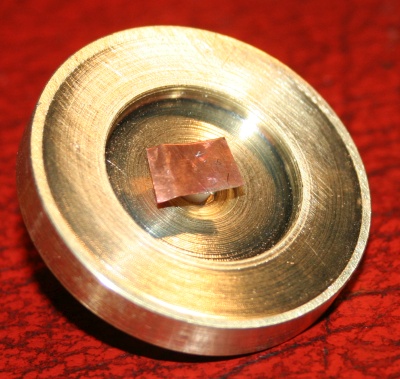

Well that's nicely answered one of my 'wonderings' and prompted a quick scoot into the garage/workshop where there is a good stock of sundry copper tube, including a good length of 1&5/8". Not sure I have any copper rod but plenty of suitable brass.
Could you post a picture of the feed cap arrangement as the reduced dimension/feeding arrangement may be useful for developing a really compact solution.
Thanks.

Post by G3YKI » Sun Nov 30, 2025 6:06 pm
Hi Gareth,
I have a photo as requested. First to say this was just a quick and dirty assembly as a first test, so not to the highest construction standard! The "tab" seen here is about 6 x 8 mm. Then the distance to the resonator is "Adjust on Test" and not possible to measure afterwards, so estimated to be about 10mm. The inners were 8mm plumbing tube, quite thin wall but just enough to thread 5/16" x32 to mount them.
