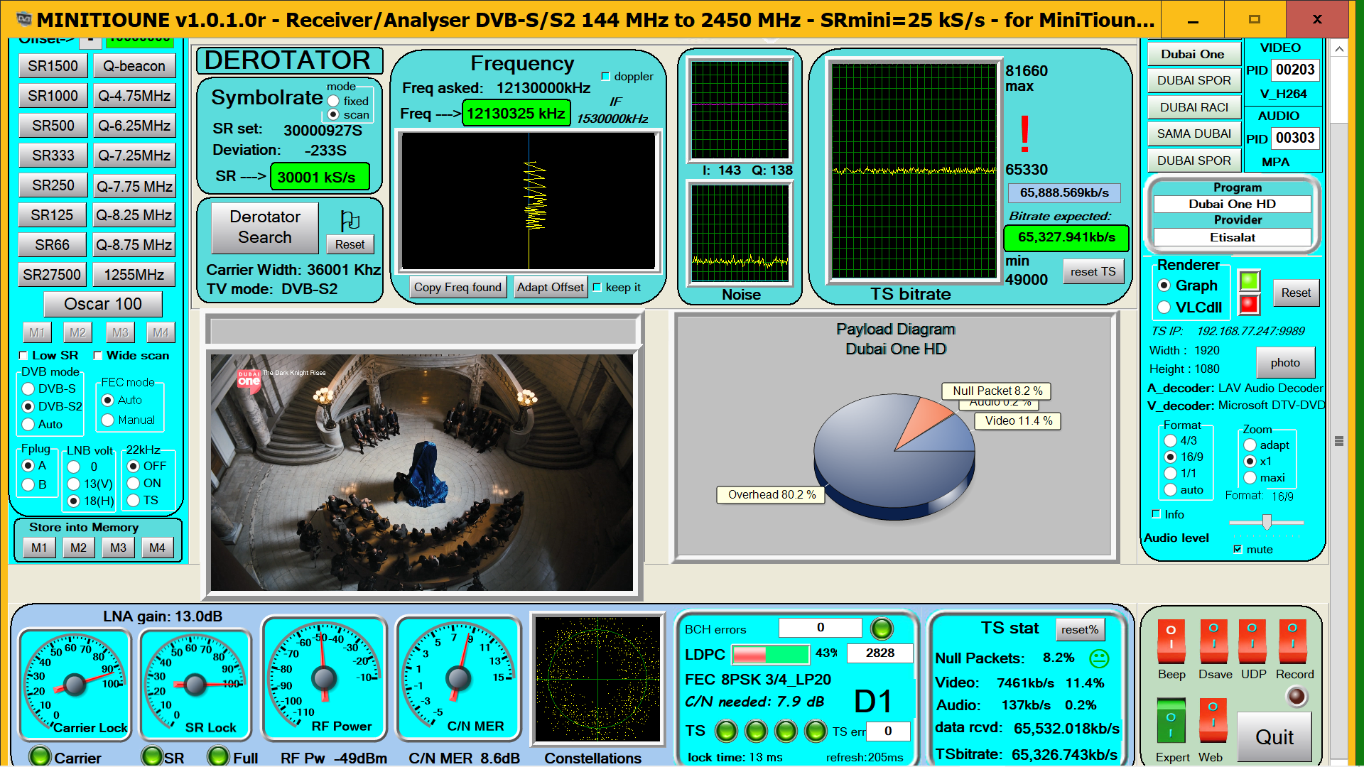

Post by g0mjw » Sat Jan 27, 2024 10:29 am
On my Satfinder the MER is around 12dB.
The Minitiouner isn't designed to receive broadcast TV and I had to mess around to set my Winterhill up to provide the right LNB Bias and LO switching which I then verified was correct with the satfinder behind a DC block I could still receive. Not so the Minitiouner Pro2 which can't seem to get a lock.
This is the danger in this sort of posting as it raises expectations in some of dong something the tuner was never intended to do. They then complain it doesn't work when it was never supposed to.
Please can we delete this thread referencing the Minitiouner, it is fine with a broadcast RX, and say no more about it with respect to Minitiouner, Portsdown etc.?
EDIT BATC Minitiouner works. Just goes to show.

Post by G4EWJ » Sat Jan 27, 2024 5:40 pm
Yes, Minitiouner does work at SR30000, as demonstrated above. If you're not supposed to try it at SR30000, then the Minitioune software wouldn't allow you to put it in.
The WinterHill Receive Commander program is designed to simply change LNB supply and LO settings.
We're experimenters. A lot of what we do falls into the category of 'not designed to'. The FTS4334 is not designed to work at low symbol rates. UMTS amplifiers are not designed to work at 2.4GHz. "Those short wavelengths will be no use for radio communication".
Can we please stop demanding that people should not experiment and post their findings. Can we please stop demanding that 'wrong think' be deleted.
