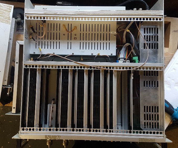

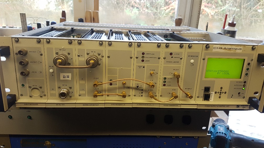

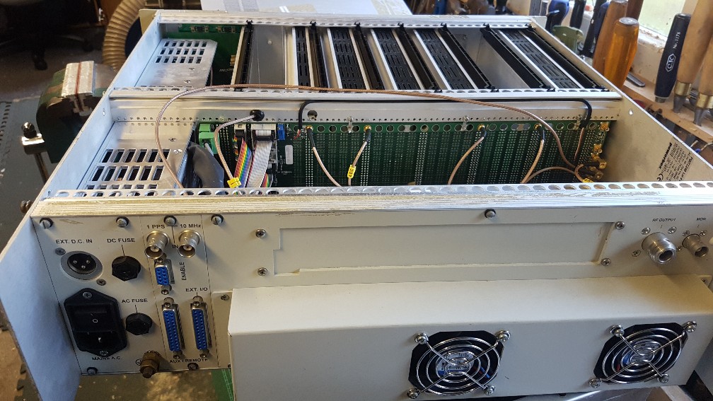

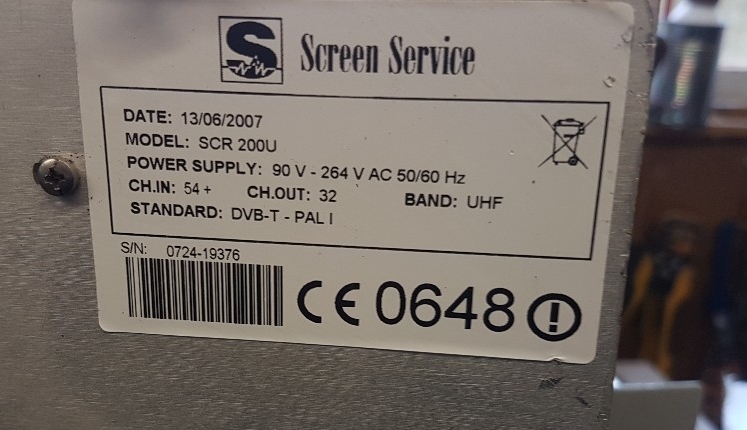

Our club has some UHF TV kit. I'll post pictures of some of the items. These will probably go for sale at rallies in 2023. First up today is a Screen Services SCR200IJ unit. To my untutored eye it looks like a transverter taking in TV on one channel and retransmitting it on another perhaps to a local site at a lower alitutude. Comments or recollections welcome

Yes Dave,
It is a UHF transposer. Many TV relay stations were re-engineered with these Italian sets in preparation for the digital switchover. They were capable of operation on either system with minimal work on the changeover day. Probably a 2W set (That is 2W peak sync. plus sound at -13dB plus Nicam at -20dB) At Switchover a 2W station normally became 0.4 W digital. The input filters will be 8MHz bandwidth and I would expect to see an output filter as well but that could be in a 4 channel combiner as a separate unit.

Thank you Ken for the informative reply. This hand built marvel of engineering will probably sell as a 3U chassis with a 10MHz TCXO and a few patch leads.

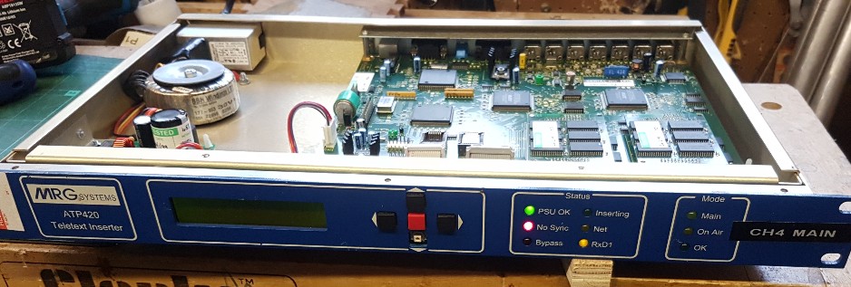

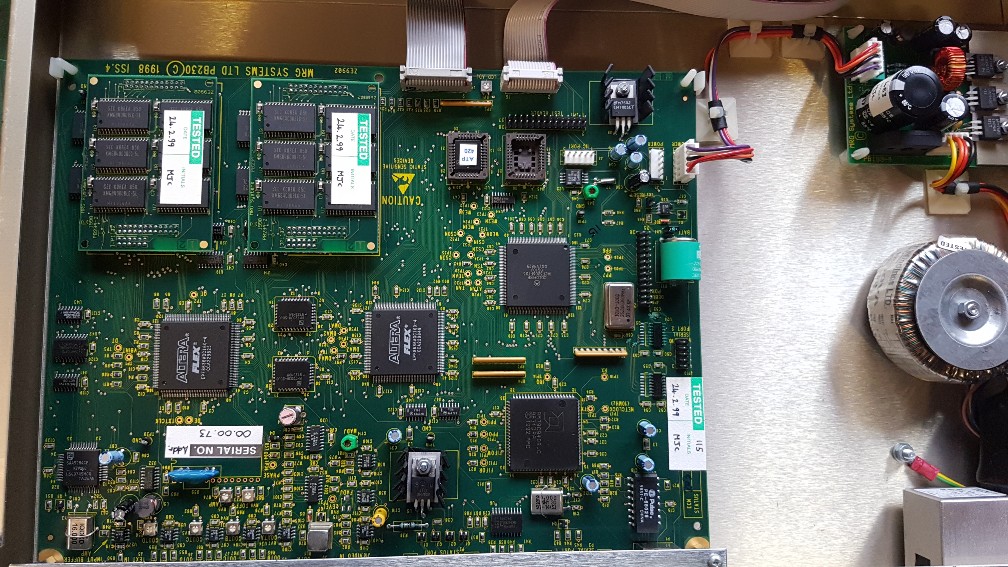

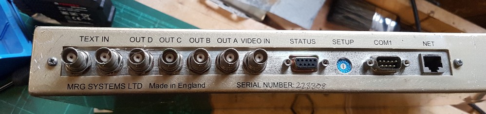

I'm going to post pictures of a Teletext inserter next. This one is labelled Channel 4 Main. It powered on and did self-test from which it concluded that the PSU was OK and it had no inputs.
I wonder if any TV club member will want one to play with? Otherwise it's an aluminium 1U box with a 160mA output main PSU

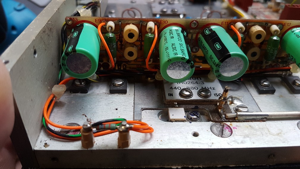

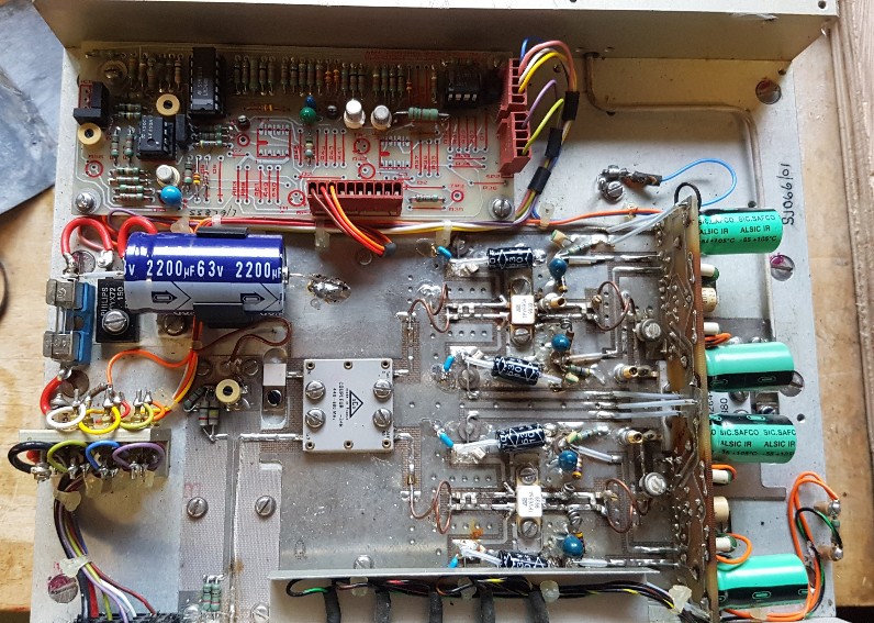

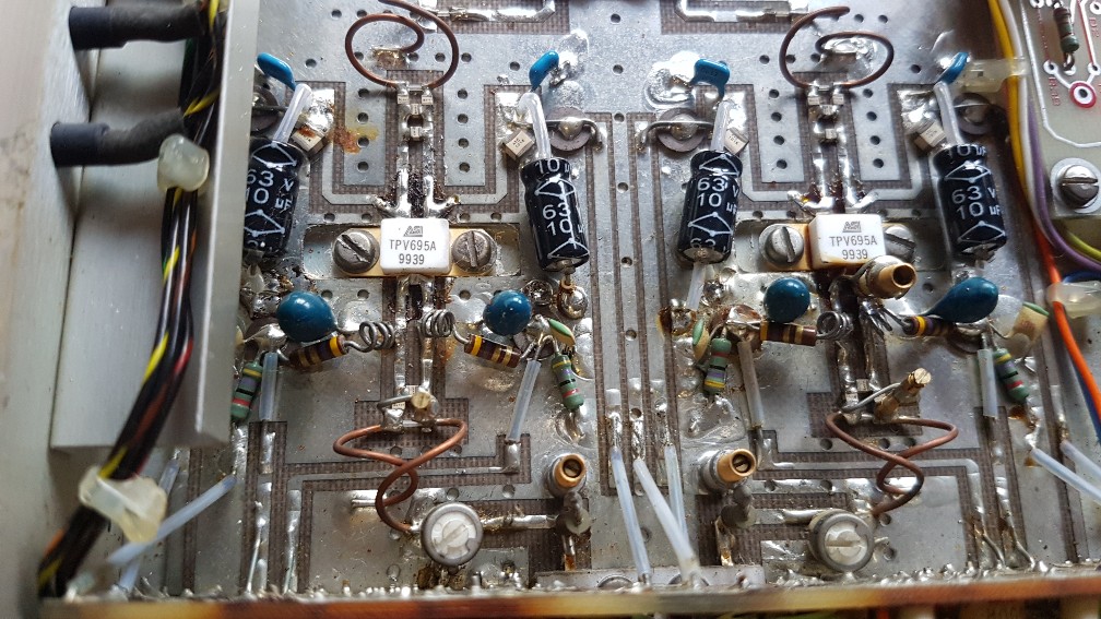

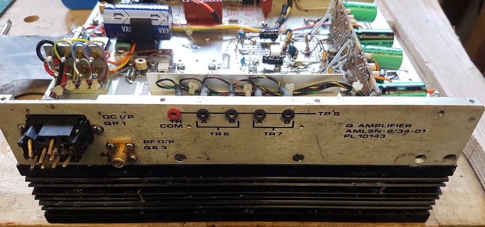

Next item is one of several Q amplifiers by Continental Microwave. I wonder if anyone has recollections of these? A pair of TPV695A Transistors feed into a IH0264/3 combiner or circulator [because there's a load resistor attached]. https://www.alldatasheet.com/datasheet ... V695A.html . They appear to 50V devices. Were these used with a transposer? There are lots of 440-880MHz markings on parts. I wonder if they can be repurposed on 437MHz?

I am not familiar with these, but I would say:
1) The data sheet for the transistors says 25 v operation.
2)The splitter and combiner are 3dB Hybrids. Almost certainly 3dB couplers, as these have a much wider bandwidth than any other type.
3) Likely for 2W in and 10W out (Analog TV) after a 2W transposer, as these were the usual powers for small relays. Class A, 90W DC input.
4) Those transistors have been operating at close to their maximum rating, 24/7, for possibly 20 years!

Hi David
I am sorry to say I am unable to help with the CML device you have shown in your post.
It is probably something made before my time at CML
I did not join CML until 1971 and worked there until the factory closed in 2003
That type of construction should make it possible to be tweaked for 70cms.
Good luck
