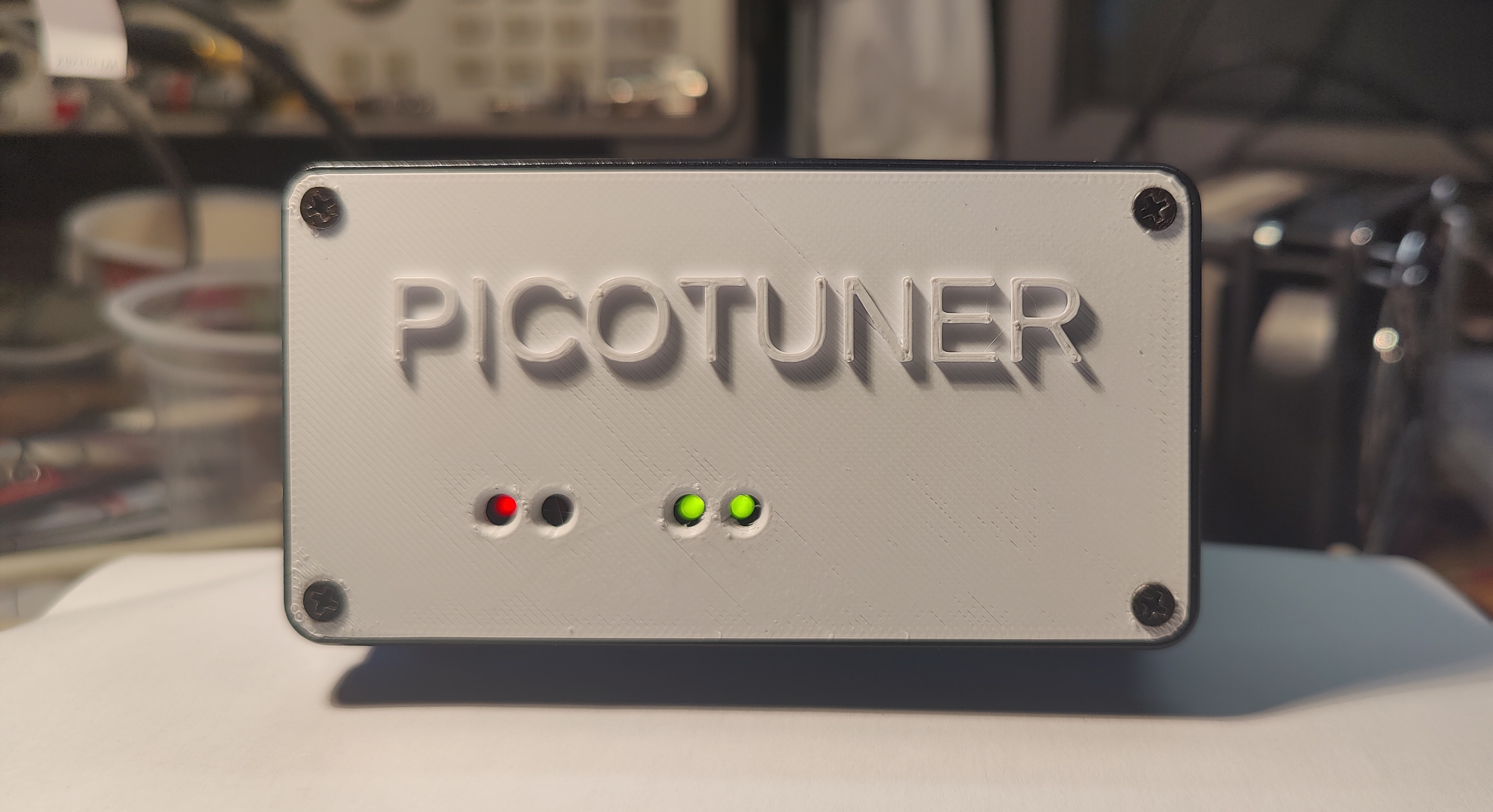

Picotuner front panel
Posted: Thu Nov 27, 2025 11:53 pm
by F1CJN_alain
I have asked to the free Gemini AI to make a 3D model for the Pico front panel from a text description.
I asked for a compatible file with OpenScad.
- First copy the file,
- Copy the file into the free OpenScad 3D application,
- generate the image and export it as a STL file,
- print the 3D model with your prefered printer.
I put the front panel STL file and also the modified back panel STL without the Ethernet connector hole, in this repository
github.com/F1CJN/Picotuner-STL
73s
Alain F1CJN

Re: Picotuner stl
Posted: Fri Nov 28, 2025 10:28 am
by g0mjw
Interesting approach. Perhaps ask it to label the panel and countersink the holes?
Re: Picotuner stl
Posted: Fri Nov 28, 2025 4:08 pm
by F1CJN_alain
Thanks it is done ans has a good shape.
The file is updated in my Github.
Thanks for your adds.
73s to all
Alain F1CJN
Re: Picotuner stl
Posted: Fri Nov 28, 2025 4:24 pm
by g0mjw
Pico-Front-Panel.jpgThanks for your adds.
73s to all
Alain F1CJN
That looks good, but I only meant the mounting holes. LEDs however don't look bad countersunk. Interesting.
Re: Picotuner stl
Posted: Fri Nov 28, 2025 8:59 pm
by Basil
Looks great!
Did you countersink the LED holes with a drill bit? I work with drills, taps, lathes, mills and suchlike every day, if you use a drill to countersink with you need to use a drill press and fasten what you are countersinking down to the table. It's much easier to get concentric countersunk holes with proper countersinking bits. You can find them dirt cheap on Ebay, and unless you are countersinking stainless or something pot hard, cheap ones are fine.You can usually get away with using them freehand in a pistol drill. Usually.... ;) I hope you are not offended by my nitpicking.
Re: Picotuner stl
Posted: Fri Nov 28, 2025 10:05 pm
by F1CJN_alain
Hi Chris
This Pico front panel is printed in PLA with my Creality K1C 3D printer.
I did not make any mecanical holes or finishing.
73s
Alain F1CJN
Re: Picotuner stl
Posted: Tue Dec 02, 2025 12:31 pm
by Basil
Oh, my apologies Alain, I thought it was drill swarf around the hole. A very good looking case whatever. :)
