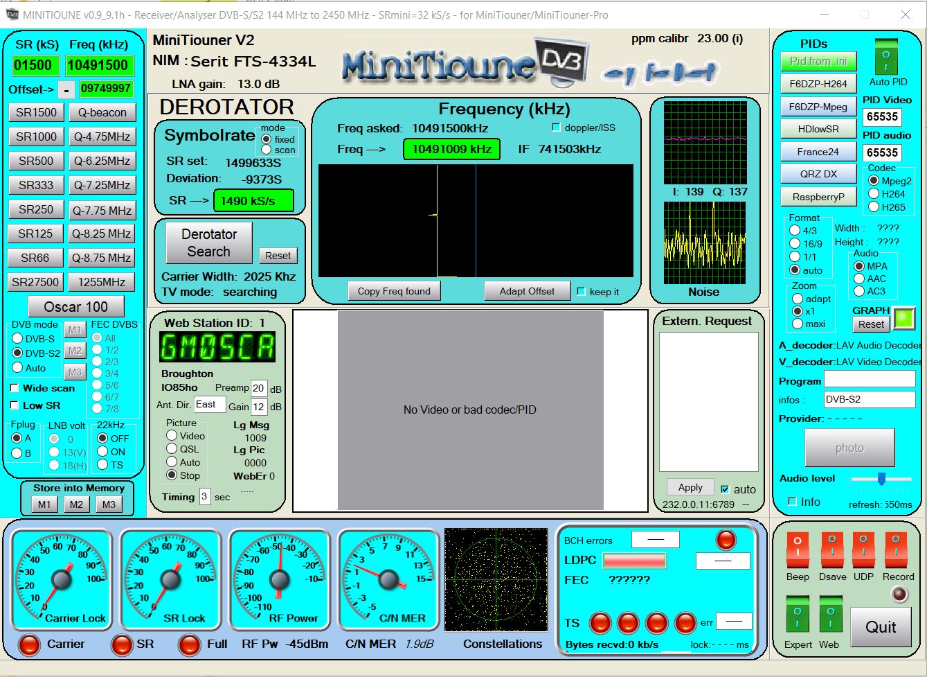

I am trying to get my MiniTiouner up and running just on Rx at the moment and then I'll think about Tx. One step at a time. So - using the latest MiniTioune V0_9_9_1 package, and following the read me document:
- TestMyMiniTiouner V2_3 gets green LED's. 58% performance which isn't brilliant but (I hope) sufficient to start with
-Chech MiniTiouner Driver and Filters V0_6a gets all green LEDs with moving pictures and associated sounds.
Testing voltages around the board: Supply (input) 13.1V; DC-DC output = 4.1V; L1 = 3.25V; L2 = 1.1V; L3 = 3.25V; LNA A (top) = 12.95V; LNA B (bottom) = 12.95V
So far so good. I think.
MiniTiouner LNA A is connected to 4G LTE Signal Filter and on to 90cms offset dish (which works fine for QO-100 NB). The dish has a Bullseye LNB which, because I am feeding it with 12V (the filter does pass the DC through), I have turned through 90 degrees to horizontal (18V buck converter is on the shopping list).
Then I load the MiniTioune software (I think I have configured the .ini file correctly with callsign, locater etc) looking for the A71A DATV Beacon. And that's where this journey stops :) I have attached a screen shot of what I get; the kS/s value in the green box in the Symbolrate keeps changing; the Carrier and SR Lock meters 'twitch' but I don't get any green LEDs across the bottom row.
Does the screen shot give any clues - I am doing (or not doing) something daft?

The program defaults to the beacon and I get exactly as shown in the screen grab in my earlier post - two separate vertical lines. I do get the zigzag lines if I hit the Scan button and I have left that running for a good few minutes, but no change. I did notice that the Offset was slightly different - on start up it shows 09749997; assuming this refers to the LNB, mine is 9750 but changing the value makes no difference once all three boxes (top left) are green.

OK so... 4G filter makes little difference in / out of circuit. SDR Console shows ~54dBm on the NB PSK beacon (10489.750) with the LNB at -18 degrees skew; virtually nothing with the LNB approx 90 degrees (i.e. horizontal). I'll have another check with the dish alignment. I don't know if there are any GM's near me using QO-100 - it's probably the only way of me getting on DATV due to my location in a valley.
