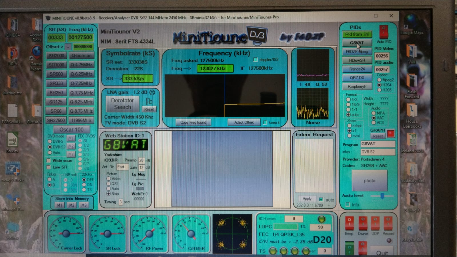

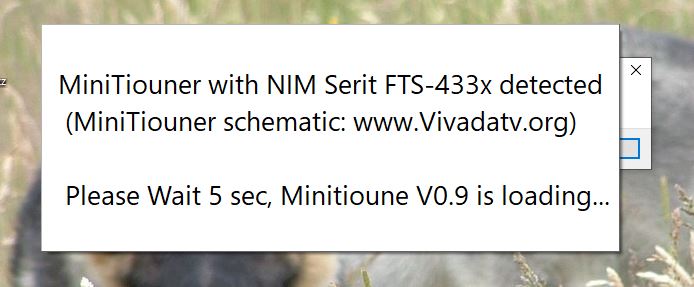

When I start the Software a Version and NIM message appears, behind it is a window which I cannot bring forward and can only close (red X), I get a glimpse as I close it, it says something about a standard filter? then the Minitiouner Window opens.
When I TX to GB3EY I can get into the repeater which tells me my TX is OK. But can't get a picture on the Minitiouner.
Far as I can see I have set things correctly... I have a full carrier lock, I have a full SR Lock. My Callsign appears in the Channel List and once selected the PIDs are correct and H264 is correct, so what am I missing (apart from my picture)?

The message about a filter is probably saying that you do not have the right video filters loaded on your PC. A complex area that I am not familiar with.

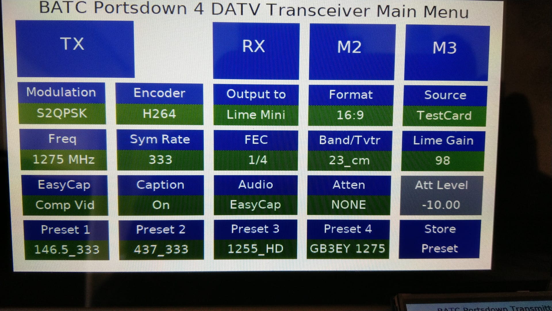

Try selecting FEC 9/10 on the Portsdown transmitter. 333 kS at FEC 1/4 does not leave much room for any video - three quarters of the data will be concerned with error correction. Setting to 9/10 means that only 10% is error correction and the rest is available for a picture.

Cheers for the quick reply Dave..
Changing to 9/10 hasn't made any difference I can see (still no image).. I have it set low because my signal into EY is borderline and that gives me the best chance of access.. I daresay I'll be QRT on EY again soon, since the Trees (that I'm surrounded by) are now sprouting again.

I'm not an expert but if you open the 'MinitiouneV09beta8_9 package' file you should have two files which need to be installed manually if you have not
already done so:
install_usrc_ax_winXP_win10.exe
LAVFilters-0.71-installer.exe
Double click each file to install.
On the right hand side of the Minitiuone screen there is a square LED (next to the GRAPH reset button) Showing Red, this should be Green when all is working.
The rest looks ok, and you have FPlug B selected as input.
BTW. 'Minitioune v1.0_1.0r for beta test' is the latest Software version.

Wolfgang is correct; that error only pops up when you haven't installed all of the prerequisites.
Note that the last release of Minitioune does not have them in the installer archive. You need the v0.8 package that has the LAV filter installer and the USR-AX installer. Once those are in you run the later versions.
If you can't find them let me know and I'll put them in the Cloud for you.
