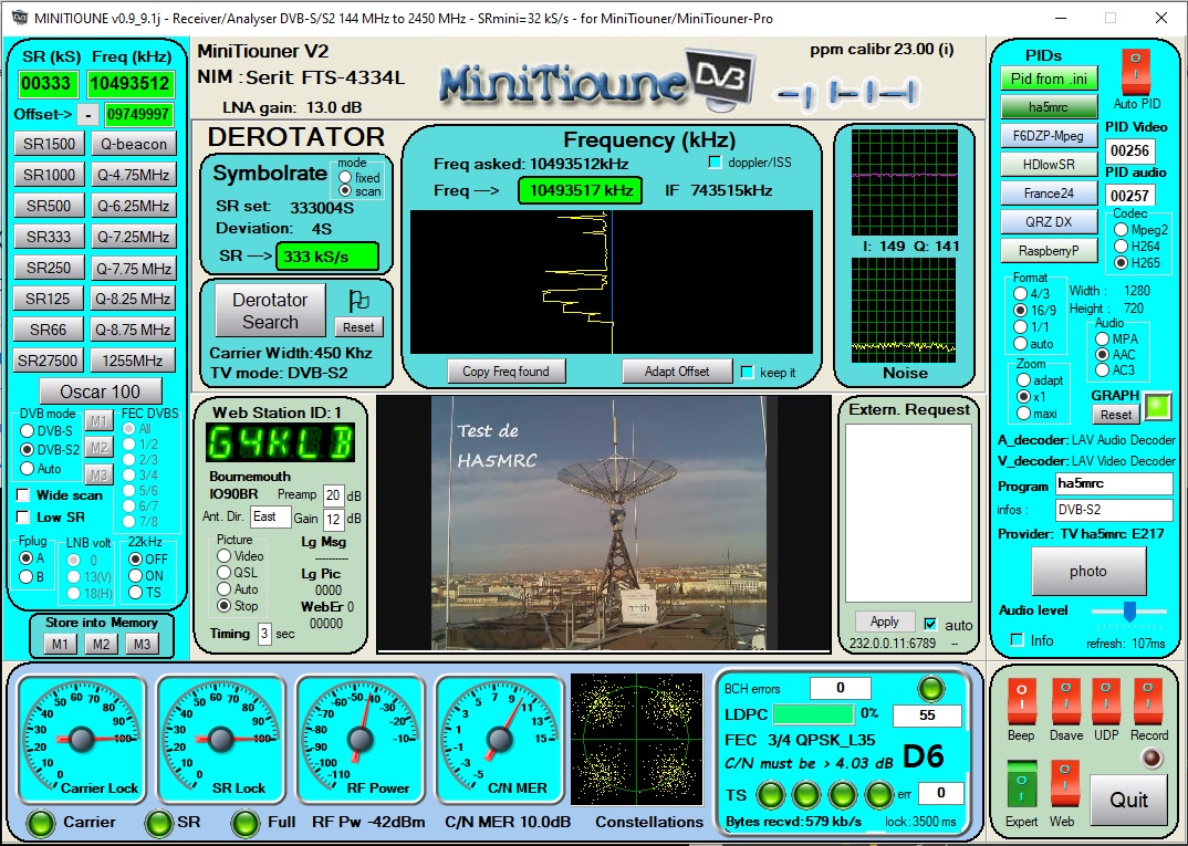

Helm,
I can confirm the ELAD RX does work on Minitioune software with no problems.
The LNB voltage is whatever the supply voltage is, there is no other way to control that. Have tested with a bias tee and that works fine on QO100, there must have been a fault on the one you had.
ELAD MT.jpg (409.82 KiB) Viewed 13121 times
Tom

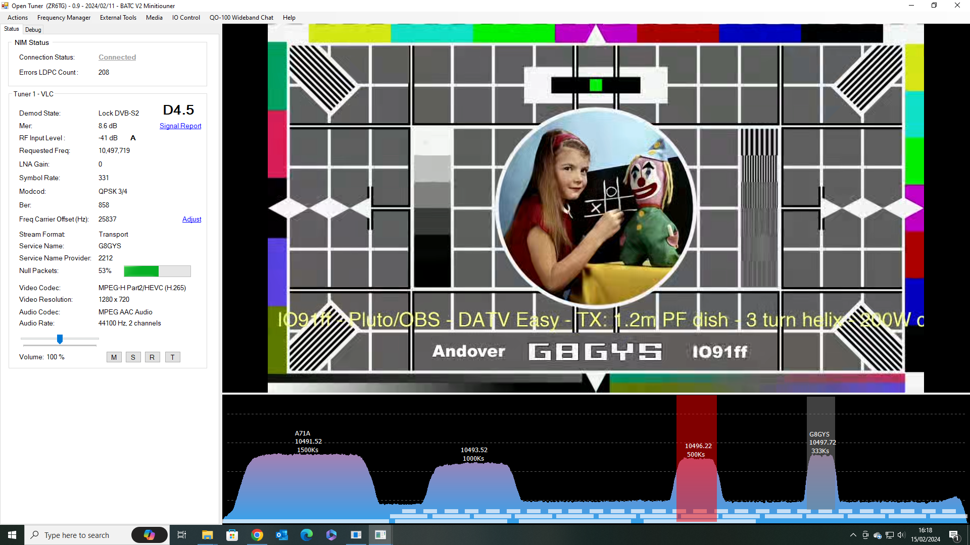

Have tested with open tuner 0.9 and everything works as expected, so no problem there.
Screenshot (85).png (1012.83 KiB) Viewed 13127 times
