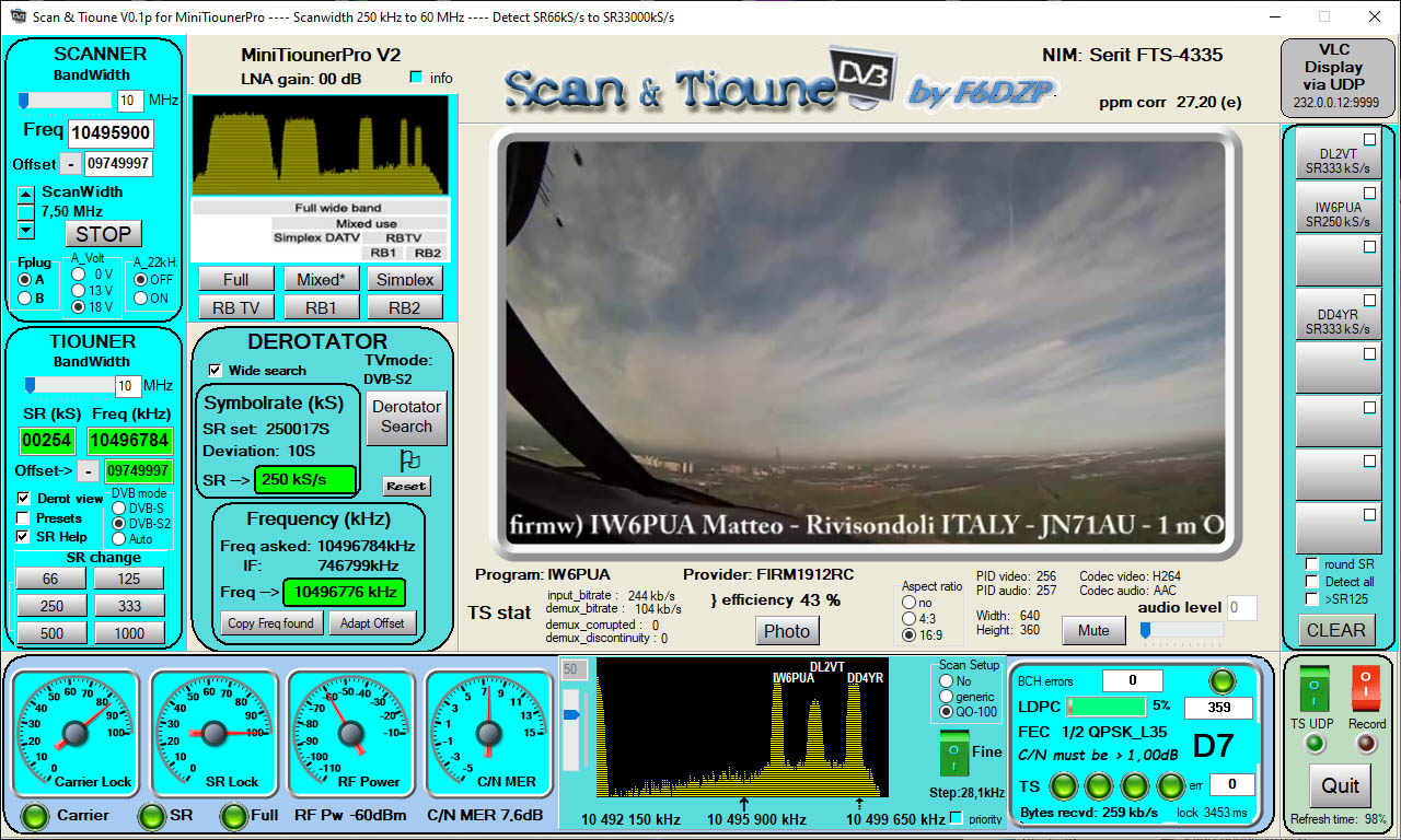

Scan&Tioune is available for download. (and the last version of Minitioune)

Initially it wouldn’t run for me, then I noticed that it needed the 32bit version of VLC. My system only had the 64 bit version. Once that was installed all was OK.
On first use it seems to be working well for me.
Scanning is reasonably quick if the ‘priority’ tick box is selected.
It will be interesting to see how it performs on this weeks BATC net. As it is using VLC for the display it will be interesting to see how well it copes with multiple short transmissions.

Hello Jean-Pierre,
I've tested your new software and i'm impressed.
thank you for your effort and time to make this possible.
Can I suggest A couple of options to add to use it fully automated:
An option in the config file for auto start scanning at startup ?
option for full, mixed, simplex etc in the config file ?
In detect all mode: if the last signal stops transmitting switch back to the previous, the first signal in full scan is the beacon so this will automatically avoid A black or frozen screen if no new signals appears ?
I now this is only the first version and I understand these things cost time.
If I can help test new functions please let me now.

I found 2 small bugs:
when switching from normal to big screen the scan setup changes from QO-100 to No.
The SR is not always well detected at 333 it detects 250 instead, the mutli quick tuner shows the right SR.
See you on the QO-100 and have fun.
Yes , depending the scan Step you are using and the shape of the spectrum (some signal are more or less pointed) detection can be mixed between SR250 and SR333. For that reason,I have added the SR Help option, that gives you the list of traditional SR, so you can click yourself immediately the good SR when you see at the bottom of the shape that it is a SR333, with habit it goes very quickly.

Also sometimes there is a signal in the scan that is not automatically detected.
Can it be added that a click in the scan window will tune to the frequency even if it has not been detected. Maybe any click that doesn’t hit a label could go to the frequency of the click.
One other thing that would be nice is a highlight or line on the scan window showing the currently tuned frequency.

There is A little pointer underneath the scan window that shows the position.

The pointer shows the scan progress but it does not show which frequency you are currently receiving and decoding.

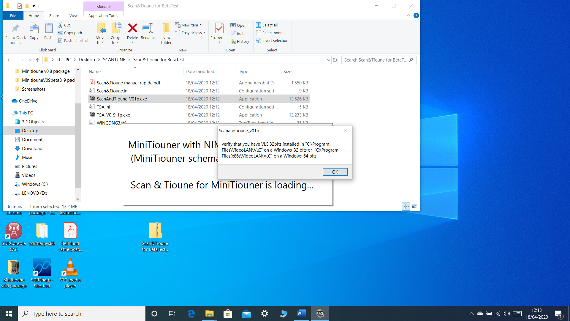

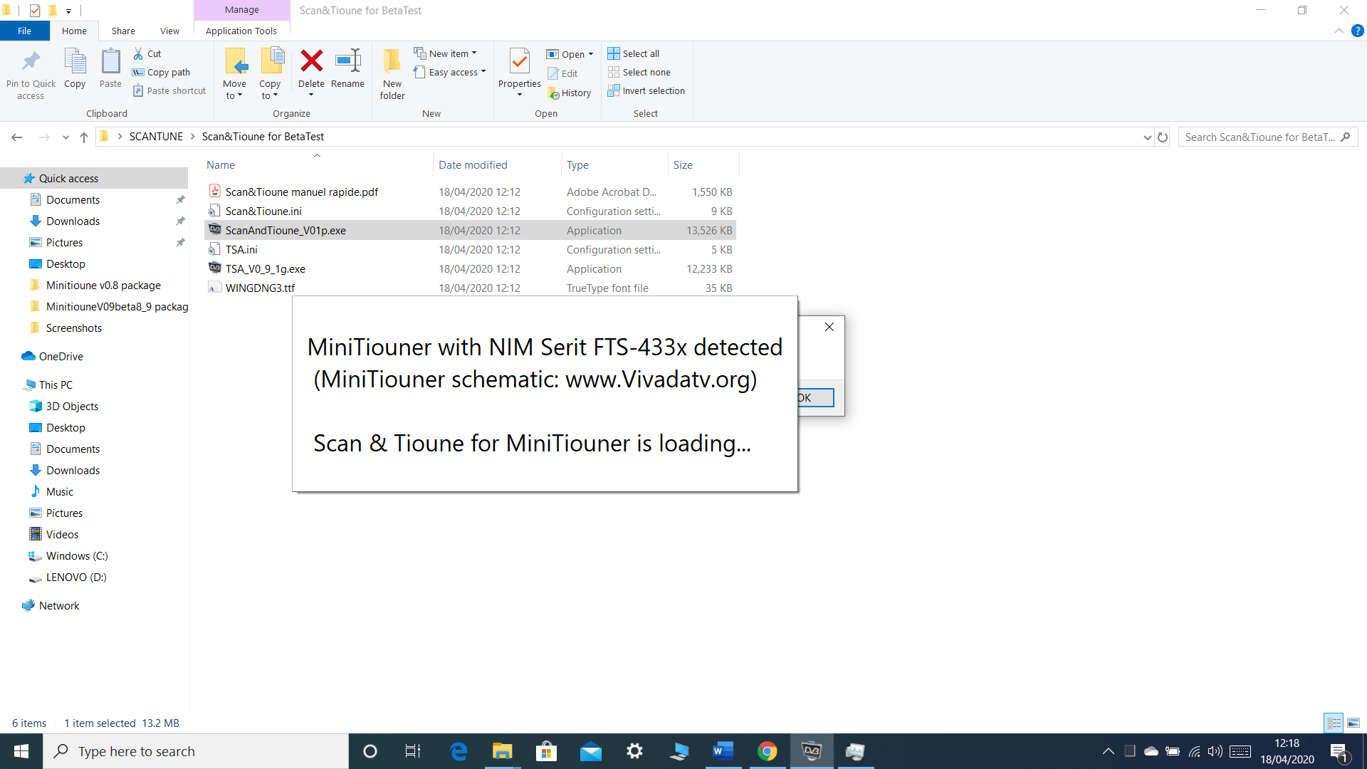

My Mini tune works fine in normal mode and also with the excellent M0DTS program
However I thought that I would try the scan tune as an alternative ..3 days later I still cant get it to work!
I am using Windows 10 64bit machine
I have downloaded program and VLC multiple times
but always end up with the same issue.
I get the 'usual' Minitune is loading page come up and then a box opens underneath the main box and you can just see an OK option
see attached images ..my O level French tells me that something is looking for a registry key?
Clicking OK then takes me to a ..make sure you have VLC loaded OK ...I have the 64bit version loaded which was auto seleted when I download the executable file
