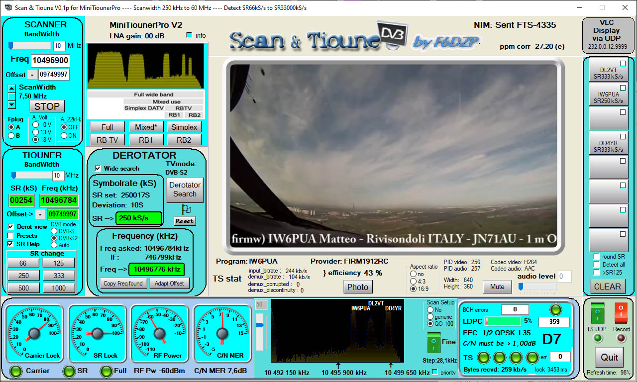

Initially it wouldn’t run for me, then I noticed that it needed the 32bit version of VLC. My system only had the 64 bit version. Once that was installed all was OK.
On first use it seems to be working well for me.
Scanning is reasonably quick if the ‘priority’ tick box is selected.
It will be interesting to see how it performs on this weeks BATC net. As it is using VLC for the display it will be interesting to see how well it copes with multiple short transmissions.

Also sometimes there is a signal in the scan that is not automatically detected.
Can it be added that a click in the scan window will tune to the frequency even if it has not been detected. Maybe any click that doesn’t hit a label could go to the frequency of the click.
One other thing that would be nice is a highlight or line on the scan window showing the currently tuned frequency.

There is A little pointer underneath the scan window that shows the position.

The pointer shows the scan progress but it does not show which frequency you are currently receiving and decoding.

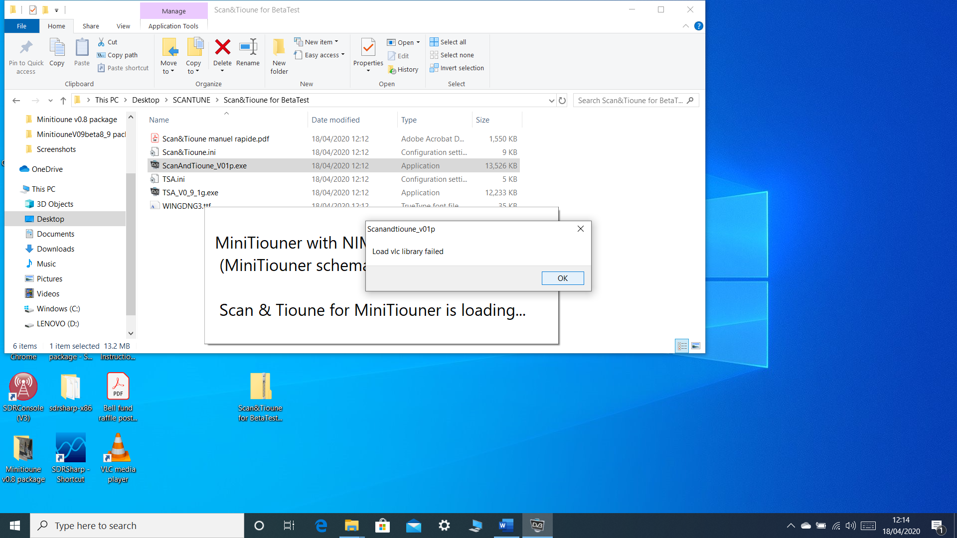

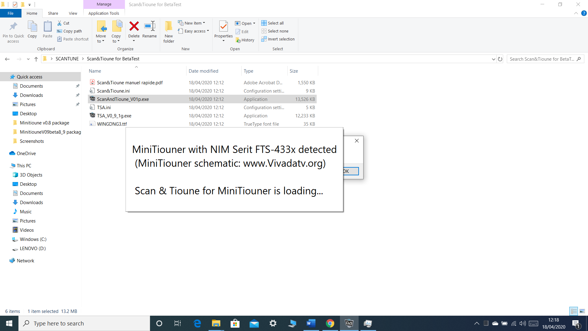

My Mini tune works fine in normal mode and also with the excellent M0DTS program
However I thought that I would try the scan tune as an alternative ..3 days later I still cant get it to work!
I am using Windows 10 64bit machine
I have downloaded program and VLC multiple times
but always end up with the same issue.
I get the 'usual' Minitune is loading page come up and then a box opens underneath the main box and you can just see an OK option
see attached images ..my O level French tells me that something is looking for a registry key?
Clicking OK then takes me to a ..make sure you have VLC loaded OK ...I have the 64bit version loaded which was auto seleted when I download the executable file
