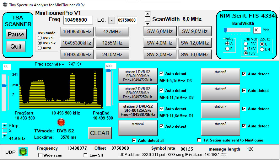

I am finishing TSA.
This scanner uses a MiniTiounerV1 or V2 or Pro ( can be used with a Sharp NIM, so keep your old MiniTiouner V1).
It can scan QO-100 and detect stations giving the SR, frequency and also the DVBmode (DVB-S or DVB-S2) the fec, the modulation (QPSk, 8PSK ..) , the MER and final report D0 ... D5 .... so your can click on a button when you are sure to receive it.
I think I will add the call sign of each station, so you will also know who you ask to receive.
When you click on a button, message including all information can set Minitioune on the good freq, SR, DVBmode...
TSA_QO100_scanBandwidth 6MHz right of Beacon detect 3 stations.jpg (160.79 KiB) Viewed 7342 times

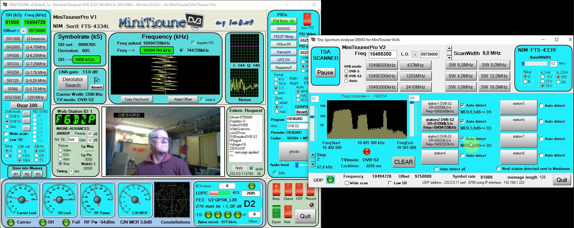

both softwares working together:
youtube: https://youtu.be/51Sid2Jkulo

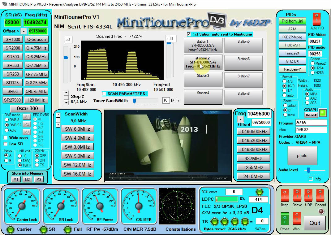

For the future, a new software called "MinitiounePro" will have the scanner included. (CTRL S show you the scanner instead of Derotator scan)
MinitiounePro receiving Beacon and scanning9MHz _beacon and 1 new station.jpg
MinitiounePro receiving Beacon and scanning9MHz _beacon and 1 new station.jpg (265.56 KiB) Viewed 7342 times
demo on youtube https://youtu.be/LLzk6gdkDGg
