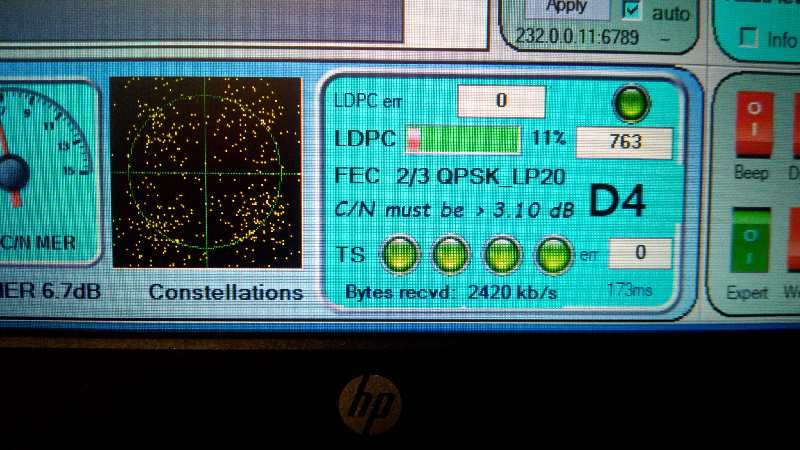

Photo of Minitiouner software on laptop tuned to Oscar100 beacon
Please keep in mind it was working fine on laptop & Portsdown with latest software. Now it just shows all Green LEDs as per photo but no video.
Hope this let's you see the problem better.
By the way MER is normally better but there was very heavy rain at time of photo.

by g0mjw
From the photo it is working fine. If you are not getting video check you have the right codecs - instructions in the readme file - I am not sure everything is included in V9 to check from V8
