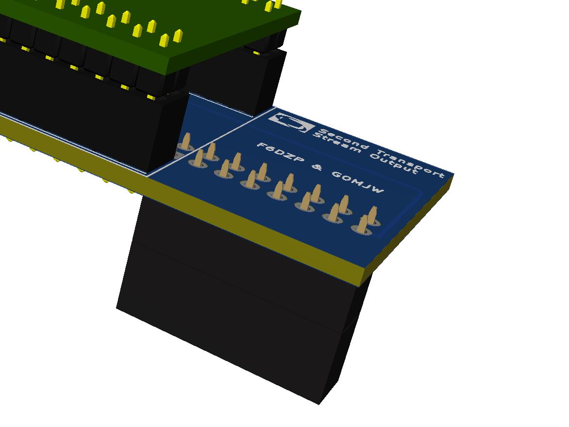

I assume you mean this
I went for this item SAM11093-ND but you can choose others.
Height clearance is important and a large fuse holder or a tall capacitor might be a problem. This is a plug-in that was not envisaged at the time the V2 board was designed.
