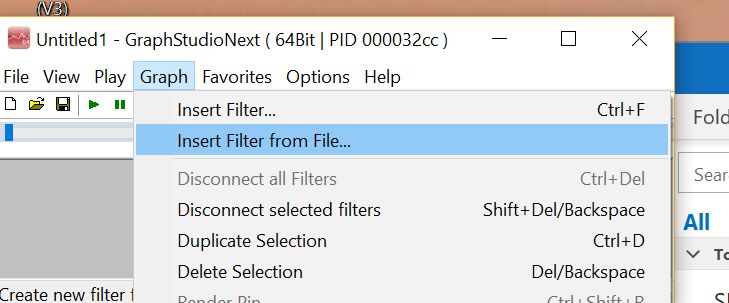

I am looking in GraphStudio and I cannot find how to insert filter from file. I have reviewed the BATC document (at least a hundred times) and I can't find it not there either. I have used the "install_user)ax)winXP)Win10.exe" utility to update the registry ....

Graph->Insert Filter From File

I found that setting but the file requires a CLSID which I do not have.
What I did was to do the procedure in the Read Me which was to Graph > Insert Filter, click "Register" and then select user.ax. After which I rebooted my PC but the problem is the same.
