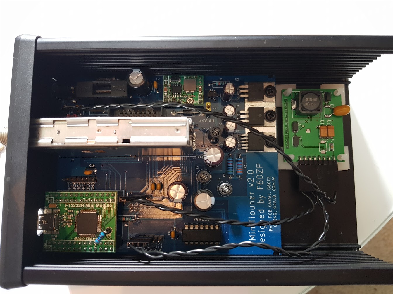

All,
Not been active on here for a few weeks as I have been quite unwell, I decided to try and do something productive today and finished off something I wanted to do to the Minitiouner V2. I have a longterm illness that rears its head on occasions and puts me out of action for some time, needless to say I've not been in work the past few weeks.
I enquired about a PCB from Pierre F5XG as I saw he had used the RT5047 himself on his own version of the Minitiouner, Pierre was very helpful and sold me a couple of boards.
I ordered a large number of RT5047 from Richtek directly and pieced together all the other components needed.
I fitted all the parts and set about making a loom earlier, I will document this later on if anyone is interested, with board locations and diagrams no soldering is required on the BATC V2 board and all connections are accessible from the headers already on the board.
I decided to connect this up so LNB A is powered from the RT5047 and LNB B is unpowered (Or switched from front panel to output the same as the incoming voltage)
I've made a short video to demonstrate how this works and attached a picture of it installed in my BATC Minitiouner V2, please note that although I have used a Hammond enclosure, I went for a slightly longer one as I wanted space to add other boards later on, though this type of board can be easily fixed to one of the front or rear panels internally.
Diode D4 is not populated on my picture, it is a voltage surge protection diode to protect the board from external excess voltage that may come down the coax, I didn't have one to hand and will fit something suitable later on.
The latest Minitiouner Beta supports this and requires a simple change in the ini file to enable this board.
Also, I have a number of RT5047 IC's available, if anyone would like to design a BATC board for the Minitiouner V2 please contact me and I will send you some IC's for design and testing. In addition to a single RT5047 based design a Twin RT5047 board would enable both Tuner Inputs to be controlled independently.

- 20190617_134846.jpg (256.03 KiB) Viewed 9603 times

Thank you, It can last a few weeks and is quite debilitating but I am starting to get a bit better now, I suffer with migraines with a form of vertigo and balance issues, so makes it very difficult to do anything, fortunately I'm getting a bit better and started on some new medication so just need to have very little stress in my life.
I did not create a PCB, I'm hoping someone here may want to do one for the BATC shop, if that does not happen I might design one if I am well enough,
I bought the blank PCB from Pierre (F5XG) if you want one urgently it might be worth asking him if he has any more left for sale.

Hi John, the evaluation board is a bit different as they are using pull up resistors to enable different voltages and modes, in our use it's actually a much more simple circuit.M0IVJ wrote: ↑Tue Jun 18, 2019 12:58 pmThanks Dale, this would nicely finish my Minitiouner.

There are various schematics in the datasheet for the RT5047 which show how simple the circuit is, that's not to say you can't still use pullup resistors if you want front panel operation instead of software, or if you add a second RT5047 board and wish to use that with front panel buttons, the 22KHz tone will need to be generated if needed however.

Yes I am already using this on your Software with my Minitiouner (You can see this on my video), it works perfectly and also 22KHz, I will create a document on how to make a plug in loom/diagram for the V2 as I have done in my pictures.
