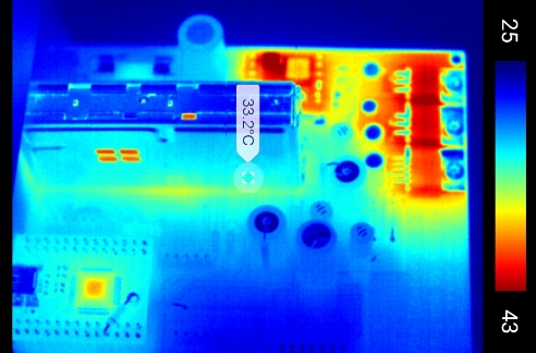

on the picture you can see the hot spots around the regulator, the NIM is about 33°C.
Reinhard
Reinhard

Nice thermal image. Might try that mtself. Unfortunately may not be accurate on the nim as the emmissivity of the metal can will be low - the true NIM temp in your image is nearer to top scale from what you see through the holes, but it's a whopping 43C. I don't think we will have to call out the fire brigade.

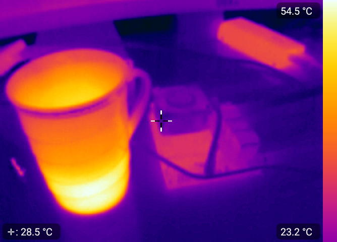

Meanwhile here is a nano and a cup of tepid coffee for comparison. Mike
