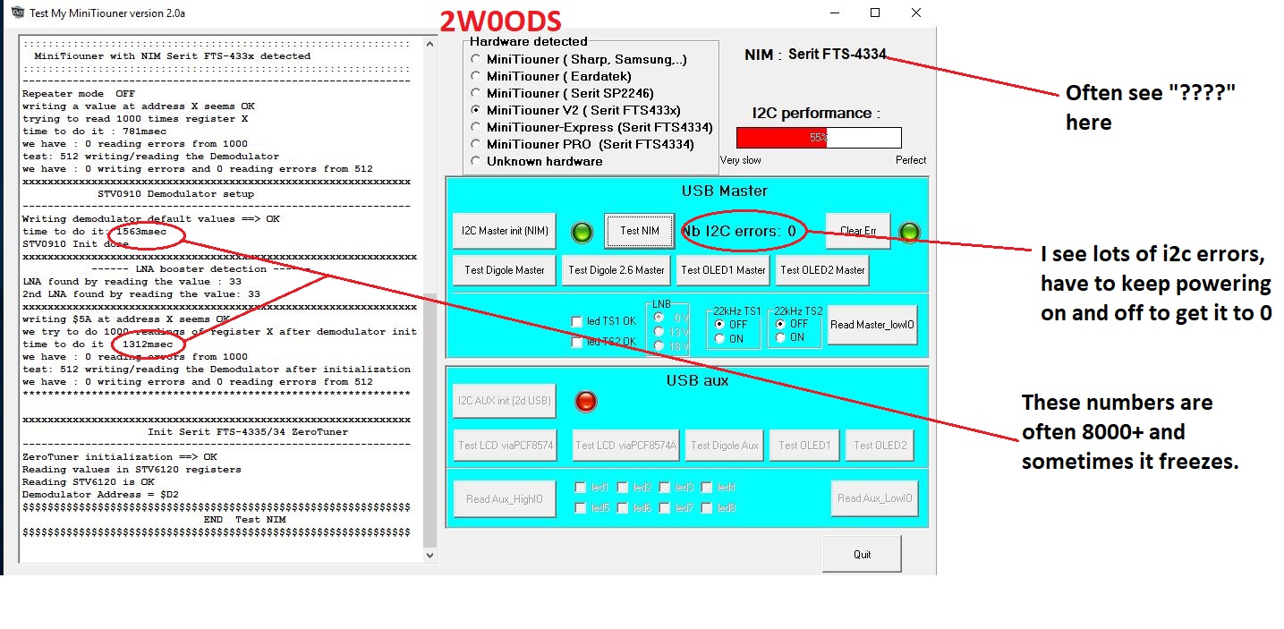

I took the unit to GW8MER's as he has an identical build, we powered mine up and it took a few attempts to get it to work with the MiniTioune software and Test My Minitiouner. Each attempt with the test software either froze, threw an error up or had dismal i2c performance.
We had a DATV express transmitting and ran the Minitioune software, the update for the information was very slow and I was also getting poor signal readings etc. And it would just consistently freeze.

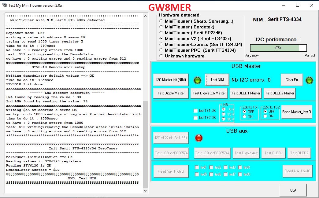

During the testing of Mikes unit his i2c performance was hitting high 80's and as the DATV express was running we tuned in to that, things were much more stable and much betting signal readings and no freezing etc.

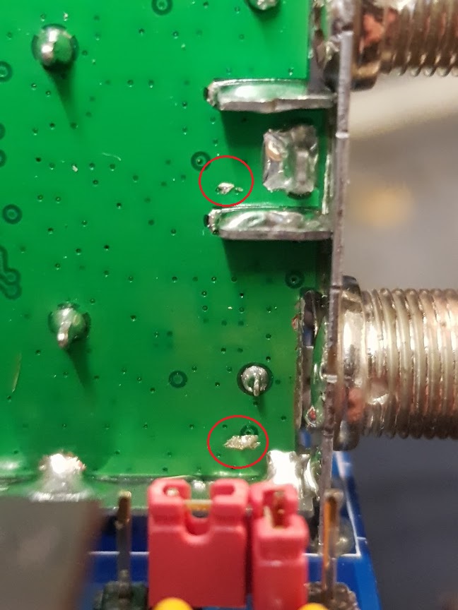

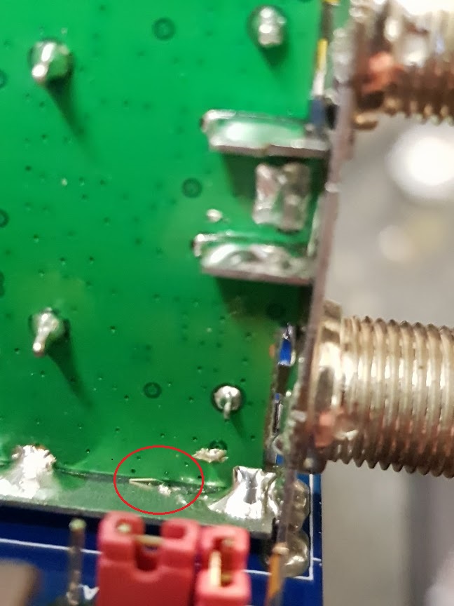

However when I looked at the rear of the Serit NIM, I could see some shiny blobs of metal, I looked more closely under a magnifying glass and found that the pins were bridged on the left hand side and a few via's had metal stuck all over the back of the board, I flicked the metal off the bridged pins and put it on the bench, I then put the soldering iron on it and it melted. Something had gone wrong in manufacture and the whole Serit NIM had stray bits of solder inside. I can see the F's are hand soldered so can only assume its happened at that stage as its mostly SMD and not wave soldered.
Sadly removing the stray bits of solder and the bridge didn't solve these issues, but the tuner does now run cooler! It seems the issue in manufacture had already caused damage to the unit.
I have attached pictures, one shows the footprint of where the solder was bridging the pins.

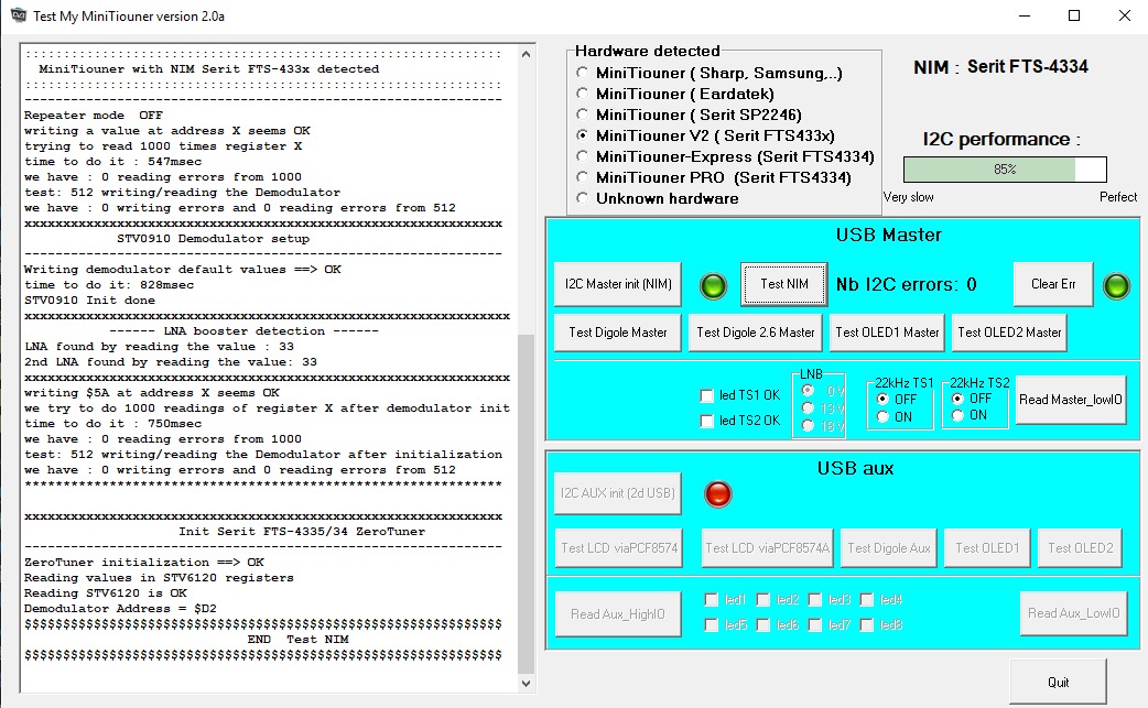

Big thank you to Noel for replacing my faulty NIM just had 5 minutes to fit the replacement and it's all working perfectly.
My I2C score has shot right up too
