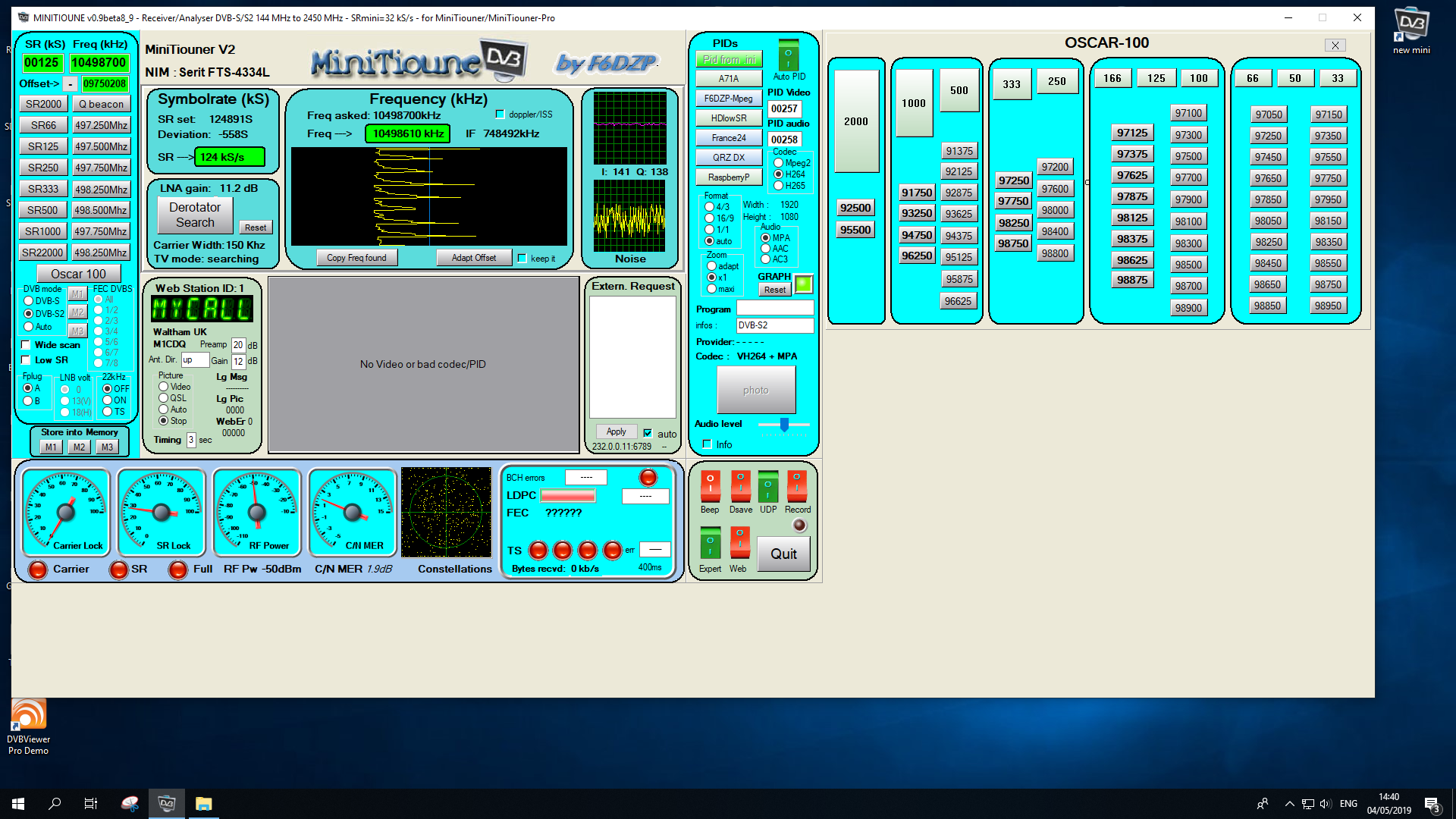

I like the oscar 100 button
I dragged the window wider and moved the box over
Screenshot (13).png (480.2 KiB) Viewed 12657 times

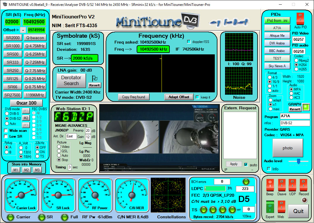

I have been testing Minitioune v0.9beta8_9 with a Serit NIM. All good, except one minor issue:
When receiving H265 720p (1280x720 pixels) is displays that the received image is 1280x960 and sizes it for 4:3 in the viewing window. If I send the stream to VLC it correctly detects 1280x720 and displays at 16:9.
The transmitted signal comes from GStreamer piped through ffmpeg (to add service metadata), and ffmpeg reports that it is sending 1280x720.
It may be that some vital metadata is missing on this H265 stream, or it may be the MiniTioune/Windows 10 combination. Has anyone else seen this behaviour? It happens that same at 720x406 (detects as 720x540), but 1920x1080 is detected and displayed correctly.
