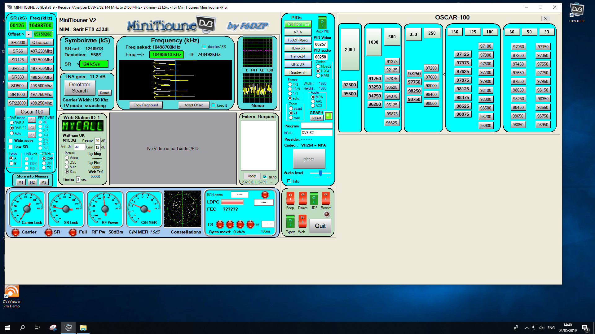

I like the oscar 100 button
I dragged the window wider and moved the box over

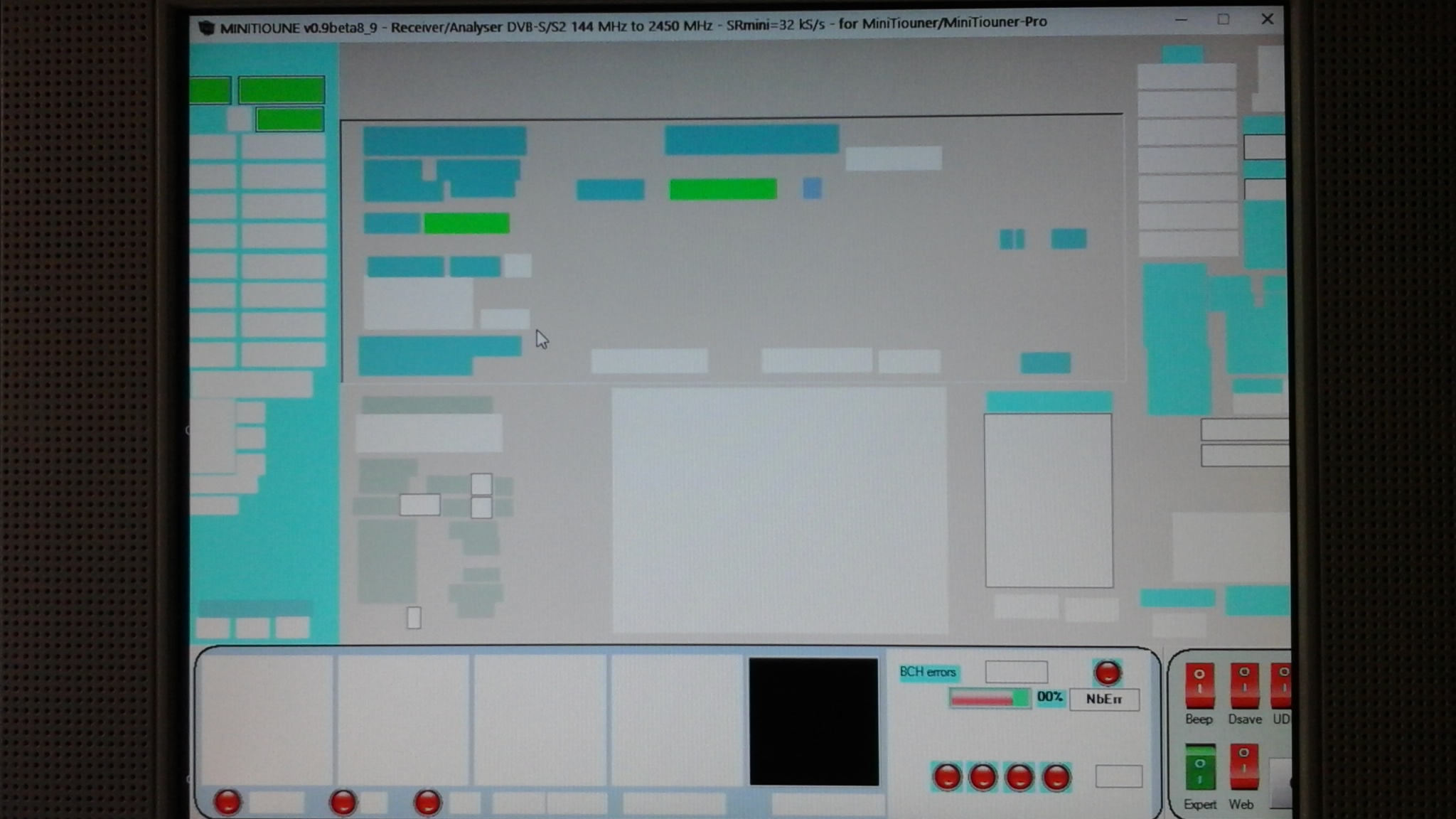

Tried v9 beta 7
Unable to see D number but ok on expert page
Probably need a wider monitor.
Tried v9 beta 8-9 no good
I need a new computer and monitor.
I think the attached pictures may have come out in wrong order.
Roger G8HKN
Roger G8HKN
