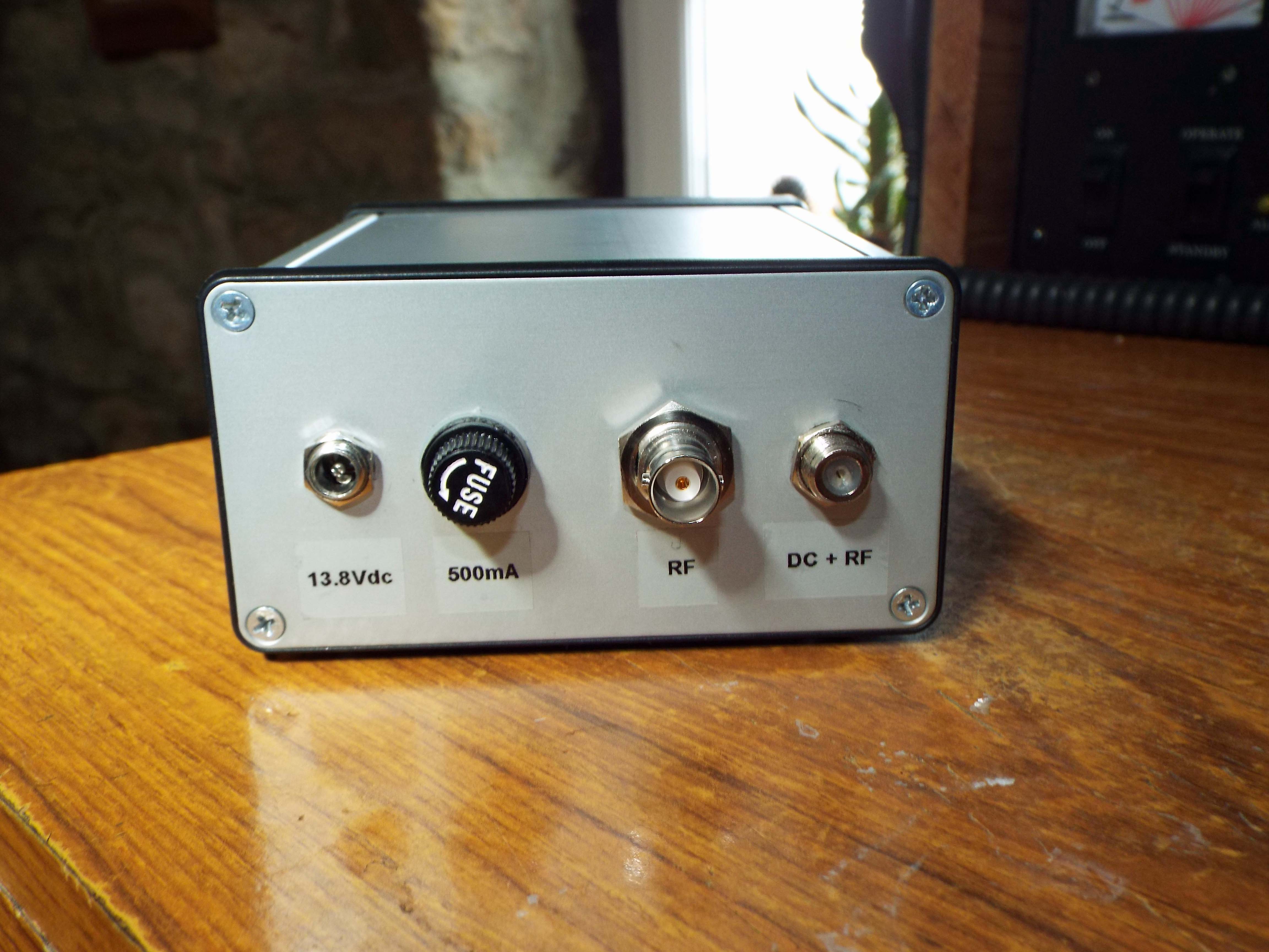

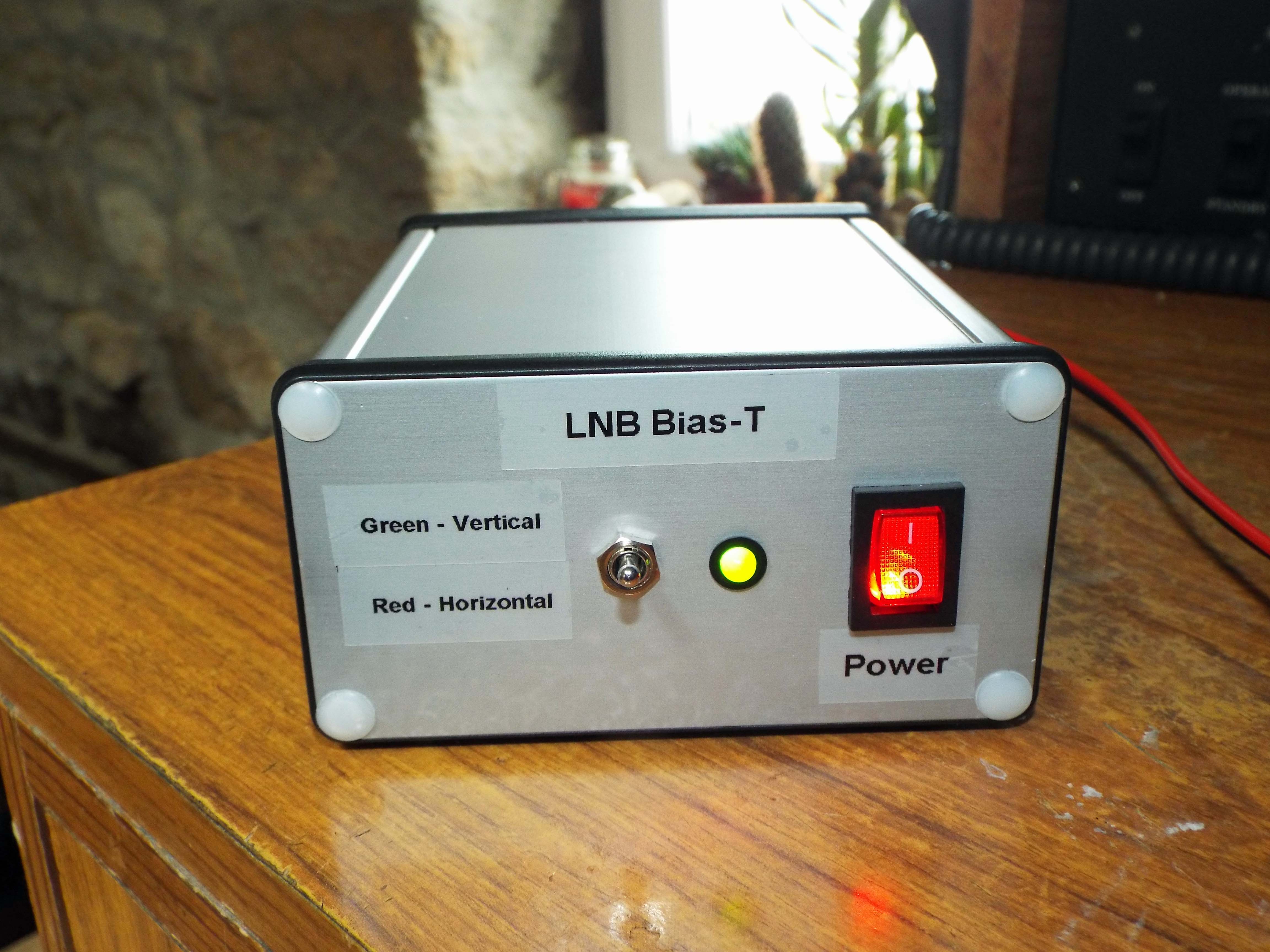

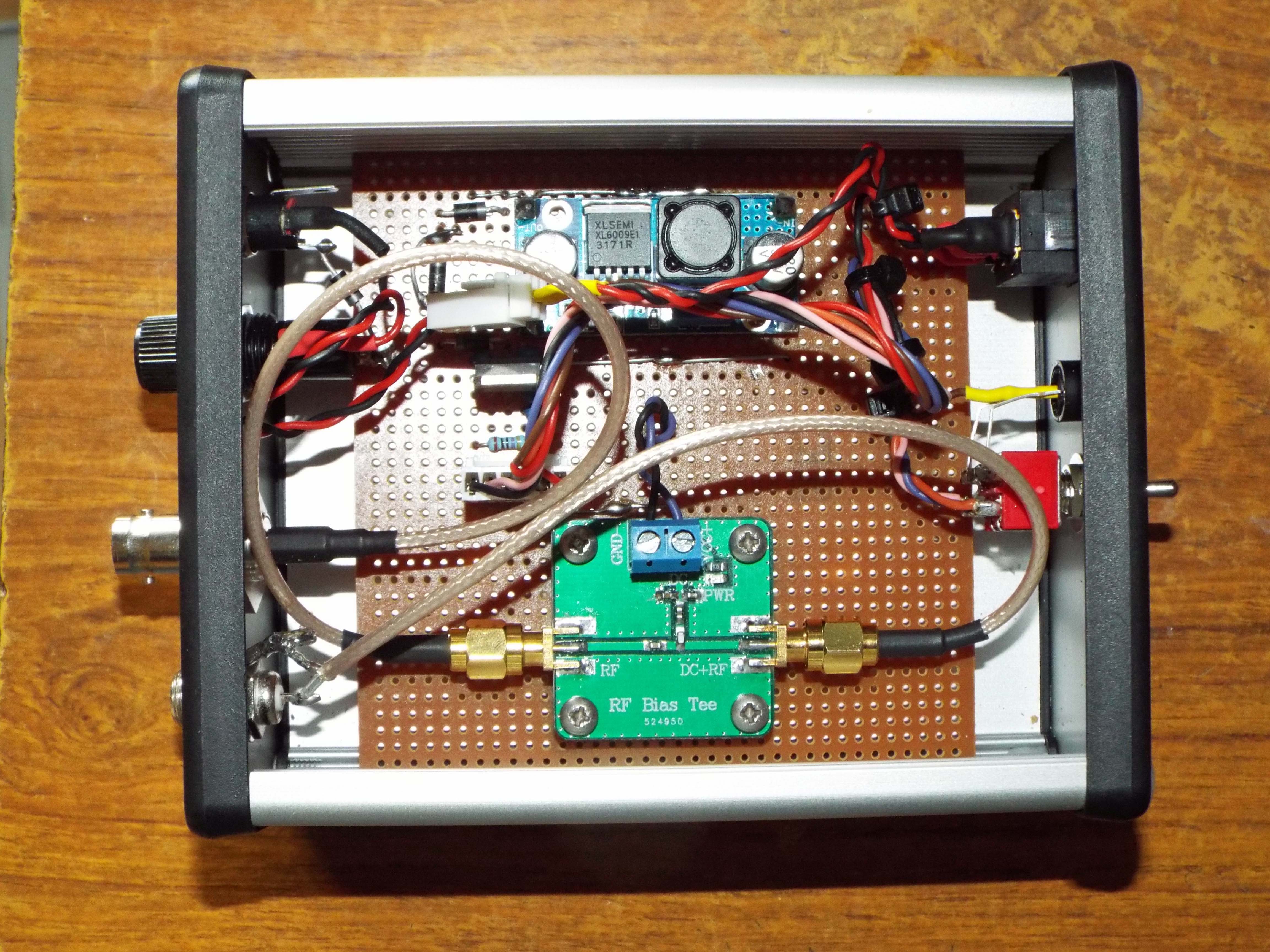

I just use a E-Bay buck converter to get the 18V. The 18V output is fed to a 12V regulator with didoes in the common connection to get the voltage to 13V. The Bias-T itself was obtained from E-Bay.
Nick - G4NKV
Bias-T Inside.
Bias-T Inside.
Bias-T 1.jpg (1.19 MiB) Viewed 11098 times
Bias- T Front.
Bias- T Front.
Bias-T 2.jpg (904.67 KiB) Viewed 11098 times
Bias-T Rear.
Bias-T Rear.
Bias-T 3.jpg (739.14 KiB) Viewed 11098 times
