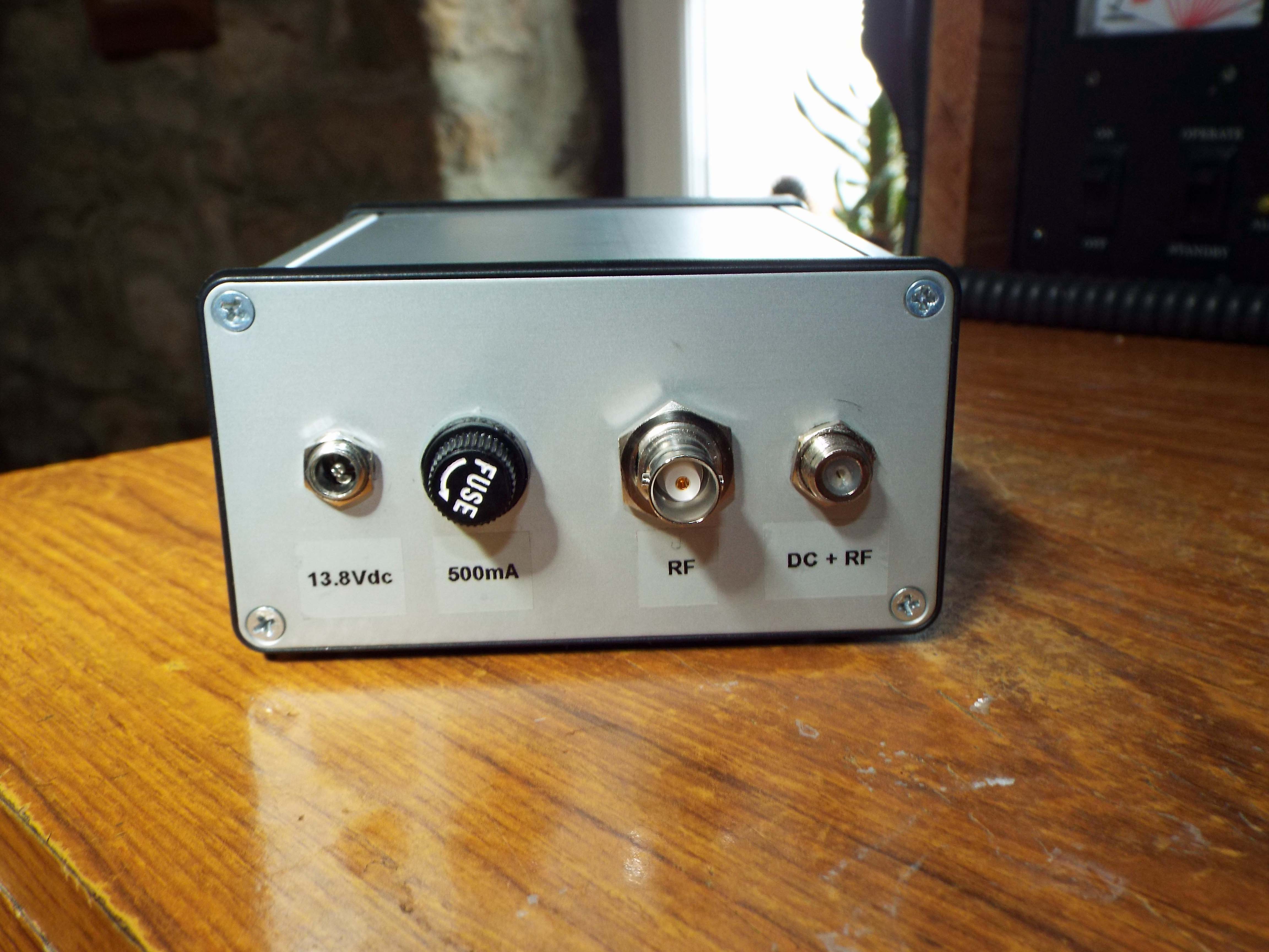

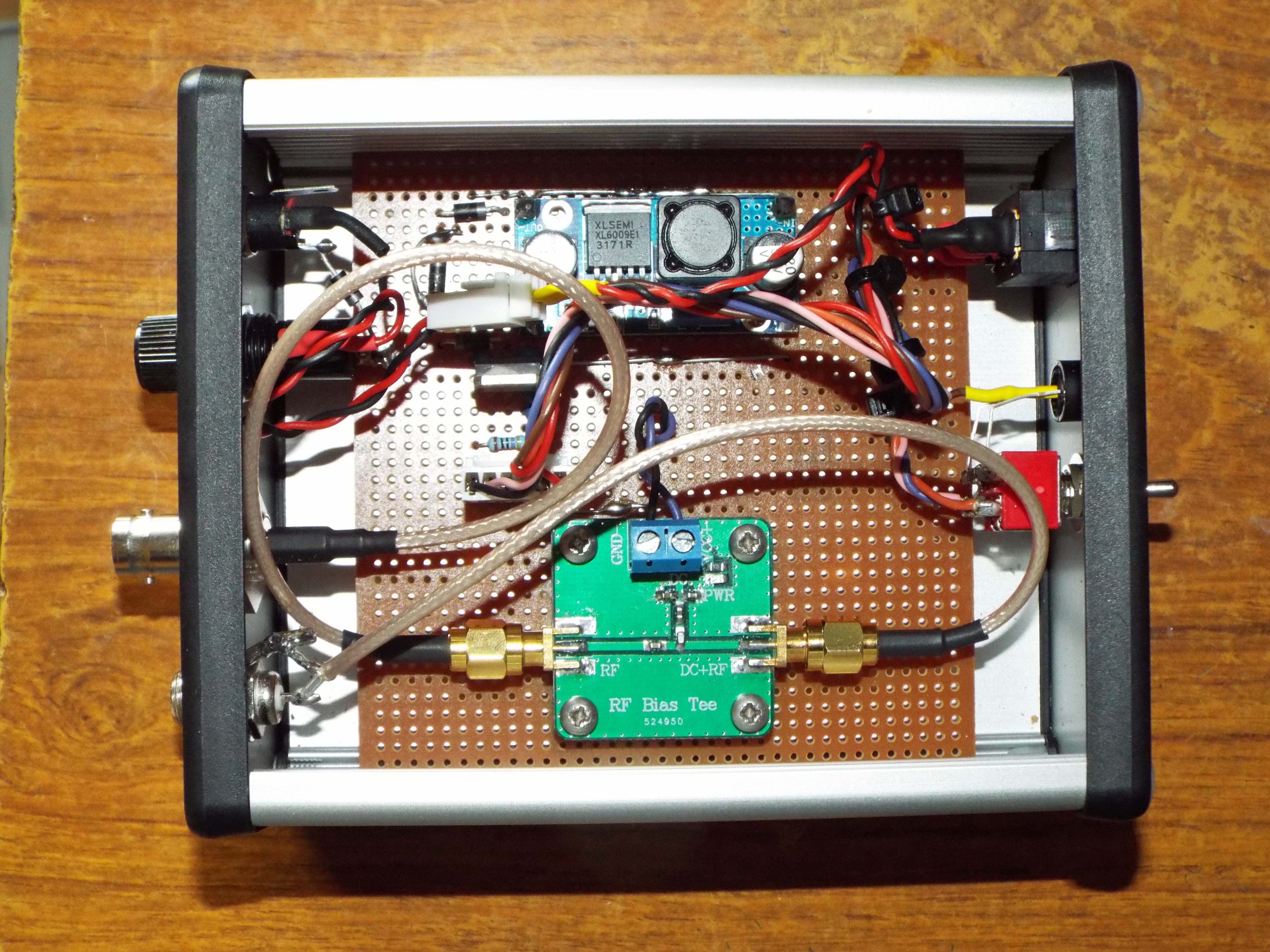

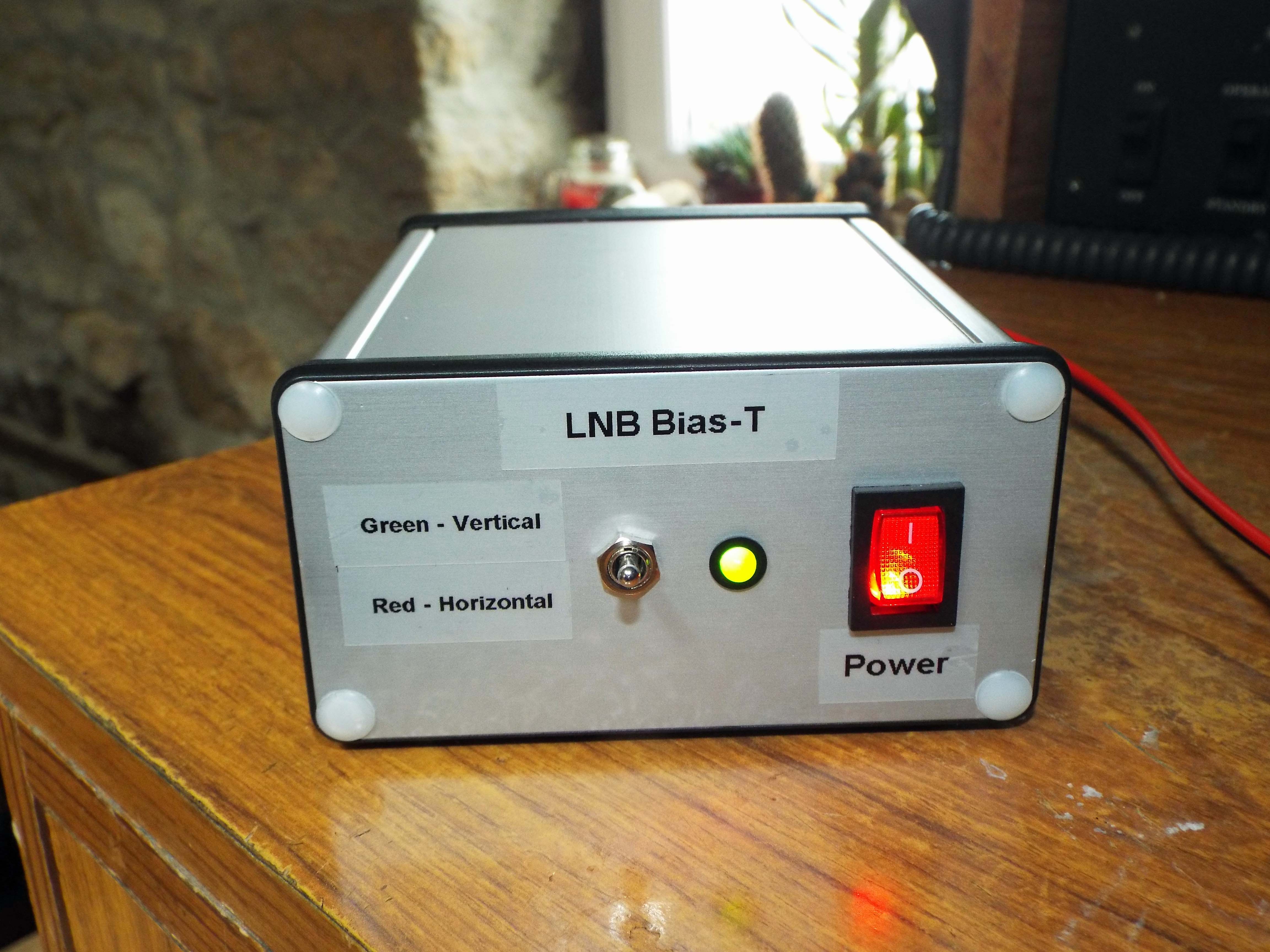

I just use a E-Bay buck converter to get the 18V. The 18V output is fed to a 12V regulator with didoes in the common connection to get the voltage to 13V. The Bias-T itself was obtained from E-Bay.
Nick - G4NKV
Nick - G4NKV
