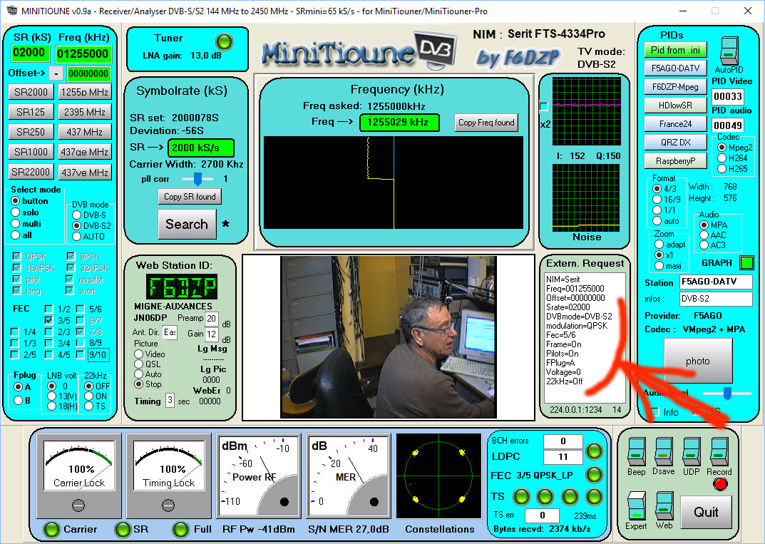

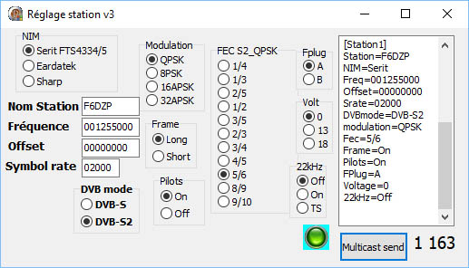

Next version already has a remote control via IP
minitiouneV0.9 test.jpg (337.73 KiB) Viewed 5784 times
Minitiouning Multicast sender.jpg (74.56 KiB) Viewed 5784 times
Jean-Pierre F6DZP
