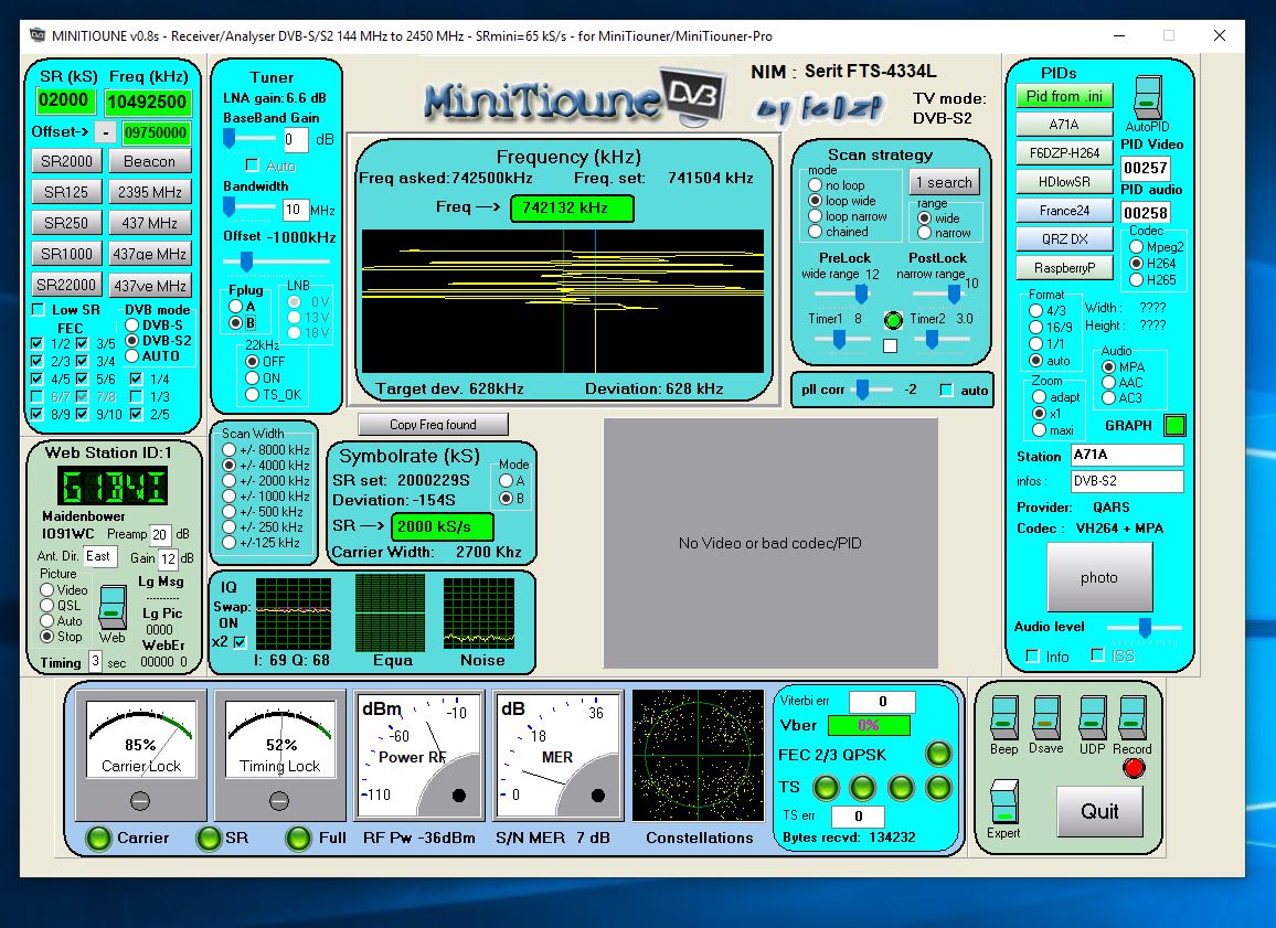

Re: miniTiouner crashes
Well I have finally got my dish alligned and all last night the beacon was being received on my MiniTiouner.
Today I tried again and was going to try and resolve some real broadcasts but I cannot even see the beacon.
Everything else looks normal to me.
I then thought maybe it was the offset that might need tweaking but every time I try and change it Mini Yiouner locks up.
The pnly way of closing it is through device manager.
I have set the first preset to start the program in beacon mode.
I sometimes get a second of audio but no image.
I am using an USB cable from Lindy.
Thought there might be a log created but cannot see one.
Running out of ideas.
Hope someone might have a clue.
Thanks in advance
Looks fine - codec problem I assume. Windows 10?
If you have this kind of problem trying to receive the beacon, I don't think it comes from win10 codec, another codec could give same result.
If the problem comes just when you try to decode the video:
1) do you have observed the %CPU ? one reason with your trouble could be you are using 80% CPU before rendering and when Minitioune try to render the % CPU begin to be too high and you have a crash.
2) don't use "autoPID" to prevent Minitioune to render the video, and press UDP button and start VLC receiving the UDP stream to see if VLC can render the video. ( observe also the % CPU)
if this problem comes at different time:
3) as I said 99% of crashes come from the USB link. not only the physical cable or plug, but also the strange result we can have using different no linear power supply.
For instance, I have seen that most of little 5v power supply for RaspberryPi gives a floating 100v on the "earth" side. Perhaps the power supply you are using for your MiniTiouner has this kind of result. sometimes when I plug something else to my PC, I hear a "ding dong" given by Windows, that shows me that during 1 or 2 ms the MiniTiouner USB link has been interrupted by the fact we have some change between "floating" voltage given by different hardware used in your environment.
try classic old linear power supply, perhaps that will solve your strange issue.
Jean-Pierre F6DZP
