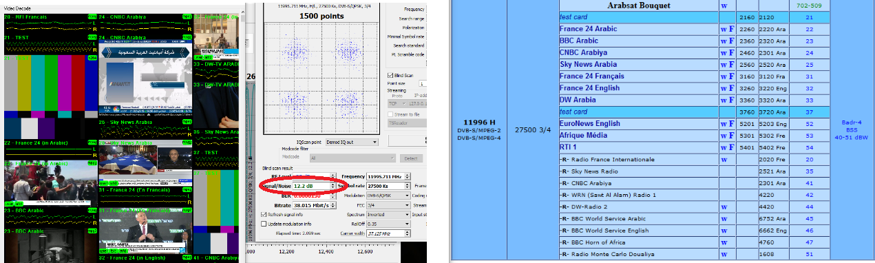

Hi maybe not but if you have a minitoune its not worth looking in to, unsure what your doing wrong with crazyscan it works great if your dish and skew is out it will give errors, 1,2 dish should be fine most of the time good luck with the alignment here is a frequency with my DB from 26E from my 1,2 dish give you something to aim for when aligning.

Thanks, no problem at all with the usual transponders at 26E. I have found when using CrazyCat within SmartDVB that it occasionally locks onto the wrong feed when scanning on particular frequencies, presumably it locks onto the strongest found nearby to the target frequency, as it appears to be in blindscan mode permanently.
