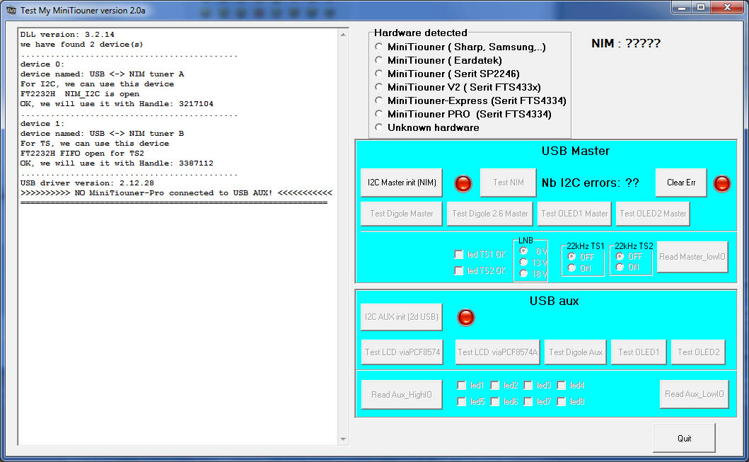

It is difficult to answer. We more details.
Could you show what "TestMyMinitiouner" indicates when it starts? or the screenshot.
You should have something like that, just when the software starts:
starting TestMyMiniTiounerv2.0a.jpg (171.39 KiB) Viewed 6003 times
