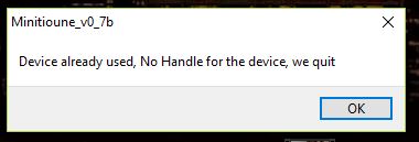

Sometimes no problems, Mitioune starts very well, sometimes I have a message of several instances while I have only one (it is not a problem of double click! I specify)

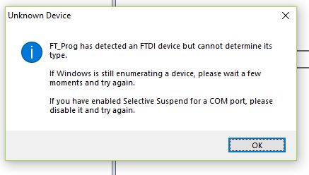

However, I noticed, when I run FT_prog on my Minitiouner V2, I have a warning message about USB selective Suspend for a COM port , this option is however desable.

- error handle.JPG (15.7 KiB) Viewed 8606 times
- fdti error.JPG (26.67 KiB) Viewed 8606 times
