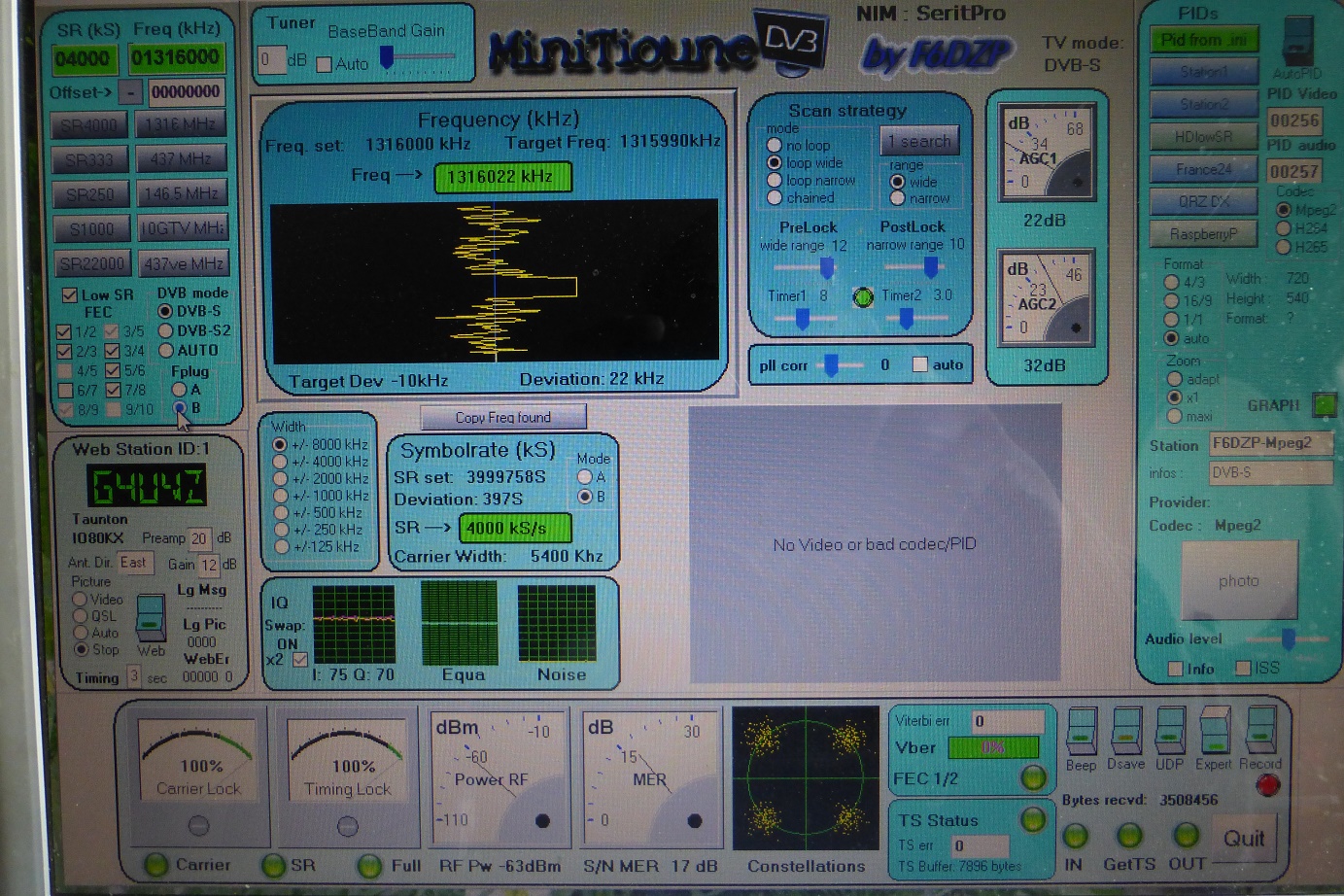

I receive a really good signal from GB3ZZ with an MER of 18+ Sometimes on switch on this results in an instant picture. However over half the time I have to try and wake up the decoding! Sometimes Autopid helps but normally it requires selecting H264 or H265 and then back to Mpeg2 when the picture appears. I thought that I had sorted the issue by powering up the Mini before opening the program but again, sometimes it works, sometimes it doesn't! I am running V.6d and get the same results on a couple of Windows 10 laptops. Is this something which I have to accept or is there a work around?

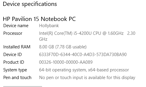

Laptops are Intel Core 15 spec is attached
USB lead is .5 M but have tried others and problem is lead independent
Not sure about USB flavour I would guess that it is the older system as laptop 3 years old

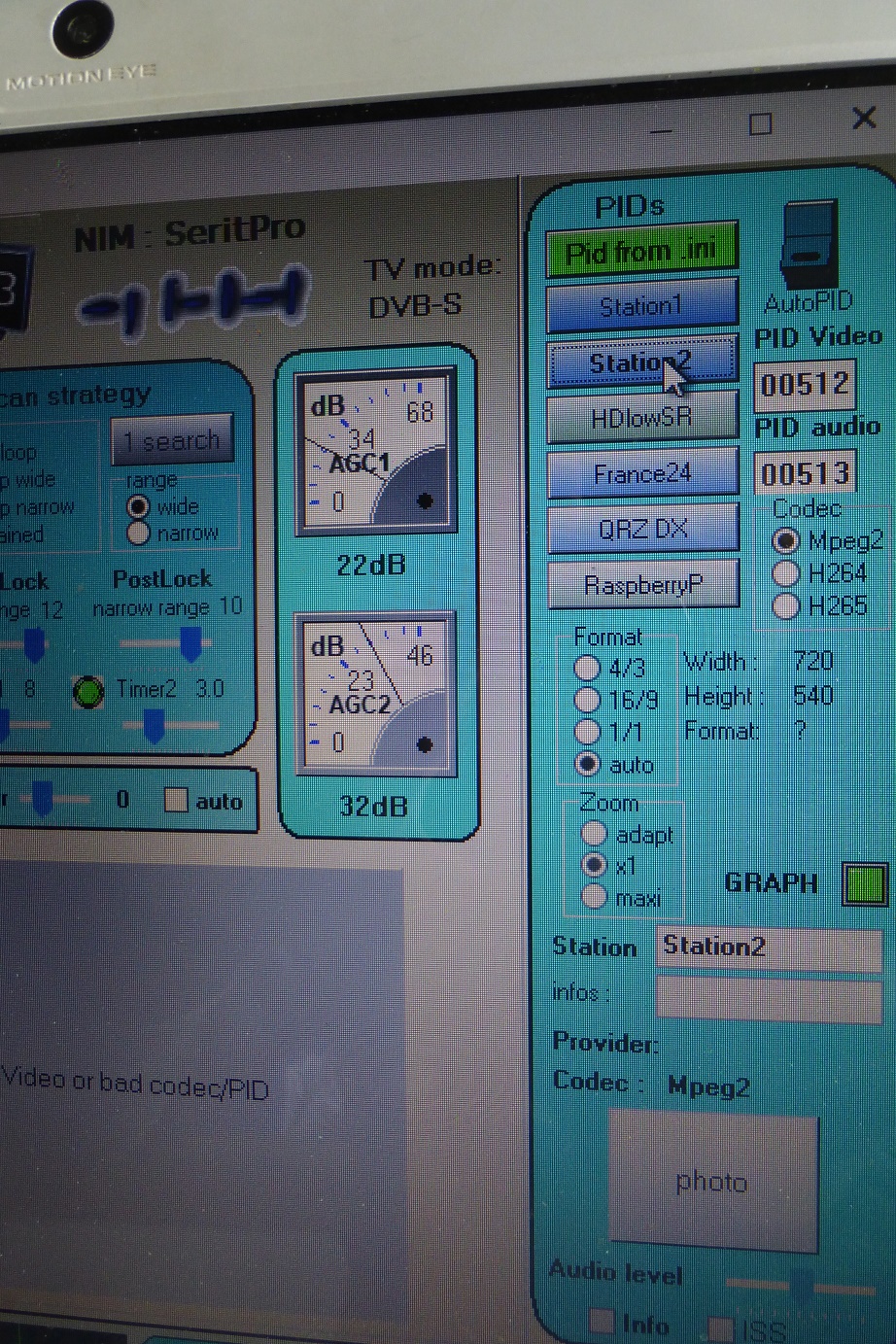

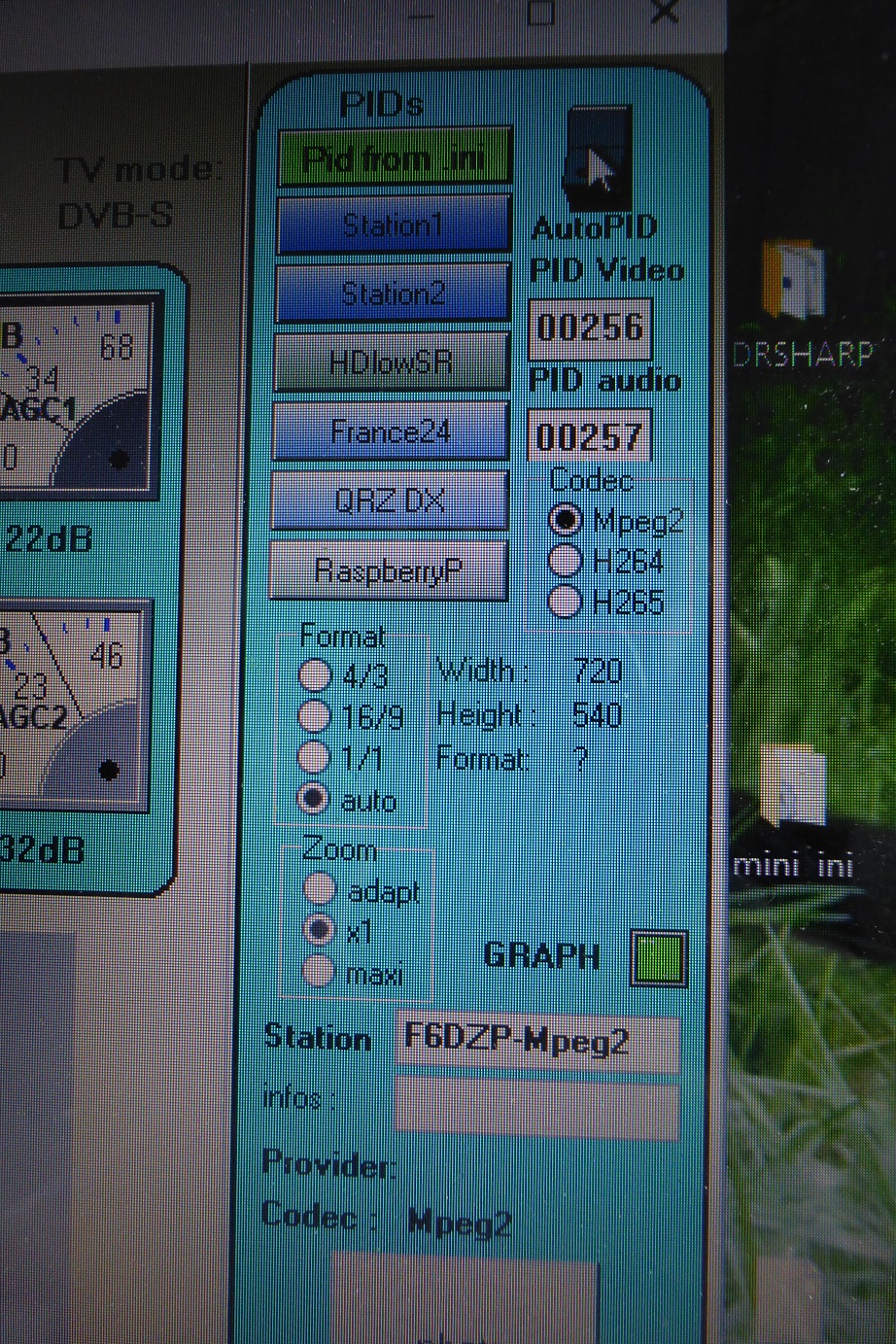

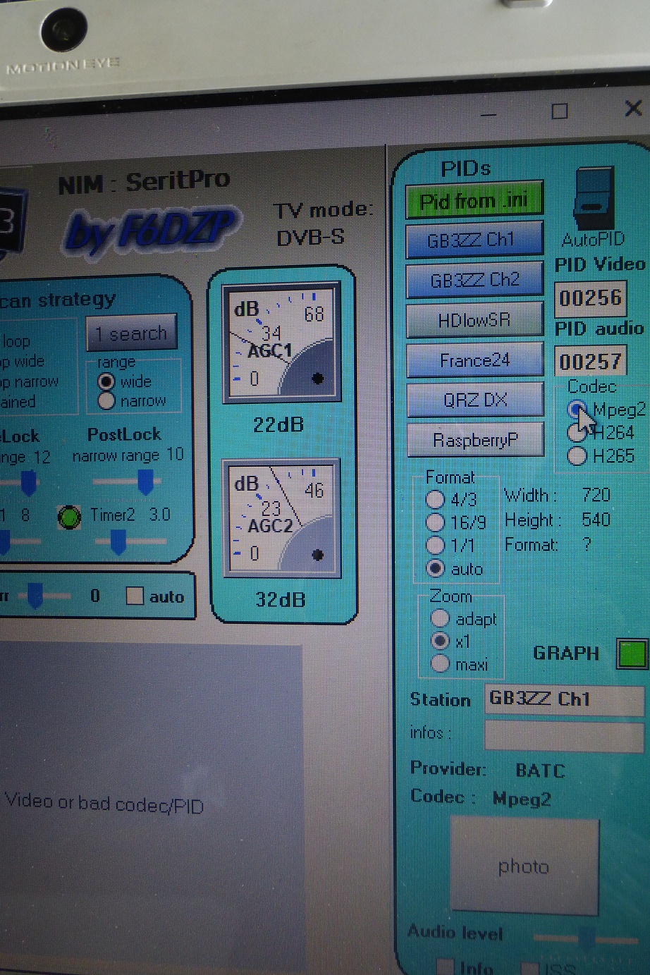

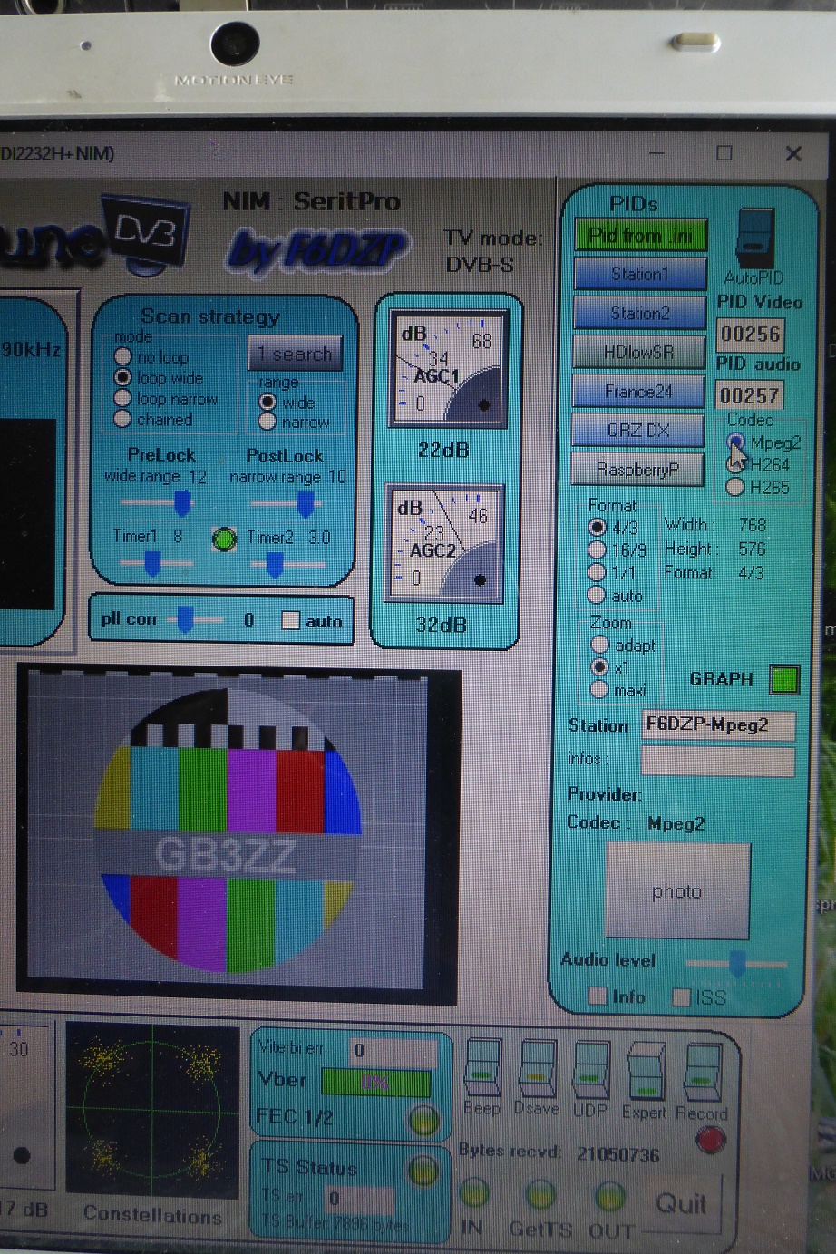

See attached sequence of pictures...as you see sometimes the STATION buttons are populated with the ZZ info other times not ...I thought I had cracked it by deliberately selecting H265 before selecting input B which I use for 23cms...within seconds Mpeg 2 button automatically switched and picture appeared! ..quit program connected and reconnected 12volts to Mini and tried the same again .......NO PICTURE!

yes it is difficult to give quickly a definitive answer.
Sure your PC is powerful enough for this job
I use a Notebook with the same CPU, I can say that, when I lock to a signal, 99% of time I see the video without doing anything.
I suppose that you have first done all the tests with "TestMyMiniTiouner" and "CheckMinitiouneDriverAndFilters" and that result is good.
when you are well locked(= all leds are green),
-a part of the software starts to get the TS from the USB channel, sometimes, on some PC it doesn't always work and on the Minitioune version 0.7 there is way to know it : looking at the "bytes received" number that must be growing(under TS Status or at its right on the V06d).
- when TS is received from the USB channel a second part of the software try to find the DVB tables ( nb of channels , PIDs and codec associated)
it waits some seconds to find the DVB tables and sometimes cannot see all the information during this period so you must write yourself the PIDs or select them with the station button.
- then the TS is sent to a Windows process called a "graph" that will decode and display the video if we indicate to it the good PIDs and codec to use.
Sometimes the graph has some remaining data in its buffer or is in a situation that makes it not starting well, so, by clicking "H264" and going back to "Mpeg2" we force the graph to stop, change the codec and start again in the good way.
If you use the UDP to send the TS to VLC and you see that VLC always decodes the video, your problem is with the graph, We will have to look at the components your PC windows is using, (there are some windows components that do not work well with some graphic card chip/driver, and there are different solutions to force Windows to change the component used).
The last question is about the TS you are receiving, it is composed of 2 channels. I have never tested Minitioune with a 2 channels TS, only with one channel in a DATV signal or many ( 8 to 12) channels receiving a public broadcast satellite transponder.
Perhaps there is a specific situation in this 2 channels Ts that I have not well thought?
The best way to know it : Could you send me 10 or 15 sec of this TS recorded with Minitioune ? (f6dzp at yahoo.fr)
( use a dropbox if it is too large for your mailbox or upload it to vivadatv forum). Thanks.
