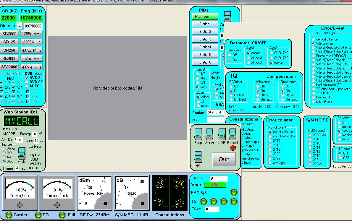

Hi all
Also struggling to get an image and audio.
I followed the instructions but get no video or bad codec/PID
What is strange is that timing lock is at 81%?
I have attached a screen hot to show what I am getting
Hope someone can help
Nick

As you are getting data, try recording the stream and playing it back with VLC. (Videolan client) that will help identify where the problem is. Are you using a modern PC?
PS 22ks is a lot - assuming this is coming from a satellite dish. Are you sure you have the correct PIDs correctly set? Are you trying to look at an encrypted channel?
G1BVI
Posts: 334
Re: Help! I'm really struggling with the Minitioune s/w...
Post by G1BVI » Fri Dec 29, 2017 5:13 pm
Hi Mike
Just recorded a few seconds then played it back on vlc player.
I have a recording both video and audo.
Problem is that it is not being displayed on laptop.
The settings are as per the wikki pages for freesat ITV.
Laptop is a Lenovo R400 but I will try on something more modern.
Thanks for help
