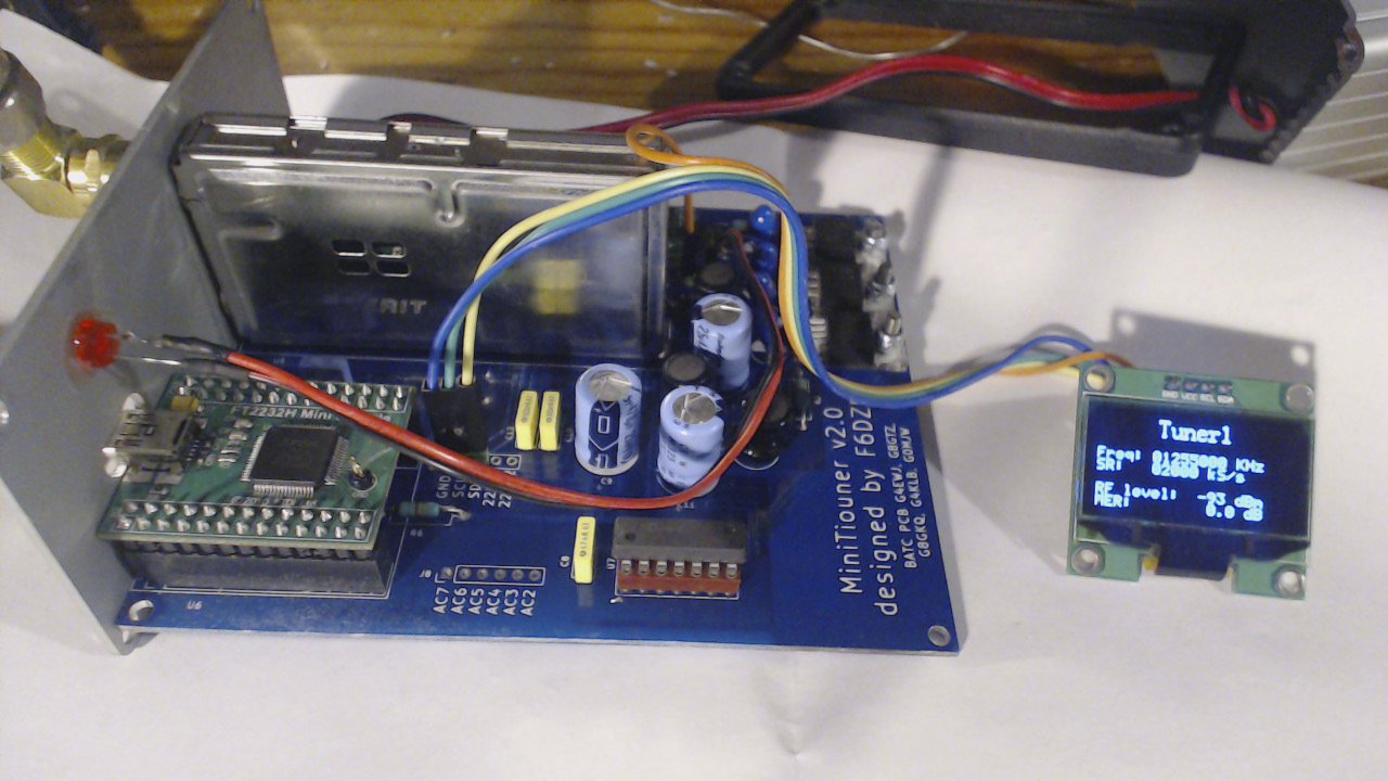

The tuner must be a Serit FTS4334L tuner.
1) Download the software Minitiouner V0.7B
http://www.vivadatv.org/viewtopic.php?f=60&t=450
2) Download the "FT2232H master MinitiounerPro.zip" and unzip it
3) use FTprog to reprogram the FT2232H with the file "FT2232H master MinitiounerPro.xml"
4) Use an OLED 1.3" I2C 128x64
5) Connect the OLED GND to GND, SCL to SCL, SDA to SDA, VCC OLED to the 4V.
6) in the minitioune.ini file, change "OLED=no" to "OLED=yes"
Run Minitiouner V 0.7b
Have fun
73's
Alain F1CJN
Have fun
73's
Alain F1CJN

Excellent.
The signals are mostly on J7. The 4V supply is on J2. I expect you could also use 3.3V for the OLED supply which is available on J5. THere should be more than enough space on the unused panel of the standard box.
Meanwhile - where did I leave those OLEDs?
PS - Turns out mine are TFTs. OLED on order.

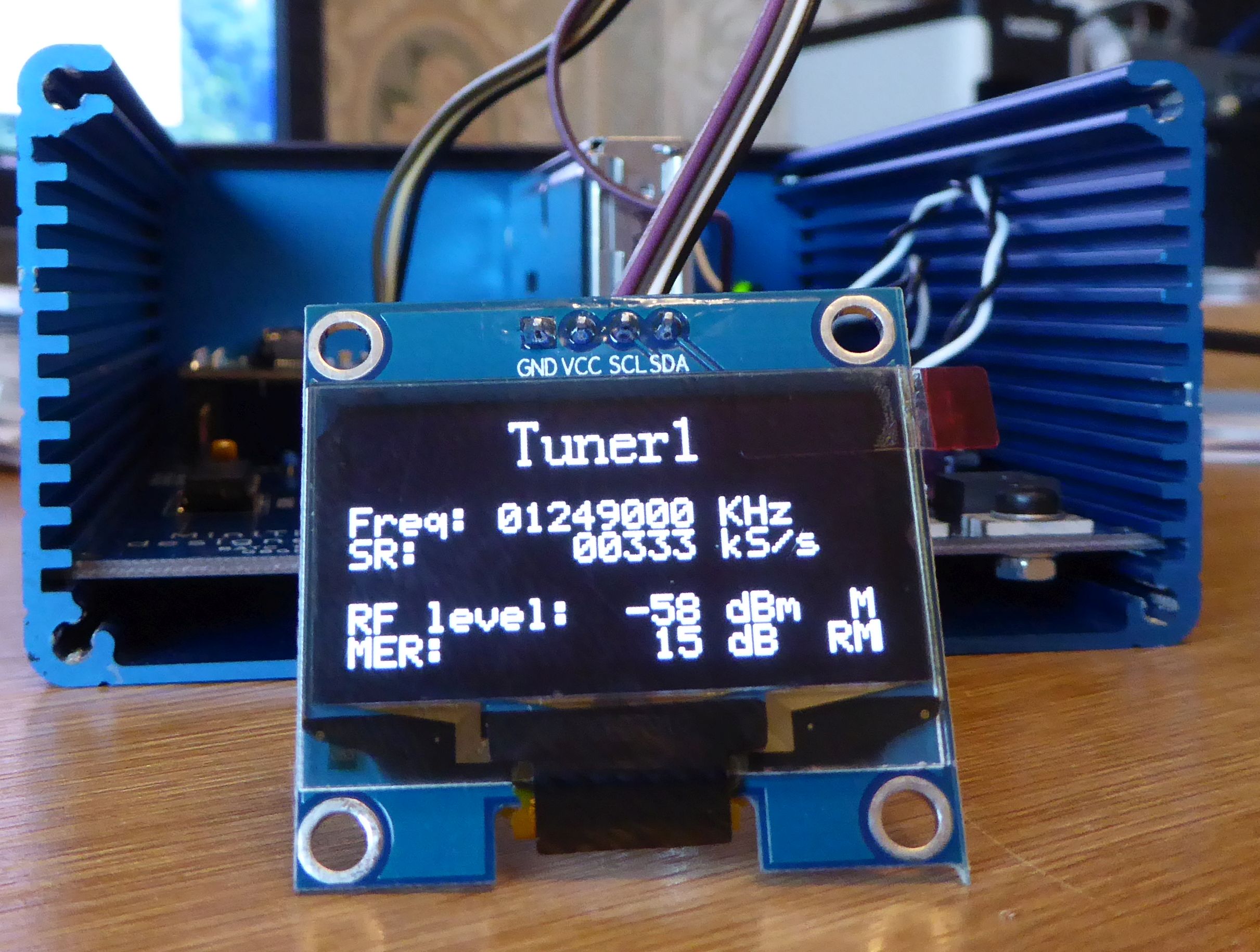

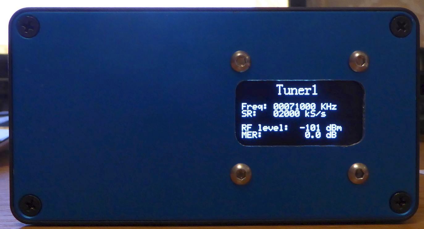

My OLED arrived today. Looks identical but does not work. Any ideas what I am doing wrong here? I followed the instructions as far as I can tell.
PS = it does work. I had not correctly reprogrammed the FTDI module - it being so long since I had done it I was simply re-applying its existing template and not the new one.
Panel
