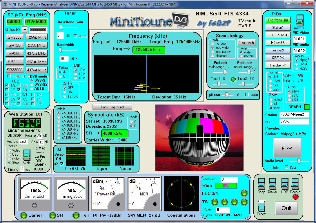

The new version of Minitioune is available for download. http://www.vivadatv.org/viewtopic.php?f=60&t=450
• Works MiniTiouner or MiniTiounerPro ( NIM Eardatek, Sharp/Samsung, FTS-4335, FTS-4334, FTS-4339)
• codecs Mpeg2, H264, H265 for video and MPEG Audio, AAC or AC3 for audio
• You can choose the screen size when you start (tell it in « minitioune.ini »)
• You can click on the video screen to change all the displaying mode including Expert mode.
• RF level computation revisited.
• Low SR can go down to 75 kS/s if you use a FTS-4335 or FTS-4334
• All FEC values used with DVB-S2 are usable.
• .grf files are no more indispensable.
• If you use a MiniTiounerPro : you can set 13v/18v/22kHz and use Oled or LCD_Digole display and led TS2 (master).
(I am thinking of an expansion board for a MiniTiouner V2 PCB that will use these new possibilities.)

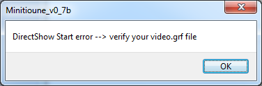

I have tired updating to this latest version of the Minitioune software, however I seem to be getting various errors, now that I have loaded the latest minitioune.ini file I get this
Graph Load Error.png (12.82 KiB) Viewed 11991 times

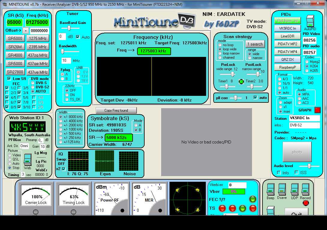

and once minitioune 0.7b opens the graph indicator stays red
Minitioune 7b.png (213.89 KiB) Viewed 11991 times
The error also occurs when I try older versions like 0.4c, 0.5a and 0.6d, however once I click okay and minitioune starts, I do get the video decoded in these older versions.

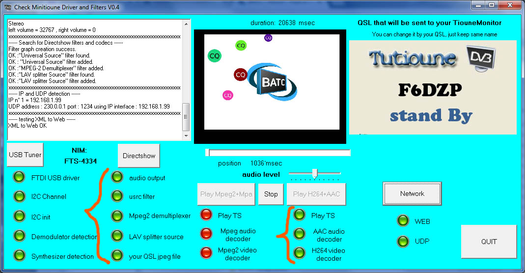

When I try to use the "Check drivers and Filters" program I now get
Minitioune test Error.png (17.33 KiB) Viewed 11991 times

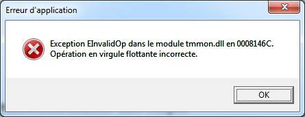

but I am starting to think that is related to Trend Antivirus software that was updated earlier this month.
I see in the latest Zip file that the previous two .grf files are not included, are they now redundant in this 0.7b version.
I believe I have followed the instructions correctly with respect to the usrc.ax installation, I have tried both the Lav filters (the 0.68.1 mentioned in the readme document and also the 0.70.2 version included in your zip file).

The first thing to do is to run with success "CheckMinitiouneDriverAndFilters".
If this software doesn't give you all leds green, you can't use Minitioune without errors.
The leds I indicate are about all the Directshow graph needs.
"tmmon.dll" is not used by all my softwares, this is a file used by your Trend Micro Antivirus .
You must first resolve why CheckMinitiouneDriversAndFilters can't run and after check to see if it gives you all the leds green.

Edit / Update: I decided to start the PC in safe mode, stopped a few services from starting up that didn't seem necessary, rebooted and eventually was able to get CheckMinitiouneDriverAndFilter software to start, I got all green lights as to be expected, and Trend promptly shutsdown the software at the point of playing the video. When I try running 0.7b I still get the "Check video.grf" error message before the main window opens. I can see that minitioune is detecting my signal and locking onto it, but still play back of the video. I did notice that by clicking the info button there was a hint of an error:

Just testing V0.7b and have an observation. Receiving my Portsdown on 437MHz at 333Ks woth V0.7b I'm getting a timing lock indication of 57-63%, with V0.6d I get the same unless I select "Low SR" when I get 100% timing lock. With V0.7b "Low SR" cant be selected below 300Ks so getting 100% is not possible. Am I missing something?

I had noticed the same using my LimeSDR as the DVB-S source, however once I went over to using some professional Tandberg equipment, I got 100% timing lock, so thinking the indication is actually finding an issue with the cheaper / home grown modulation methods.
