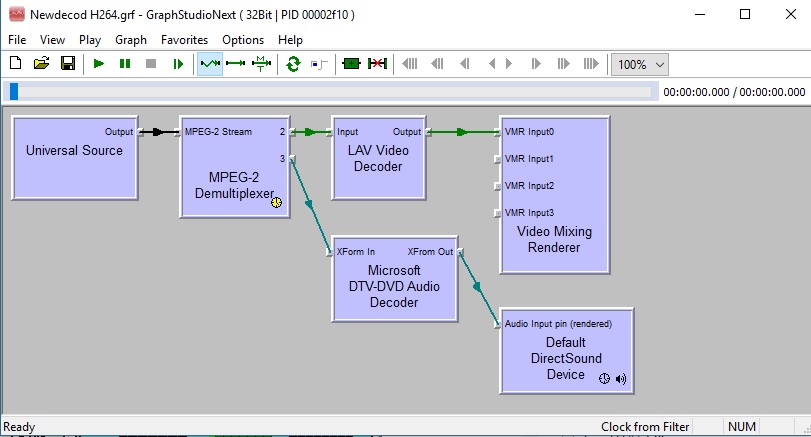

I had edited the newdecod.grf files to use the good LAV filters, but when I went back to check them, found that they had mostly reverted back to my old settings.

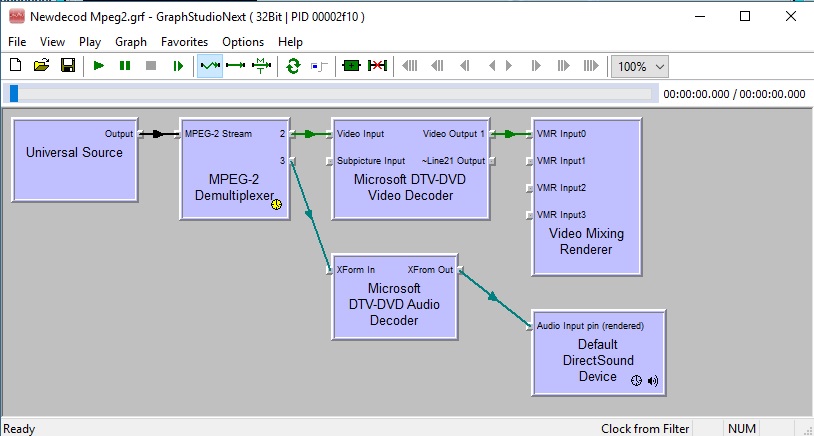

Hi Colin the error I had was with the 64bit version the 32bit works ok but I seem to have the opposite to you
https://www.dropbox.com/s/qgh6relspqy6qp7/H264.png?dl=0
H264 file
https://www.dropbox.com/s/kmfjypxj21ihl ... 2.png?dl=0
MPeg2 file
