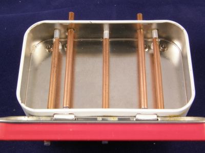

70cm and up inter-digital filters become a manageable option. W1GHZ has some info on filters using Altoids tins. I know several people have had success with these: http://www.w1ghz.org/filter/Altoids_Tin_Filters.pdf

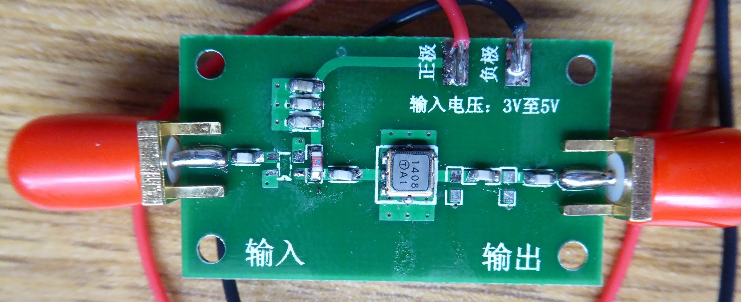

Mine just arrived, 262543494592, not same as picture, only one amp on input no device, said he would resend
The seller here, 131574529568 Pic Attached, he did email and said delay but both came last week, amp on in and out.
Will try a in stock device, also as a straight filter.

John G7JTT bought his unit over today - looks like the picture in Peter's post and has both devices plus the SAW filter fitted

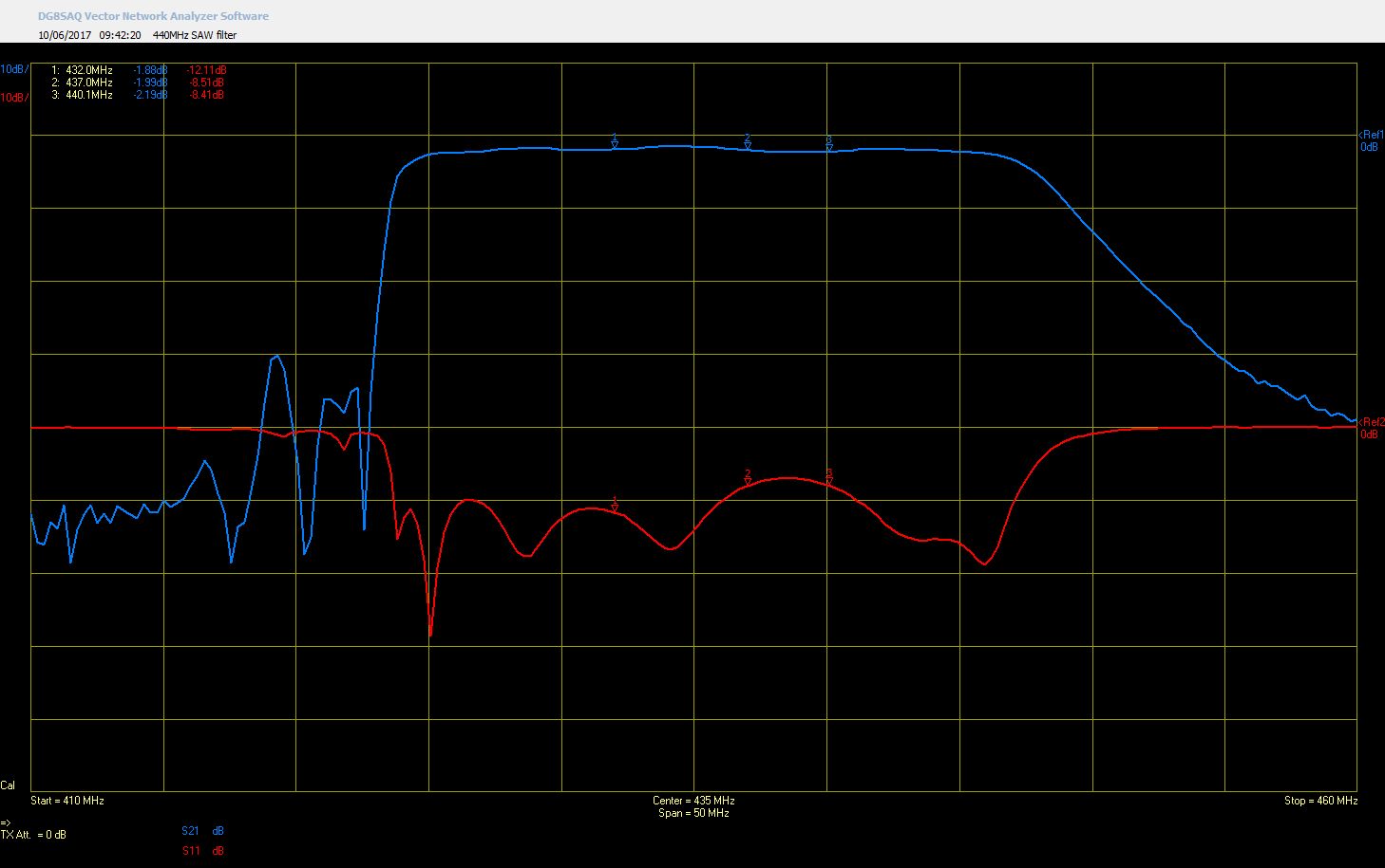

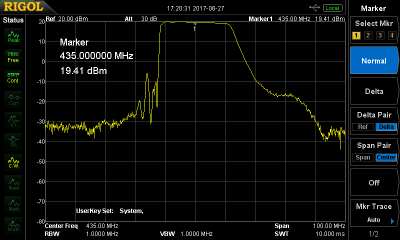

We measured it as having 38 dB gain and sub 1 dB noise figure so reasonable performance but as can be seen below the SAW filter is 20 MHz wide - this is probably too wide to use on 70cms without a tighter (mechanical) filter in line as well.
It could be feasible to remove the SAW and take 50 ohm leads out to an external filter such as http://www.w1ghz.org/filter/Combline_Fi ... nd_UHF.pdf
