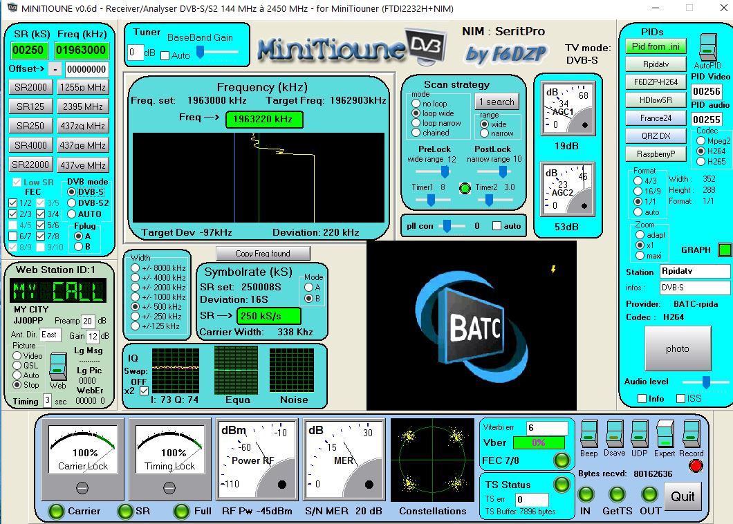

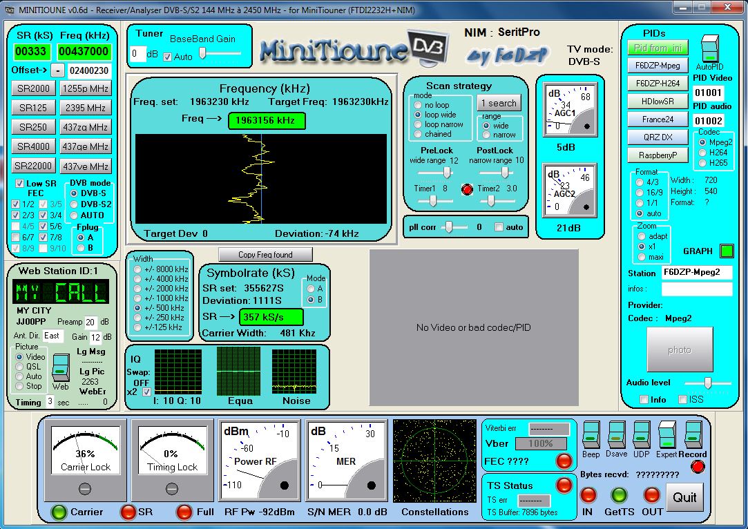

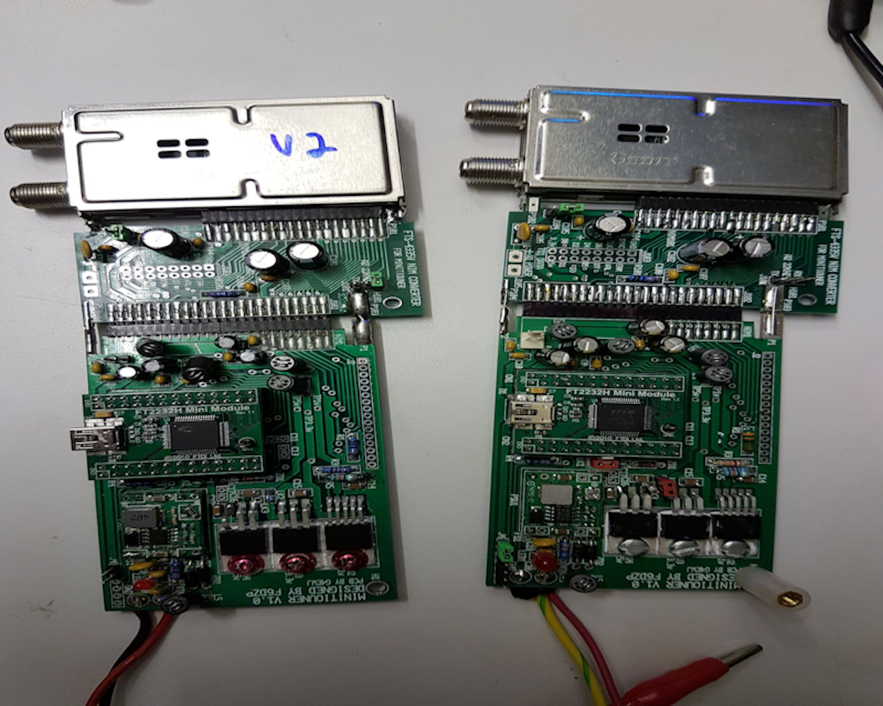

Evening all,
I have been running a few tests on my Minitiouner and Serit Nim (4334). Unfortunately so far not being able to take an ugly picture. I got together with a fellow ham who has 2 Tiouners one with a Sharp Nim and one with a Serit (4335). Both Serit Nims will not take a picture whilst the Sharp locks in after a short delay.
Are there any changes that need to be made to take pictures on the Serit Nims?
Below is a picture of the Tiouners and a snap of the software...
If I had hair I would be pulling it out by now!!!! So any help would be much appreciated.
Regards
G7MEG

if you are using a Serit tuner it will do 437MHz directly. Looking at the software screenshot you have a frequency offset, are you using an SUP 2400 with it?

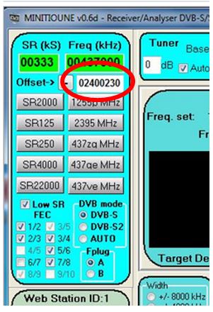

Hi Dave,
The SUP2400 is the 70cms to L band upconverter we used to use to receive 70cms before we got the Serit tuner which covers 437 directly.
The reason why we ask is because your screen shot shows an offset of 2400.230 MHz in the white box - circled in red in picture belwo:
This means you are actually tuned to 2400 - 437 = 1963.
To sort this you can either try pressing the other 437 buttons and see if the offset in the white box goes to 0000000 - then as long as the green box says 00437000 you are tuned to 437 MHz.
Or you can enter 00000000 in the white box and 00437000 in the green box directly.
The offset and frequency tuned are set up in the .ini which can be edited using wordpad.

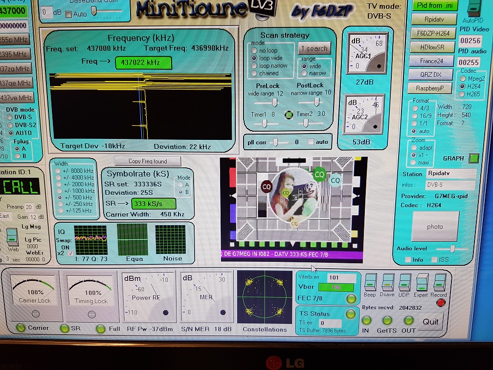

Hi Noel, Malcolm,
success!!!!! it works.
Thanks for all your help. Ill be putting a few more bits together so I'm sure there will be many more questions. I will
try to keep them to a minimum
regards
G7MEG
