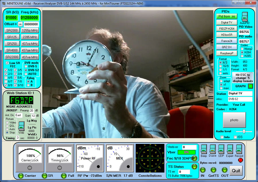

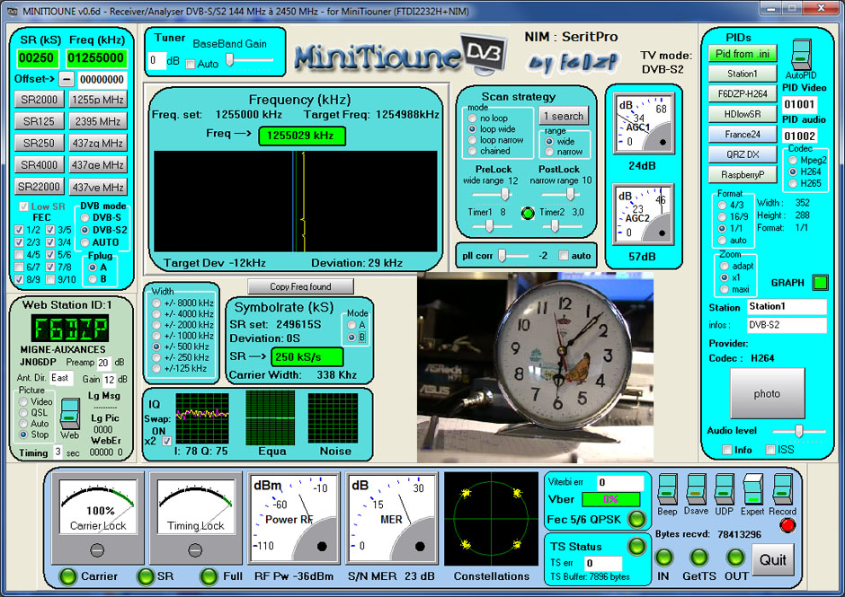

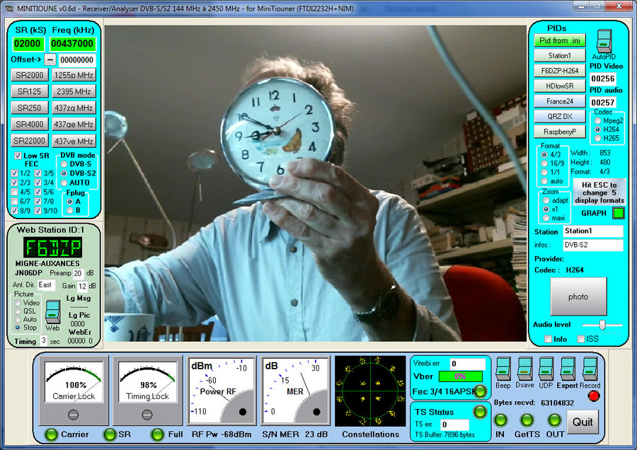

I forgot to say that with this new NIM we can also receive DVB-S2 16APSK and 32 APSK
test made with my DATVexpress as modulator:

The reason the MER is so low is that I have the preamble in DVB-S2 set to the wrong value
in the currently released version of the software.
The reason I have done that is because when I have it set to the correct value my Satlink
receiver won't decode 32 APSK. I have no idea why.
I look forward to upgrading my system and trying out your new software when the BATC
NIM bodge boards are available. :D
