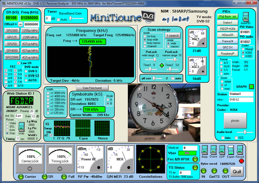

DVB-S2 8PSK SR156_.jpg (212.4 KiB) Viewed 12693 times
using only a SR of 156 kS/s !!!

As Jean Pierre says "More accurate values for MER and power" - it looks like what was 31 dB MER on previous versions is around 26 dB on version 5 - which is probably more realistic....

less optimist....
It is very difficult to find the real value, when many analyzers say nothing above 25dB, when many analyzers don't work under 1MS/s, when analyzers can answer only for themselves, their own hardware that affect the received signal.
Since I had revisited Tutioune1600 for the Low SR version, I have not spend time to actualize the MER values, and keep the same table for Minitioune.
With this version, I have spent many tens of hours to show the most real value. changing the NIm, changing the SR, changing the mode...
We can better now also that the MER goes down when we change from SR2000 to SR250, the fineness of constellation shows itself that the MER goes down, yes I have 31dB at SR2000 and 26dB at SR250
We can see also when it is worth to work in low SR mode or not (the SR between 300 and 6500 can be used in both modes)
