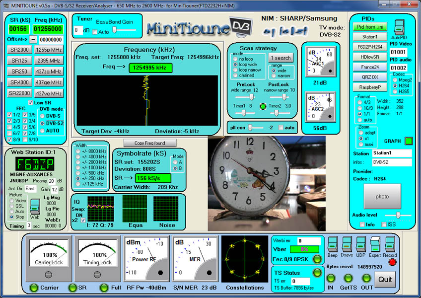

Post by F6DZP » Wed Jan 11, 2017 1:51 pm
I happy to announce that the new version is ready.
http://www.vivadatv.org/viewtopic.php?f=60&t=399
Main improvements over the v0.4c
• We can now receive DVB-S and DVB-S2 en QPSK et 8PSK
• We can decode video codecs : Mpeg2, H264 and H265
• More accurate values for MER and power
• Some little bugs fixed
• Useful for a PIPO,
o A click on vu-meter « MER/SN » changes standard/Expert mode
o A click on vu-meter « RF Pw » switches the AutoPID button
o A click on vu-meter « TimingLock » changes the DVB mode(DVB- S, S2, Auto)
o A click on vu-meter « CarrierLock » asks a new lock (= « 1search »)
o In standard mode, un click on thea video changes the display format ( = Echap)
• There are new FEC values for DVB S2
• We can preset the BBgain value and the lowSR/highSR mode
DVB-S2 8PSK SR156_.jpg (212.4 KiB) Viewed 12680 times
using only a SR of 156 kS/s !!!
Jean-Pierre F6DZP

Post by g8gtz » Wed Jan 18, 2017 5:04 pm
As Jean Pierre says "More accurate values for MER and power" - it looks like what was 31 dB MER on previous versions is around 26 dB on version 5 - which is probably more realistic....

Post by F6DZP » Wed Jan 18, 2017 7:44 pm
less optimist....
It is very difficult to find the real value, when many analyzers say nothing above 25dB, when many analyzers don't work under 1MS/s, when analyzers can answer only for themselves, their own hardware that affect the received signal.
Since I had revisited Tutioune1600 for the Low SR version, I have not spend time to actualize the MER values, and keep the same table for Minitioune.
With this version, I have spent many tens of hours to show the most real value. changing the NIm, changing the SR, changing the mode...
We can better now also that the MER goes down when we change from SR2000 to SR250, the fineness of constellation shows itself that the MER goes down, yes I have 31dB at SR2000 and 26dB at SR250
We can see also when it is worth to work in low SR mode or not (the SR between 300 and 6500 can be used in both modes)
Jean-Pierre F6DZP

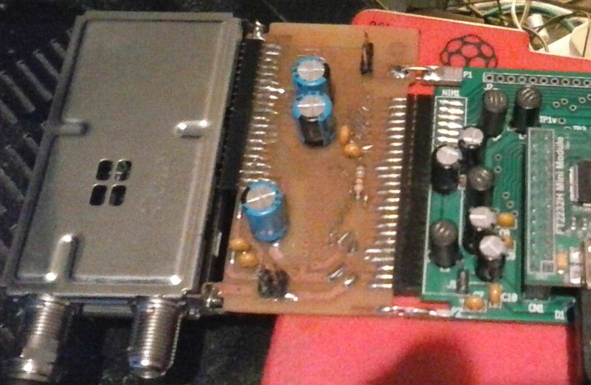

Post by g8gtz » Sat Feb 18, 2017 12:59 pm
Sorry Dave missed your post - as JP says we are out of stock of the Sharp NIM.
However, we do have 100 of the Serit NIMs which cover from 140MHz right through to 2650 MHz without the need for any upconverters!
This makes building a receiver for 146 or 437 much easier, although you will need a pre-amp followed by lots of filtering for each band, just like the Sharp did, and probably followed by a Satellite line amp from ebay as the Serit has less gain than the Sharp.
However, due to different pinouts, they also need a simple adaptor board to enable it to be plugged in to the Minituner standard hardware - Brian G4EWJ has designed one and they are currently being made in China.
Brian is also ordering the components (no surface mount) to make up kits and once the boards arrive - end of next week? - these and the tuners will be on sale in the shop.
