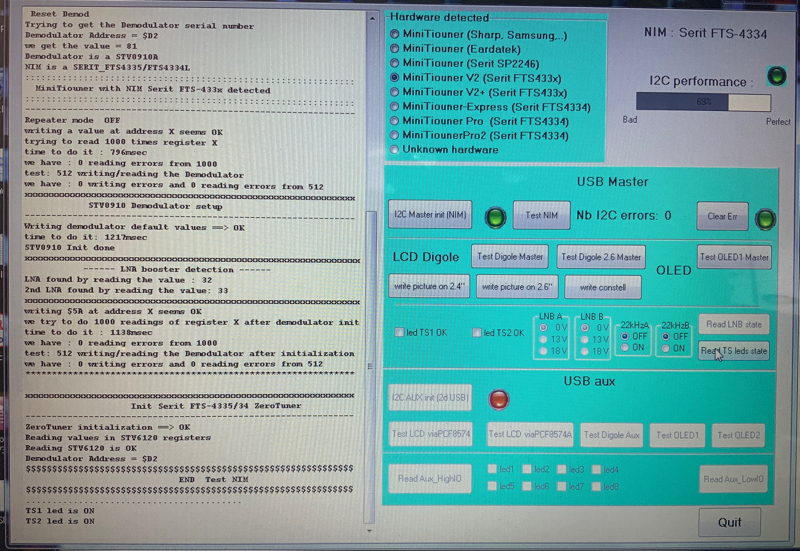

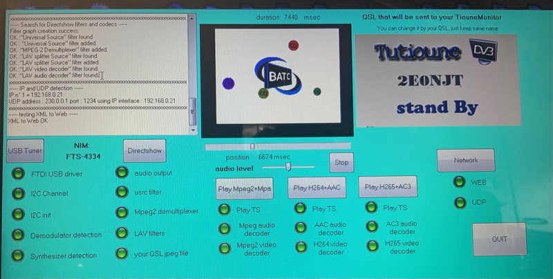

Mike, some more images of tuner tests and a zip file on the data stream.
This is the wording on the minitiouner pic previous post
PNG image8.png (123.51 KiB) Viewed 7299 times
Test software images if it helps.
PNG image6.png (957.41 KiB) Viewed 7299 times
PNG image7.png (660.85 KiB) Viewed 7299 times
Cant seem to upload a zip file so this is the recorded data..

Really needs the zip file, only a little bit of it. Not sure what that is you have posted - it should be called something like XXXXXXXXXXXX.TS.
If you look at it in a hex editor it should look like this with a stream of numbers in hex representing the data nulls etc. If some of the bits are not present....
07 10 20 15 e4 fb ff 0e 34 46 0e c9 28 fd b5 ca 2a 8e ca 1c d5 37 b3 11 1d 1e 7a 58 ec fe f8 03 10 1e a4 3d de e9 da 02 be c4 b0 0d 17 04 b2 7f f1 6f fd 9c e5 0a 02 16 d5 7d 28 25 3d 90 36 b4 07 ab ad ab 80 66 31 77 f0 ae 9d 75 2b 23 dd a9 25 ec fb 7e b8 7d 60 2e 81 30 54 9e 27 e0 e2 b1 9c 45 1b 1b fa d8 a2 eb 2b 50 87 8b 6f 02 20 fa f7 14 62 43 d7 f0 af 8a 6a 94 e0 34 ac 42 19 81 ca 62 50 10 5c 7d 97 4f 95 cd f6 7c 14 22 4b 45 e3 16 fb 10 73 e6 7b a7 42 7e eb 2e 3d 80 4a a8 bf d4 41 51 fd 95 eb b1 e2 e7 fd bc 13 d3 30 a1 5a aa f4 7d 02 88 ae f4 47 1f ff 10 ff ff ff ff ff ff ff ff ff ff ff ff ff ff ff ff ff ff ff ff ff ff ff ff ff ff ff ff ff ff ff ff ff ff ff ff ff ff ff ff ff ff ff ff ff ff ff ff ff ff ff ff ff ff ff ff ff ff ff ff ff ff ff ff ff ff ff ff ff ff ff ff ff ff ff ff ff ff ff ff ff ff ff ff ff ff ff ff ff ff ff ff ff ff ff ff ff ff ff ff ff ff ff ff ff ff ff ff ff ff ff ff ff ff ff ff ff ff ff ff ff ff ff ff ff ff ff ff ff ff ff ff ff ff ff ff ff ff ff ff ff ff ff ff ff ff ff ff ff ff ff ff ff ff ff ff ff ff ff ff ff ff ff ff ff ff ff ff ff ff ff ff ff ff ff ff ff ff ff ff ff ff ff ff
or in a binary editor
11111111 11111111 11111111 11111111 01000111 01000001 00000000 00011100 00000000 00000000 00000001 11100000 00000000 00000000 10000000 10000000 00000101 00100001 00000010 10101111 10010000 10000001 00000000 00000000 00000000 00000001 01000110 00000001 01010000 00000000 00000000 00000000 00000001 01001110 00000001 00000001 00000011 00000000 00110000 00000010 10000000 00000000 00000000 00000000 00000001 00000010 00000001 11010001 10001111 00100110 11000000 11111001 00110100 00010100 01000000 00000000 00000000 00000011 00000000 00000000 00000011 00000000 00001000 01101110 00001101 11000000 00000000 11110011 01000011 00011100 11010011 00000001 01011001 00011011 01101111 01110010 01101011 11010000 01100100 11011111 00100000 00111000 11001000 00000000 10010011 10111010 00000001 10010100 00001010 01001000 11001000 00100111 00111100 11110100 01110010 00000110 00010010 01100001 10110001 11101011 01000110 11000111 00000011 11110110 10110101 00001101 01001001 00000000 00010110 10000010 01110110 00101110 11001110 10100111 11010101 11010011 11110100 10100000 11000001 11011000 10001000 01110011 10010001 01101011 10110111 10000000 11110101 00011001 10110100 10010100 00011001 11111011 01000111 10011001 10101010 01101000 11010110 10101010 10000101 01111100 10001011 00011101 00101010 11001110 01001010 11101110 01011000 01100010 10111100 01000000 11001001 10010000 01001000 01110011 01101000 01001101 10000010 00111010 01001100 00010001 10011011 11000011 01001111 10001000 11011110 01101000 00011110 00011110 11000000 01000001 11001110 00000101 11111000 10100110 00110111 10010111 10001101 00011001 11011100 01100110 11110111 00001111 10000001 01100001 11111111 00100110 00011000 00000100 11110101 11001011 01000100 11000100 01000111 00000001 00000000 00111101 10011010 00000000 11111111 11111111 11111111 11111111 11111111 11111111 11111111 11111111 11111111 11111111 11111111 11111111 11111111 11111111 11111111 11111111 11111111 11111111 11111111 11111111 11111111 11111111 11111111 11111111 11111111 11111111 11111111 11111111 11111111 11111111 11111111 11111111 11111111 11111111 11111111 11111111 11111111 11111111 11111111 11111111 11111111 11111111 11111111 11111111 11111111 11111111 11111111 11111111 11111111 11111111 11111111 11111111 11111111 11111111 11111111 11111111 11111111 11111111 11111111 11111111 11111111 11111111 11111111 11111111 11111111 11111111 11111111 11111111 11111111 11111111 11111111 11111111 11111111 11111111 11111111 11111111 11111111 11111111 11111111 11111111 11111111 11111111 11111111 11111111 11111111 11111111 11111111 11111111 11111111 11111111 11111111 11111111 11111111 11111111 11111111 11111111 11111111 11111111 11111111 11111111 11111111 11111111 11111111 11111111 11111111 11111111 11111111 11111111 11111111 11111111 11111111 11111111 11111111 11111111 11111111 11111111 11111111 11111111 11111111 11111111 11111111 11111111 11111111 11111111 11111111 11111111 11111111 11111111 11111111 11111111 11111111 11111111 11111111 11111111 11111111 11111111 11111111 11111111 11111111 11111111 11111111 11111111 11111111 11111111 11111111 11111111 11111111 11111111 11111111 11111111 11111111 11111111 11111111
This is the way to tell if all the bits are working properly. Note you have to use the record switch to record the TS.
Re: External LNB power with the MiniTiouner question please?
Post by G8GKQ » Sun Jul 18, 2021 11:57 am
Nigel - If the .TS file exists, it will be in the same folder as your MiniTioune software. We only need a 15 second recording of the beacon. You could then .zip it and e-mail it to me.
I suspect a hardware fault with your MiniTiouner as the problem is common to both MiniTioune and Portsdown.

i have had the tuner and the usb headers out of the pcb and checked all the data lines for open/short circuits and all was good after reassembly things have changed a little bit ive managed to save a TS file from scan and tioun so here it is..

That file looks OK - but I am not so sure it is a valid TS. All the bits are changing but there isn't enough to see if there is any video in there. VLC thinks there is some audio, which is encouraging.
Did you check the 74CH10 ?
