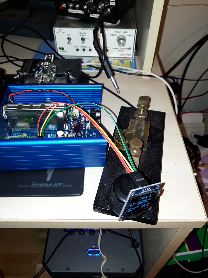

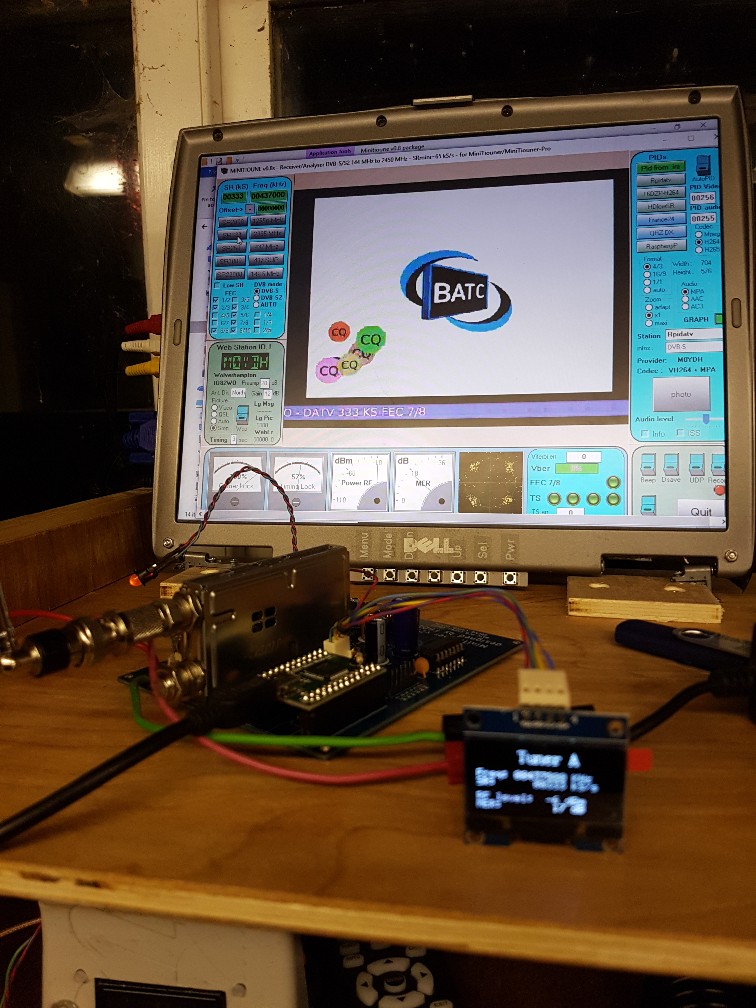

Posts: 269
Re: OLED Display for Minitiouner V2 with FTS4334L
Post by M0YDH » Sun Sep 30, 2018 6:49 pm
Thank you / Merci beaucoup toute le monde!
V2 Minitiouner was an easy build
and reading these forum notes together with 0.8 software means the screen worked straightaway.
There's just boxing it up to do - hopefully with some radiogareth printed closure plates.
David M0YDH
m0pnn
Posts: 22
Joined: Wed Oct 03, 2018 1:16 pm
Post by m0pnn » Wed Oct 03, 2018 1:40 pm
Hi
David
Just finished mine must get you to send me some pictures to test it. Made a few mistakes drilling but epoxy putty is great at filling holes.
Paul
