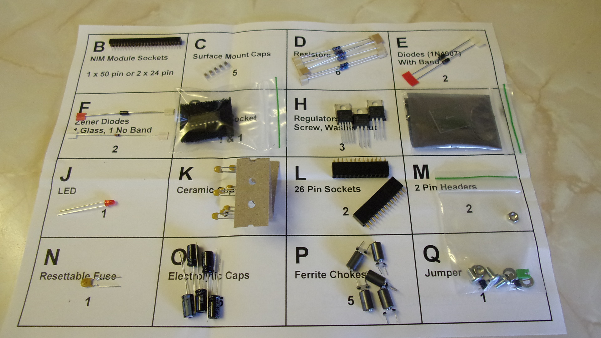

The next batch of kits should be available in a few days.
Individually bagging all the components has proved to be very time consuming, so this batch has almost all the components in one bag. There is a sheet included in the kit to do an inventory before starting.
