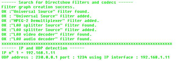

When I run the check utility this is what I see.
Have you compared your two computers?
Steve

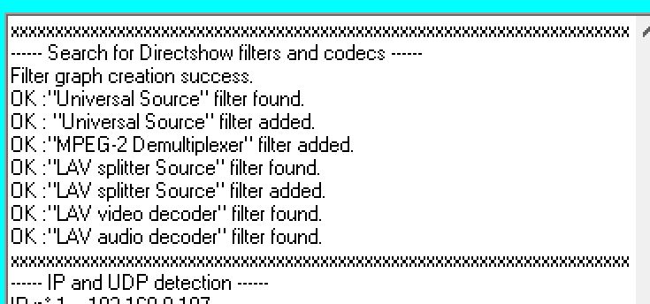

Good idea! I compared them!
This is the old (working) PC:

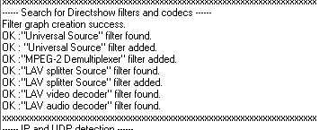

And this is the new (non-working) PC:
Not Working.JPG (25.76 KiB) Viewed 9740 times
As you can see , they are identical. I have also unplugged the network, disabled the Wifi, disabled the BitDefender Anti-Virus and all Windows security measures. I suppose the only thing I can now realistically do is to trash my hard drive and re-install all my applications etc. from scratch starting with Minitioune ... or give up, sell my Minitiouner and other DATV kit and forget the whole thing ....
