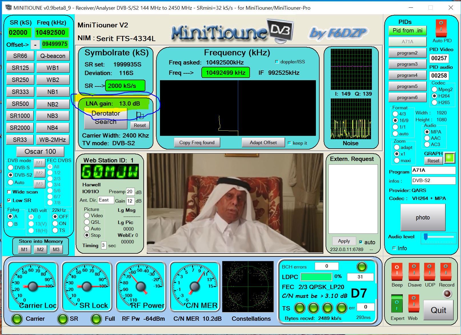

Post by g0mjw » Thu Sep 05, 2019 7:30 am
Like this. You don't adjust it, you set your IF gain appropriately with amplifiers or attenuators if necessary.

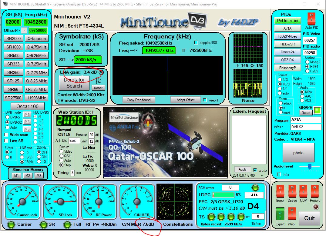

So mike although im trying to get as much signal as possible there is such a thing as to much signal so i have to att the signal... im assuming since i have changed my lnb from a old dro type to a pll one im now getting to much signal..

Yes. As long as you are not powering the LNB through the minitioune you can just attenuate the IF. In my case there is a 1:4 splitter so I can attach multiple receivers.
However, the signals from an LNB are not usually that strong, especially after a few metres of satellite TV quality coax. There may be another reason for this. What exactly is the setup?

Post by sean2e0saf » Thu Sep 05, 2019 9:56 am
The set up is a 1.5mtr prime focus dish with approx 20mtrs of cable tv virginmedia quality coax maximum. And of course the minitiouner rx.
Lnb is a octogon one i forget the model.

Post by g0mjw » Thu Sep 05, 2019 10:40 am
You should not be seeing overload then. That's the same as me except my dish is bigger. I do have the splitter though. I would try attenuation and see. The lower LNA gain might not make much difference. If the MER is OK it's probably fine. You should see 9-10 dB on the beacon.

Post by sean2e0saf » Thu Sep 05, 2019 11:26 am
About mer 8.1 ish at the moment but i have not finished with lnb i have not fitted the patch antenna for 2.4ghz yet. Im just waiting for a new lnb clamp to come i ordered from satellite superstore
I may need to extend the lnb arms as my initial measurements make the focal point to close to the dish

sean2e0saf wrote:
Thu Sep 05, 2019 12:45 am
F6DZP wrote:
Wed Mar 06, 2019 6:54 pm
No, it is not a problem if you observe the LNA gain. The best is to have 13dB gain.
This LNA has an AGC so if the signal is too much high, its gain goes down and at the end it acts as an attenuator.
If you see that your LNA gain is less than 3dB or negative (=attenuator), you know that your input signal is too high.
So, Just to observe the LNA gain to know what could be bad on this side.
(Near the LNA gain, I have added an emoticon :( in the version 0.9 to give more advertising about the Input signal when it is too high)
This LNA chip is used by ST Micro in their Professional Demo PCB.
Jean-Pierre F6DZP
jean-pierre
how do i change the lna gain.. i see 0.9db at the moment sad face
I too have the Sad Face, my dish is a 1.2m CM with an Octagon Green Quad, my MER is usually 8-8.1 but at the moment my LNB is not in the right place as I changed to an adjustable bracket and not tightened it up so it moves in the wind :lol:
