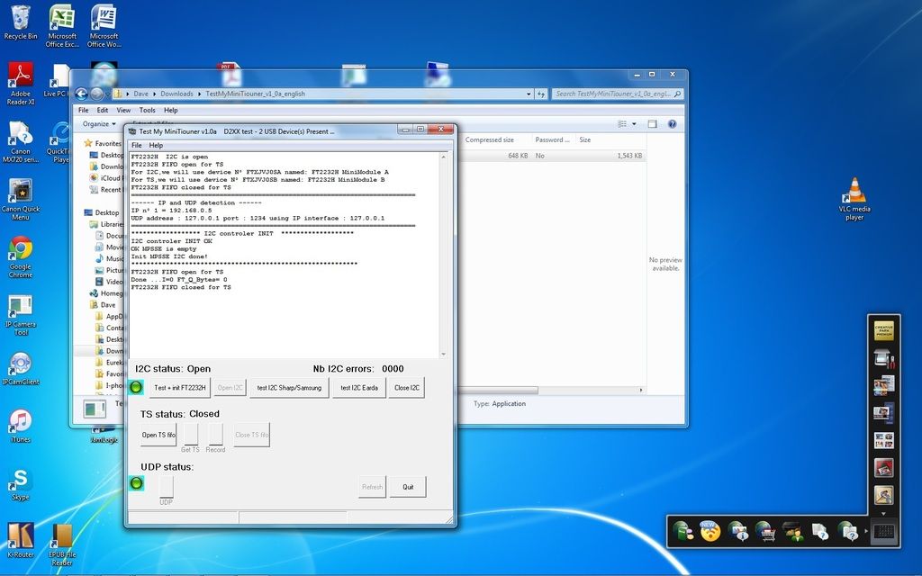

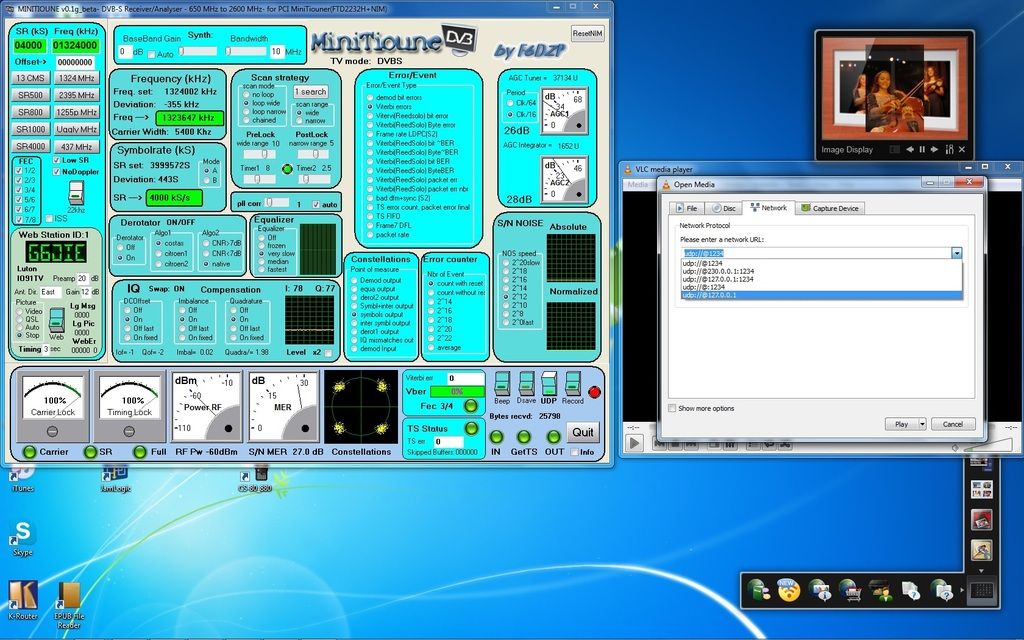

Re: MiniTiouner Kit MTK1 Instructions.
Thanks to all for their hard work on getting this kit together for members. Having built mine I'm having some problems getting a video stream on VLC.
I've tried every option for selecting the video stream but still no joy.
I've done a couple of screen dumps and wondered if anyone can throw any light on the issue.
All help appreciated.
73 Dave
73 Dave
You seem to have bytes received bottom right. Does that continue to increase? It is possible to have 8 green lights and still have a problem with connections on the pcb with the parallel bus to the FT2232H. I was helping a local over the phone and he was getting 8 greens - but the 74HC10 wasn't fitted.
ISS should be unticked, but I don't think that's a problem.
Can you click the Record button and check that a file appears in the MiniTioune folder. Try to play that with VLC. Post it on here and we can have a look at it.
I can't see anything untoward. Which Windows is that? It could possibly be a firewall problem.
After selecting the network stream in VLC, does the play button at the bottom left of VLC change to a pause button? If not, VLC is not receiving anything.
Ignore my comment about the ISS button. I can see that it is not ticked.
