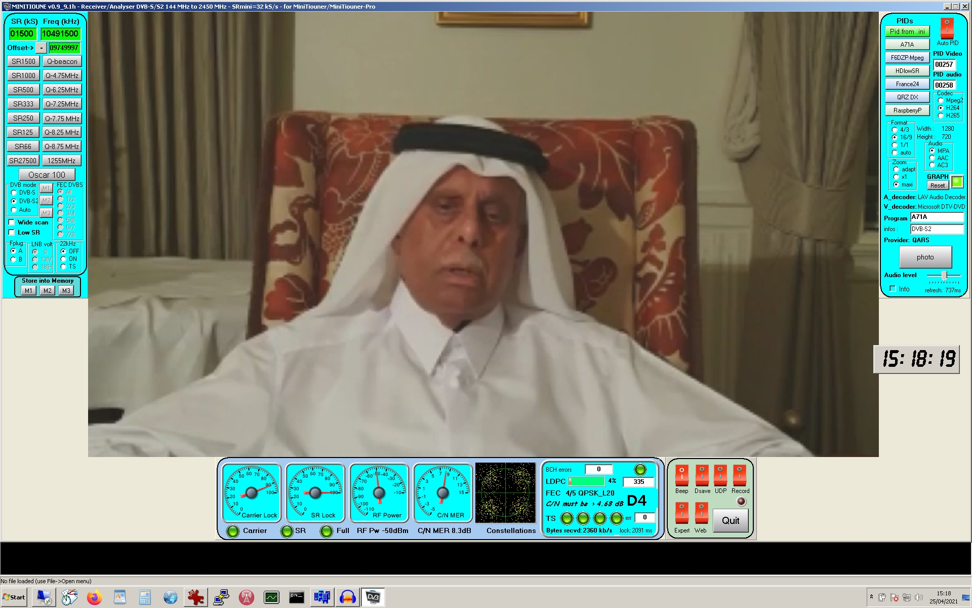

That screen capture shows the LNA Gain is low (with the sad face, at the top of the screen to the left of the Minitioune logo). This is automatically adjusted by the tuner. A normal value is more like that on Colin's screen at around 10dB.
From memory JP added that sad face to indicate that the signal from the LNB was too high and the tuner might be overloaded. In practice it doesn't normally seem to be a problem but it might be worth adding an attenuator between your bias T and the Tuner to see if that improves things.

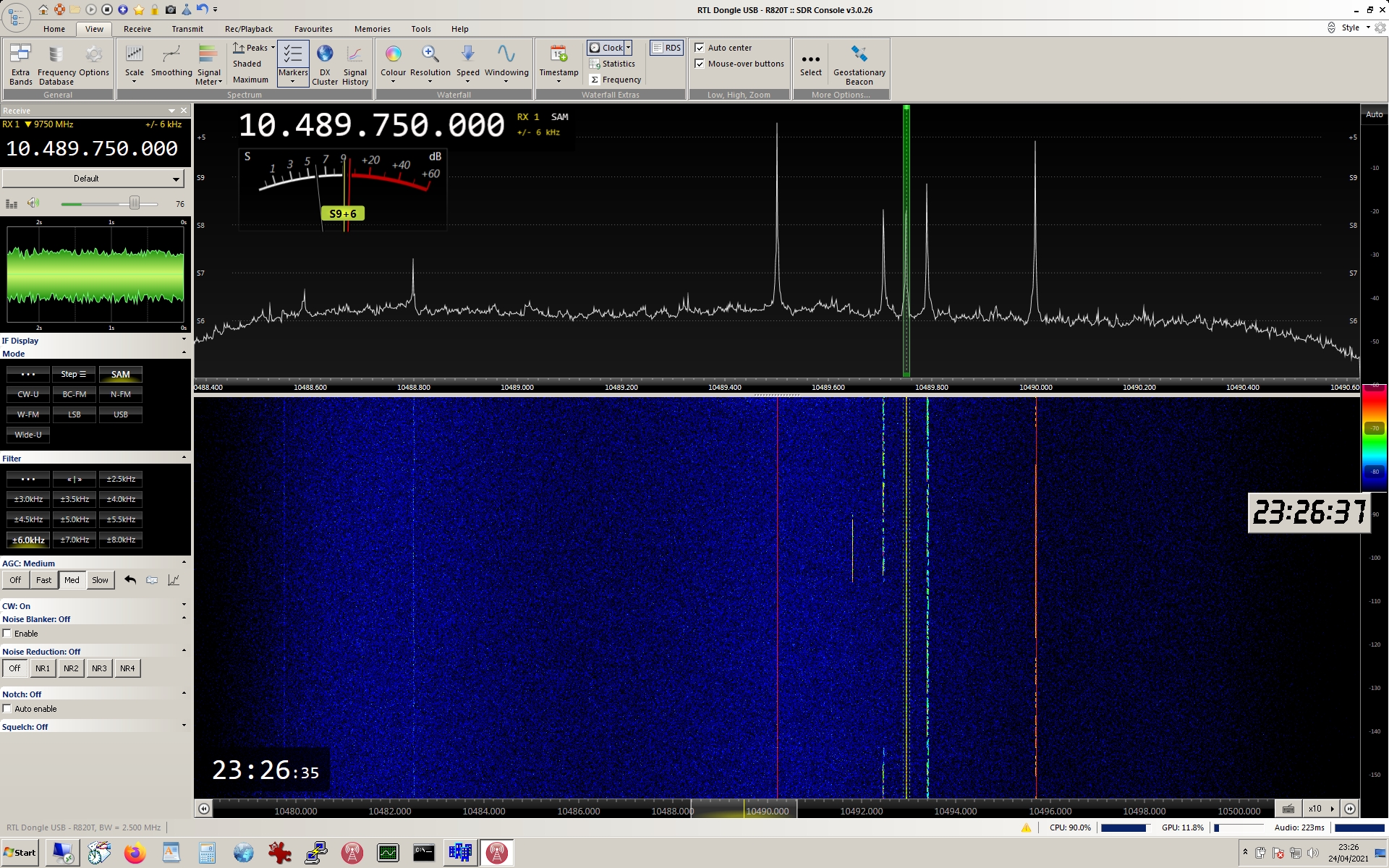

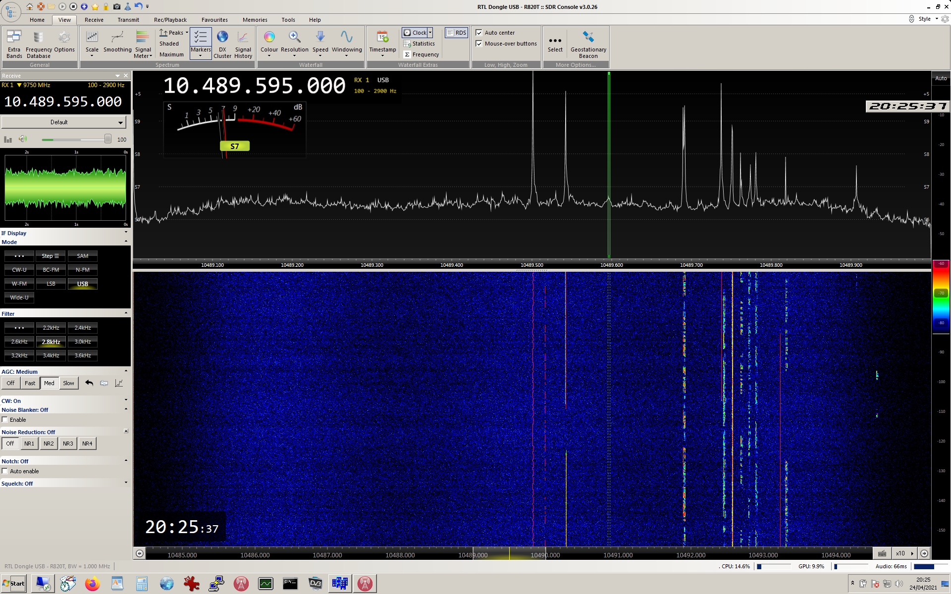

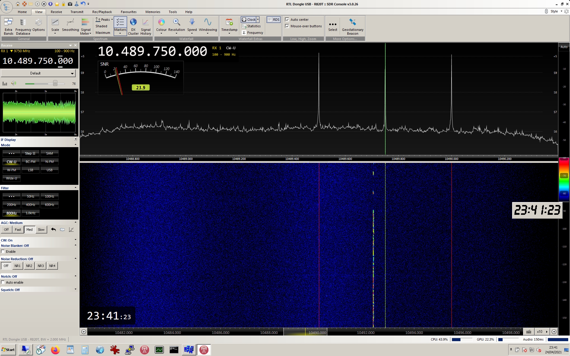

Hi Mike, thanks for sticking with me, I am afraid i am getting a bit out of my comfort zone and probably am about to attach screen shots which are of little to no use. But what I am thinking is the dish / LNB are not grabbing any DATV signals at all, or they are so weak as to be useless. Before I start moving the mount settings about I will attach these screen shots in case they can confirm or deny my thoughts. I am using an RTL dongle that hears SSB stuff seemingly fine and what Goonhilly sees and hears, I seem to as well. But maybe the big dish is masking poor alignment? SSB via the dongle, 10.915GHz via dongle, 10.48975GHz via dongle and SNR level on SSB on the dongle. Any help? Thanks a lot again Mike.

Good afternoon Colin, thanks for the reply. I am finding the signal level is giving LNA gain issues if I connect to the LNB WITHOUT an LTE in line filter. With the filter there's no issue and it shows about 13dB gain. With my Pluto I have to use the filter or I see hundreds of lines of spurious signals on the waterfall, equi-spaced. The RTL dongle has no issues with or without the filter, I assume because the band width of its front end is not as wide as that of the Pluto?
I have tried between 10 and 30dB attenuation but I still see no locking, and as in my reply to Mike just now, am suspecting the LNB is not actually furnishing the MiniTioune software with a usable signal.
That does look like there is limited SNR. Can you zoom in on the vertical scale a bit? I can't quite read the numbers but would expect at least 8 dB of lift on the transponder. That would explain why you are not seeing the beacon. The problem is the SNR on SSB signals is the made up of the ratio of signal power to the (band nose + transponder noise). In your case transponder noise looks only slightly larger than band noise. It will only drop your SNR by less than 3 dB compared with no band noise at all. The situation with the wideband transponder is different. It has a much lower noise floor so dish misalignment makes a larger difference.
