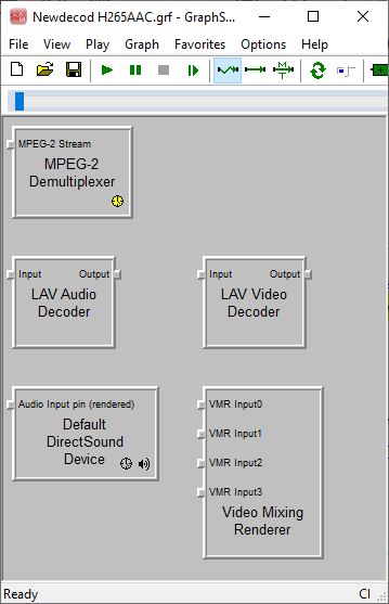

Thanks for your help. I have e-mailed you a .TS file, and here is the output of GraphStudioNext. I take it that means that I am using the LAV Video Decoder.

Thank you Dave. Yes, Windows is obliged to use the LAV video decoder, the Microsoft video decoder can't decode this H265 stream.
I have analyzed your TS and yes it is 1280x720.
In this case the LAV video decoder says 1280x960 if the de-multiplexer doesn't give it the information.
Microsoft demultiplexer is very basic, cannot find any information and I must tell it myself that this ES (Elementary Stream) is H264 or H265, that this ES is AAC ... ( others demux can find the codec used and the size of picture, but they are not free)
Normally, the size of the picture is found by the Mpeg2/h264/H265 decoder and given to the video renderer, so I can display the size found by the decoder.
But in this case( this H265 encoded ES), the size found by LAVvideo decoder is not always the good one. ( good for 1920x1080, not good for 1280x720)
If I want to fix this, I must analyze myself the H265 packets inside the ES and tell the result to the LAVdecoder, or find another H265 decoder that will do well the job or wait for a new version of LAV video decoder.... or ??
It is easier to let VLC do the work... nothing to do for the developer.

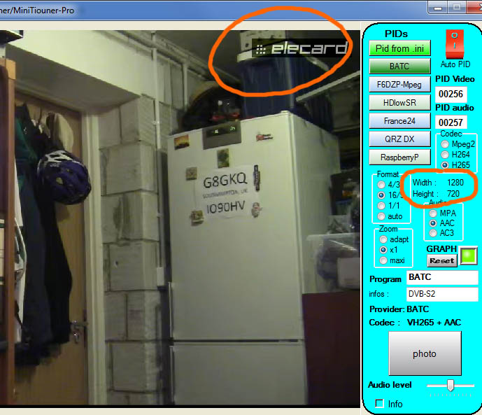

I have made test again, receiving Dave H265_TS with Minitioune using Elecard_HEVC_video_decoder Directshow filter(Demo), Minitioune says that the video size is 1280x720. So I know now that it is LAV_video_decoder that makes a mistake.
but
* LAV_video_decoder is free.
* Elecard_HEVC_video_decoder is not free...
Perhaps next version of LAV_video_decoder will fix this size error.
but

What concerned me about that video was the HP437 meter on top of a box on top of the fridge.
Do you think it is possible to overcome this lav decoder problem?
Re: Minitioune V0.9beta8 is available
Mike - You are right to be concerned about the HP437 at the top of the pile of boxes on the fridge (in Jean-Pierre's circle)- it has fallen off once! All OK though, and it is only used for its 0dBm calibration output as I do not have any power heads for it.
Jean-Pierre - Thanks for the further tests and information. Is there a formal way of reporting the bug in the LAV Decoder?
